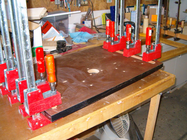

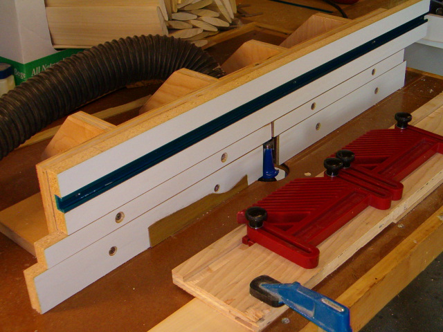

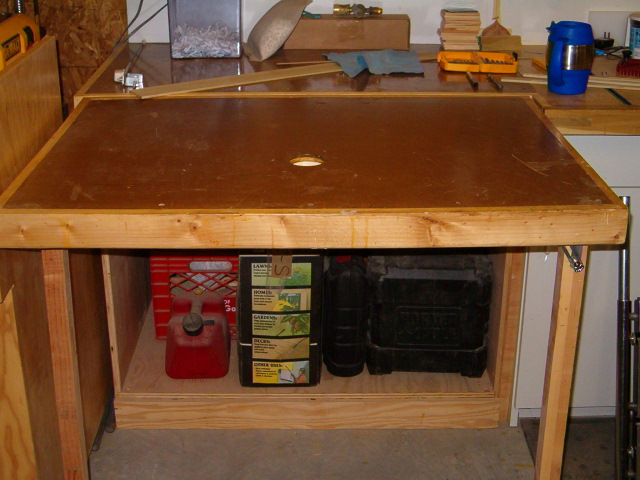

Hi Tim! I used 1/4" hardboard for the surface. Screwed it to the base with #6 FHWS, slightly recessed. NO GLUE! Urethane finish - 4 coats - then wax. The top is replaceable if it gets too messed up. Since I also use the router table surface for chiseling and glue-ups - this feature will unsubtly come in handy. So far after a couple of years of multiple uses there are some nicks, digs and re-urethane spots, in the corners, but the center surface is still good for routing. The table is about 3 feet by 2 1/2 ft.
After I bought the hardboard I set it on the base and fit the side boards to fit the extra height.

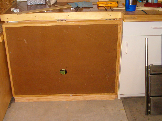

I used plywood rather than MDF for a base and had to rout out a space on the bottom of the table to accept the router. The router base stays mounted to the table and the motor comes out the bottom for use in the OPR, or the plunge base.
The photos show the table and some of it's uses.
P.S. don't be concerned about the appearance of a blockage just to the left of the router table. That is a rolling cabinet/stand with the planer and scroll saw on it. If needed, I can rout a long piece right out of the door. (three feet to the door)

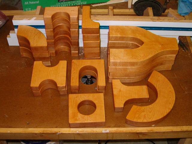

Pat - I had just meant the pic to show how the table is used for storage. However, those are the play blocks I made for my Daughter-in-law's school kids. Wanta see what they do with them? It tickled me!
- Kids Using blocks.jpg (100.25 KiB) Viewed 13680 times
Wow, Cool. Blocks are always great. I remember, a very long time ago, I would spend hours building things with blocks. It's nice to see, that even in this day and age, they are still enjoyed.
