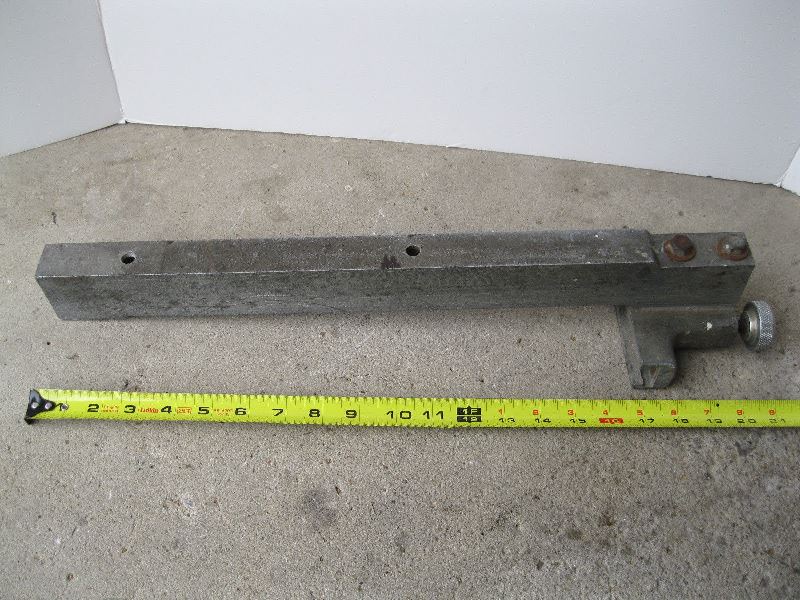

I believe the 10E did not come with the extension table at least the very first ones,. You only got the bracket and it was up to the user to make the table out of wood.skou wrote:We agree. ESPECIALLY, on that slanted rip fence screw!
On a side note, my brother got a Model 10, that had been
completely updated. The 10 E tailstock was almost complete,
only missing the "extension table, but had the bracket. I took
a piece of scrap 1X4, attached it to the ext table bracket, and
drilled a bunch of holes into it, to hold lathe chisels. Mounted
the (now) headstock to the left end, so the lathe chisels were
right at hand. (Since it was a Model 10, I couldn't put a sanding
disc and table, for sharpening lathe tools, so I put the tools there.)
steve

Yep. Just like the 'base'.(2-2x6)jsburger wrote:I believe the 10E did not come with the extension table at least the very first ones,. You only got the bracket and it was up to the user to make the table out of wood.skou wrote:We agree. ESPECIALLY, on that slanted rip fence screw!
steve
Maybe not. I just looked in my 10E 'Owner's Guide' and it mentions the plywood extension table.

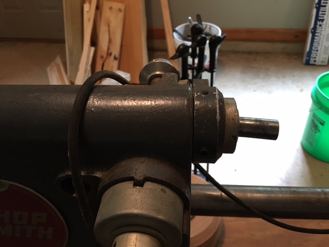

Could use your help in identifying the part I need to solve the problem of a bent shaft (spindle?) on the headstock on our SS Model 10e. I took a picture of the headstock so you can see the bent shaft. This SS was my father in laws and I would like to surprise my husband and figure out how to correct his. The equipment was bent by our movers, there was a bowl attached to the shaft that my husband was working on when we moved and that must have been given a lot of force to bend rhe shaft. Thanks in advance for your help.
- Not sure if this part runs all the way through headstock or is attaché within headstock
- image.jpeg (84.4 KiB) Viewed 11341 times
- rjent
- Posts: 2121
Re: 10E Restoration
This http://www.ebay.com/itm/Rebuilt-QUILL-A ... Swvg9XeFgj is probably your best bet. Slip out the old and slip in the new.Retire1973 wrote:Could use your help in identifying the part I need to solve the problem of a bent shaft (spindle?) on the headstock on our SS Model 10e. I took a picture of the headstock so you can see the bent shaft. This SS was my father in laws and I would like to surprise my husband and figure out how to correct his. The equipment was bent by our movers, there was a bowl attached to the shaft that my husband was working on when we moved and that must have been given a lot of force to bend rhe shaft. Thanks in advance for your help.

Re: 10E Restoration
And a reliable source to boot!rjent wrote:This http://www.ebay.com/itm/Rebuilt-QUILL-A ... Swvg9XeFgj is probably your best bet. Slip out the old and slip in the new.Retire1973 wrote:Could use your help in identifying the part I need to solve the problem of a bent shaft (spindle?) on the headstock on our SS Model 10e. I took a picture of the headstock so you can see the bent shaft. This SS was my father in laws and I would like to surprise my husband and figure out how to correct his. The equipment was bent by our movers, there was a bowl attached to the shaft that my husband was working on when we moved and that must have been given a lot of force to bend rhe shaft. Thanks in advance for your help.

Re: 10E Restoration
:)Thank you so very much!
Re: 10E Restoration
Retire1973 wrote::)Thank you so very much!
I see it sold. Hope you got it!!!!

Re: 10E Restoration
Yes, it should arrive in a week!
