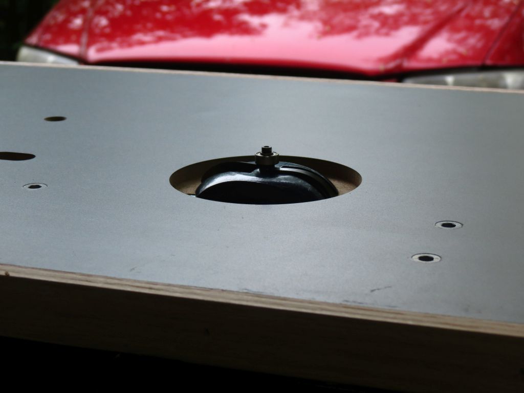

Depending on which table insert you have you will find they have different size openings. The larger one measures 2-5/8" and would work for a bit in the 2-1/2" range. This would be good enough for a 1" radius bit, no more.
The width of the table insert is indeed 3" so that would be a limit of sorts but even if you make your own insert I don't see being able to use a bit with a diameter of more then 2-3/4" which is pretty much back to 1" radius bit.

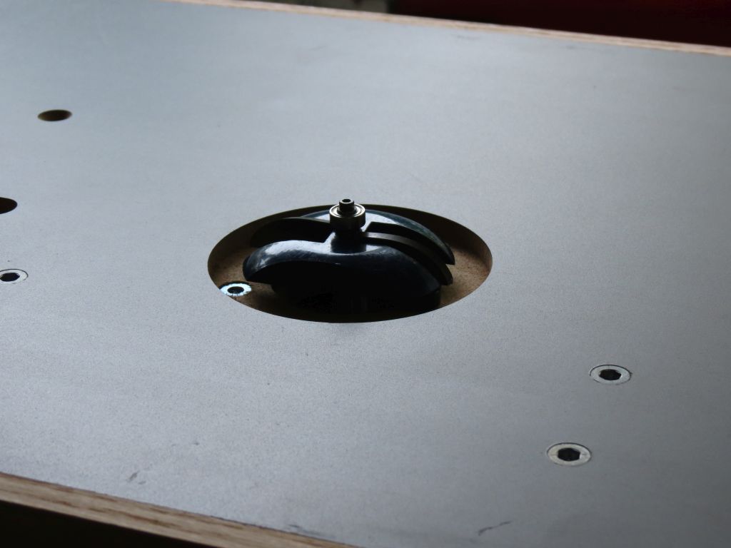

The other option I mentioned to mount an additional table on top of the main table. It would have a larger opening for the bit and the bit would run above the main table. This would allow custom made inserts for different size large bits. It would also require making a fence to fit it.
I don't have such a top but this is the general idea being simulated here.
This is a 3" bit for reference sake.

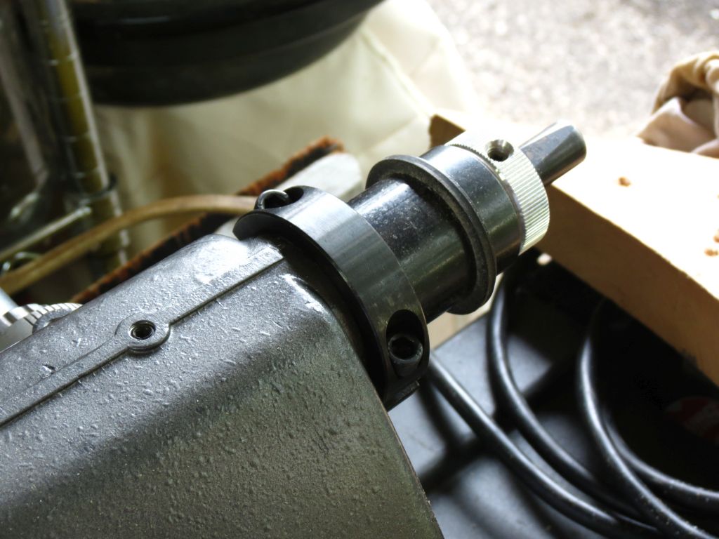

As I also mentioned you will want a stop collar to prevent the quill from retracting beyond a certain point. It would look something like this.
Hope that makes sense.
