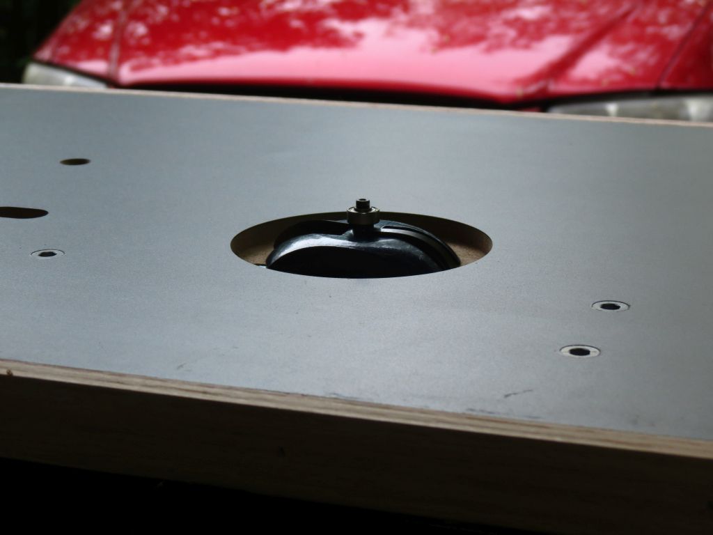

Depending on which table insert you have you will find they have different size openings. The larger one measures 2-5/8" and would work for a bit in the 2-1/2" range. This would be good enough for a 1" radius bit, no more.
The width of the table insert is indeed 3" so that would be a limit of sorts but even if you make your own insert I don't see being able to use a bit with a diameter of more then 2-3/4" which is pretty much back to 1" radius bit.
The other option I mentioned to mount an additional table on top of the main table. It would have a larger opening for the bit and the bit would run above the main table. This would allow custom made inserts for different size large bits. It would also require making a fence to fit it.
I don't have such a top but this is the general idea being simulated here.

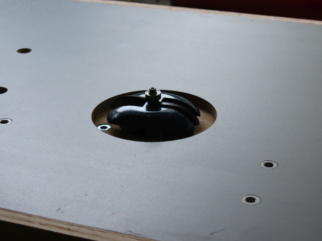

This is a 3" bit for reference sake.

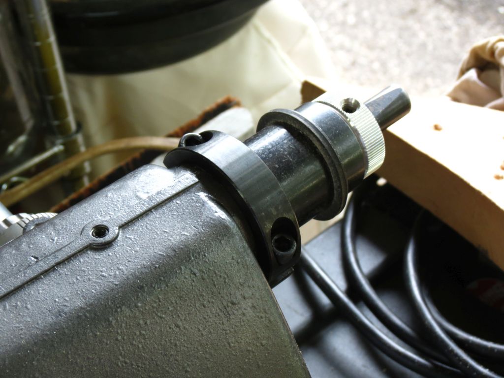

As I also mentioned you will want a stop collar to prevent the quill from retracting beyond a certain point. It would look something like this.
Hope that makes sense.

Ed--thank you, very thoughtful response. May I ask where you get the stop collars and what sixe are they. I would like to try your suggestions.
Re: Routing w 1 1/2 round over bit
Posted: Wed Jun 17, 2015 6:01 pm
by dusty
Scroll clear to the end of this thread to get your answer. Do this when you have some spare time. It will take you awhile.
http://www.shopsmith.com/ss_forum/viewt ... ar#p127380
I just ordered two. I don't know why. I just did. If Ed has one, it must be useful.
