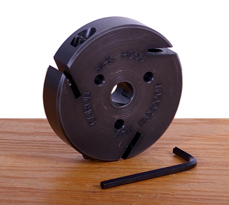

- molder_head_l.jpg (70.45 KiB) Viewed 4130 times

My recently purchased Shopsmith molder head is marked Corob, so hopefully, the knives from Corob will fit. Perhaps the note on Corob's site refers to the previous Shopsmith molder head.

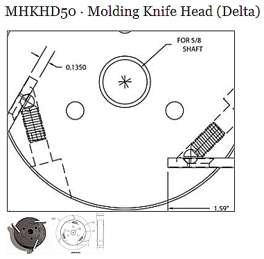

Re: A tale of two molders
HMMMMM!
Note the thickness of the knife slot.
My molder head is the same as the one pictured in Dusty's photo.
Slots are 0.1625" wide, blades are 0.1575" thick.
An interesting thing, to me, at least, is that the ball bearings are small enough to pass through the hole in the knives, but when the knives bottom out, the holes are offset, so that the knives are locked similarly to the way the base lock locks the Shopsmith in the vertical position.
You can sort of see that in JPG's jpg.
