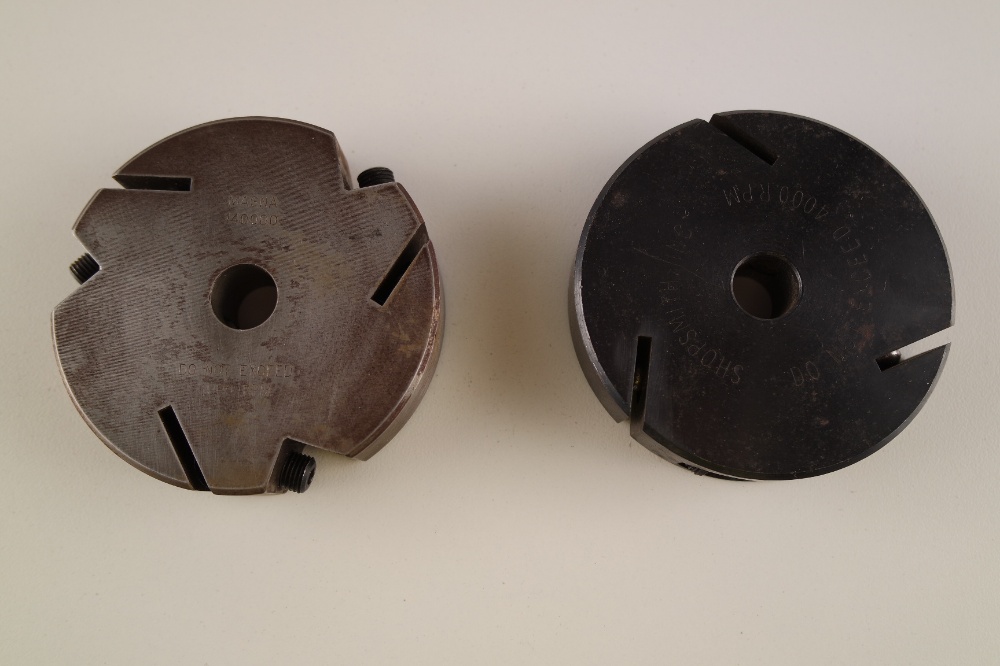

How about a pic of what ya have?

Photos would help but the one you have marked "Shopsmith" is probably what is now considered the "old style." The "new style" uses thicker knives.
The one you have marked "Magna" was not even produced by the current Shopsmith company and isn't on their radar.
Having never had a Magna version I don't know if the knives are interchangeable with the Shopsmith "old style" head.

beeg wrote:How about a pic of what ya have?
Duuuh....my bad.
Re: A tale of two molders
algale wrote:Photos would help but the one you have marked "Shopsmith" is probably what is now considered the "old style." The "new style" uses thicker knives.
IIUC, the older versionS are compatible. The currently available version is not according SS.
The original older version used screws to directly secure the knives. The version recently replaced used 3 ball bearings in addition to the 3 set screws.
Any one having the original version and later versions would be doing us all a service by taking pix of both the knives and the holder.
There was also an aluminum version.
I will post some pix as time allows unless someone beats me to it.

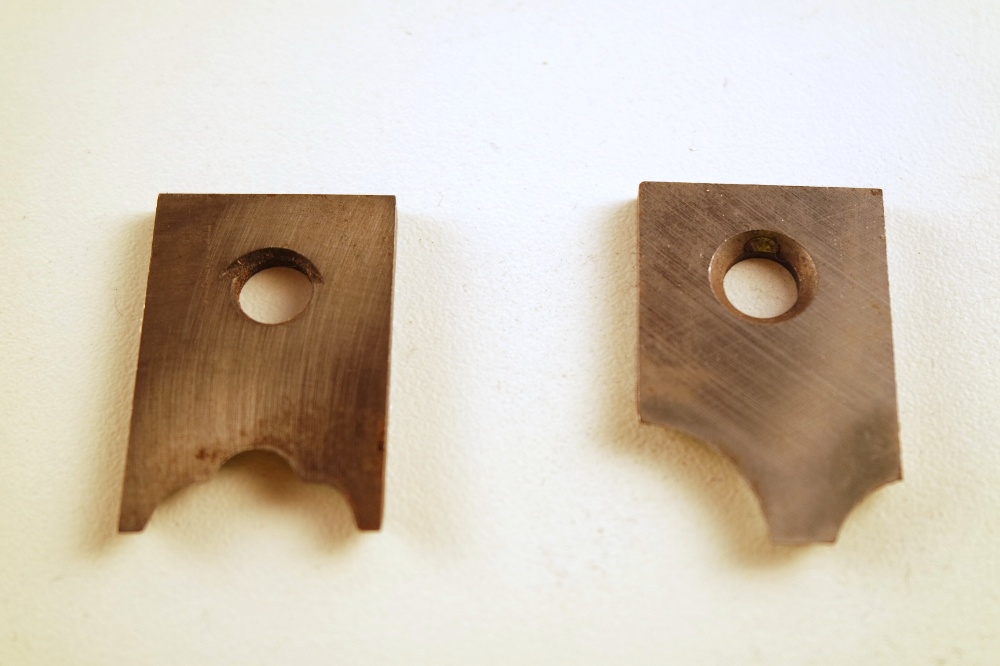

When I get home I'll look. Just for kicks here is a pic of the different cutters. Left is Magna and right is SS.
