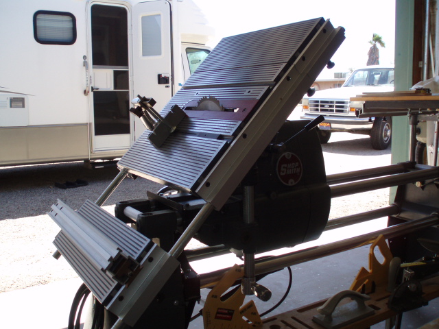

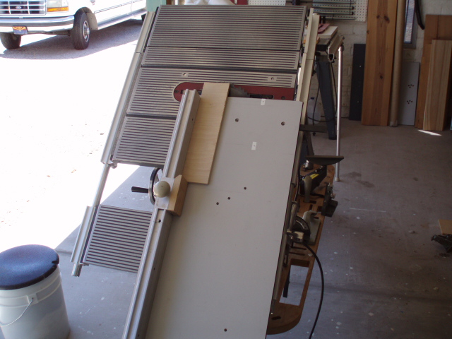

I don't understand the problem. I have done moulding in three for four different renovations and the Mark 5 works well for this. There is a length limitation but it is somewhere near the 8' mark]5404[/ATTACH]
[ATTACH]5405[/ATTACH]
The Mark V, as setup in the 2nd photo, is an accident waiting to happen. There should be an extension table to the left of the cross cut sled and something needs to be done to prevent the cutoff from sliding down in to blade and being converted immediately into a dangerous projectile.
I offer it here as photo evidence only that you can set up at 45 degrees right and have clearance for long stock.

As Dusty illustrates and explains, longer then 4' boards are definitely doable. There are also methods available that will increase the cutting length. A Mark V can be placed at the end of a porch, loading dock, pickup bed, a platform-purposely-built-for-this-operation, etc., to accomodate the need. Necessity is the mother of invention. These methods may be a nuisance, but how often are they required? If you do require this set-up frequently, you will develop a means to do them. If, like I believe is the case for most of us, your need for this is infrequent, Chuck's post (#28) gives the proper answer.
