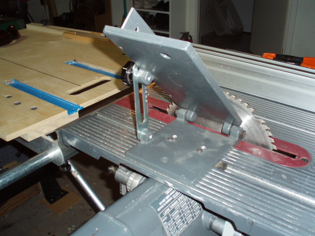

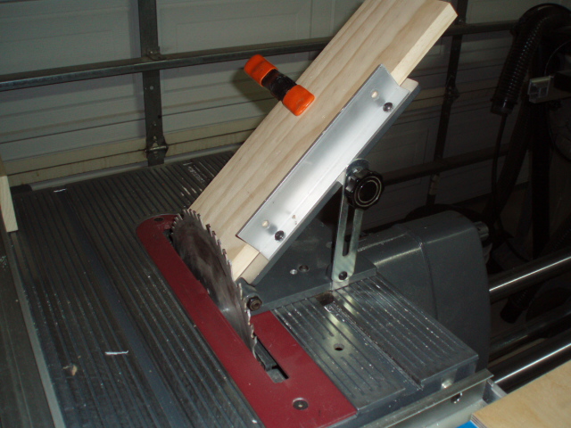

The Bevel-Miter Gauge (555461) works fairly well for cutting miters; however, there is a big drawback.
Because of the way the jig rests on the main table (set up as a table saw), the stock can only be about 1" longer than the required finished piece (measured long point to long point).
The procedure would be as follows:
Prepare all of the pieces to be mitered by cutting pieces that are no more than 1" longer than the long-point to long-point finished dimension.
Cut a miter on one end of each piece, cutting off no more than is necessary to complete a miter cut.
Measure and mark (on the infeed side) the finished dimension for the 2nd cut (measured long-point to long-point).
Cut the miter to finished length.
There is not much flexibility using this fixture for end cut miters. I will probably not use it much more in the future than I have in the past.
I have requested documentation from Shopsmith. If, after reading the documentation, I find that I have improperly characterized the Bevel-Miter Gauge I will that here.
For now, I'll hang mine back on the wall. Since I don't have a Joint-Matic, I suspect that I am trying to use it in a manner other than it was intended.

I think it is designed to function with the Joint-Matic and trying to use it without a Joint-Matic may be ill-advised. I've requested documentation from Shopsmith.
As always, they were most accommodating. Linda read the pertinent parts to me but I'm waiting for something to read myself.

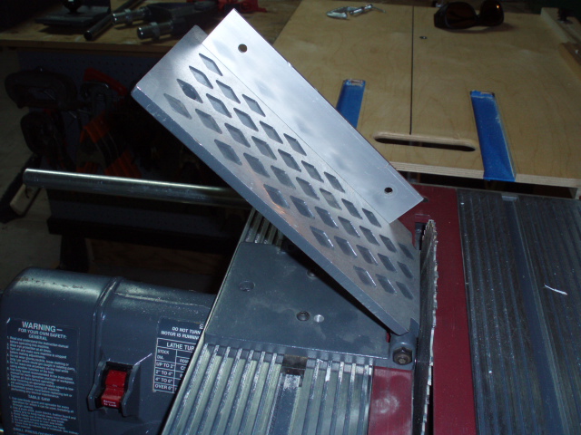

Here are pictures of the Bevel-Miter Gauge. Please ignore the fact that the blade is set much to high to be safe. Not good.

Nice pics, Dusty. I want one of those.
