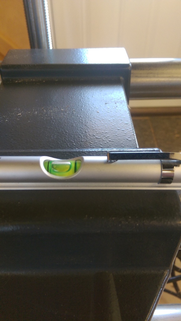

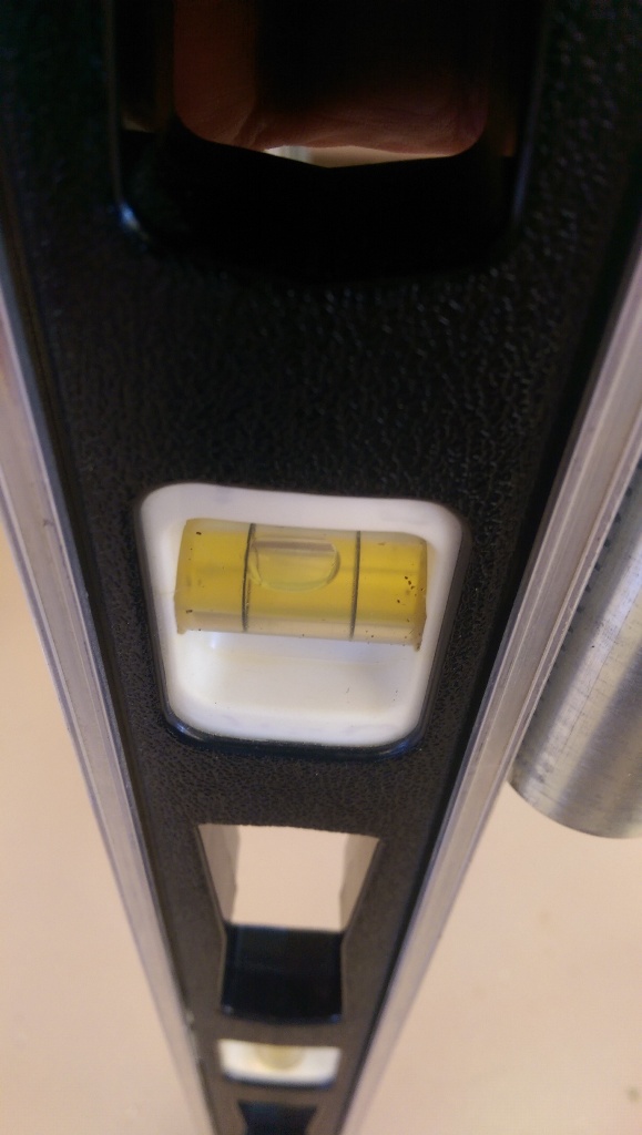

Yes, all four tubes are level and yes the carriage slides very smoothly. The main table is at zero tilt in reference to the saw blade which is the correct reference but it is not level as we have been discussing. FWIW the way tubes are thick wall 10ER tubes.dusty wrote:I am disappointed. I would have bet that the Extension Tables would swap end for end and be perfectly aligned.
Using the handy dandy level that is shown here, are all of the tubes (Way and Bench) and the Main Table at zero tilt all level (or at least out of level by the same amount in the same direction).
Does your carriage slide smoothly on the Way Tubes. If it does, I doubt your hypothesis of the carriage holes being a contributor.
After checking the Way Tubes and finding them dead on, check the Main Table legs for vertical. That will likely dispel any thought of problems with the milled holes (vertical or horizontal) in the carriage.
I apologize in advance for thinking and/or saying this but I suspect an operator error. I have far too much confidence in Shopsmith quality to buy those theories.
Good Luck. At least you don't have to consider the possibility of the floor causing any of this anomaly.

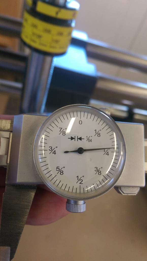

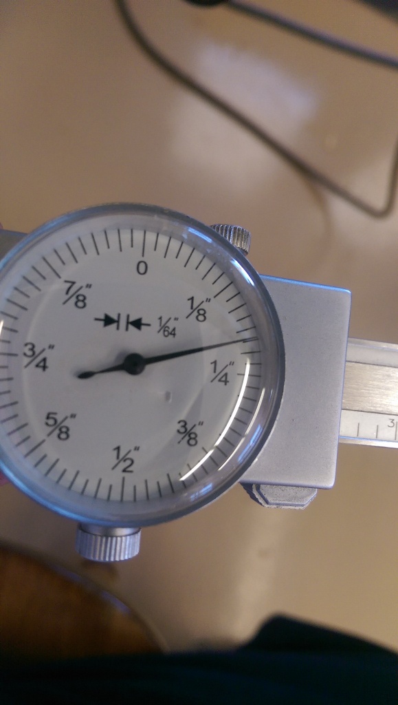

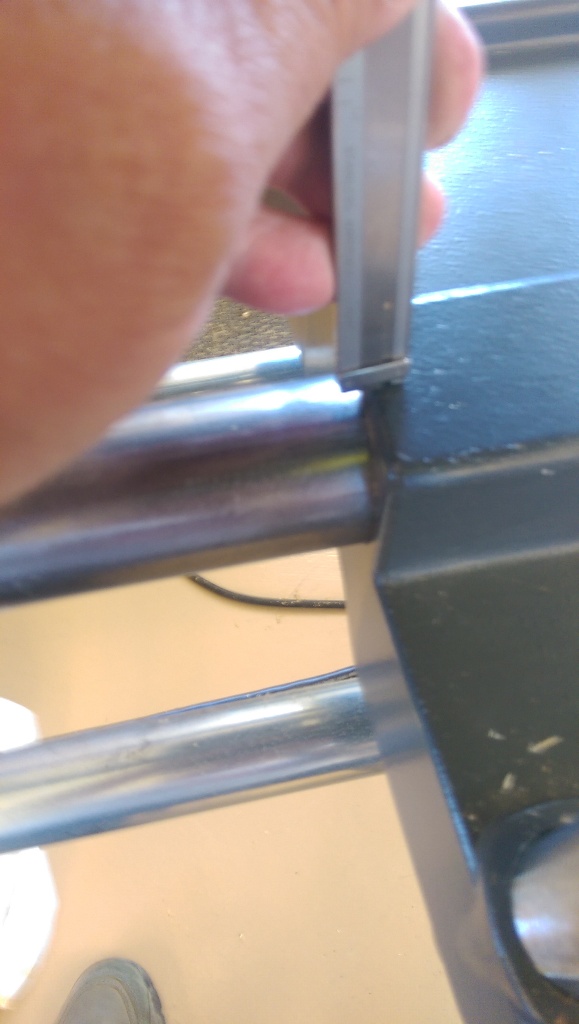

Next I checked the table legs for vertical. They are not. They are out about the same as the table top. So something is wrong with the carriage. I put the level on the carriage right above the way tube and it was out the same as the table top. Not knowing if that surface is a good reference I looked at the way tube holes. The problem became immediately obvious. The way tube holes on the right side of the carriage are closer to the top of the carriage than the holes on the left. The amount is 1/32". As you can see in the pictures the right side measures 13/64" and the left side measures 15/64". So to get the table square with the blade it must be tilted slightly to the right. All the numbers seem very close to what they should be for what I am seeing.
BTW, I checked my shorty and everything is dead square, parallel and vertical. The way tube holes on that carriage are all 13/64" from the top.
As for operator error I don't know what you mean. Are you talking about when I swapped the tables and they were not co-planer any more? I am far from perfect but I don't think I did anything wrong when I moved the tables from end to end.
If you are talking about the main table not being level then I guess it actually is operator error. Not this operator but Shopsmith as the above shows.

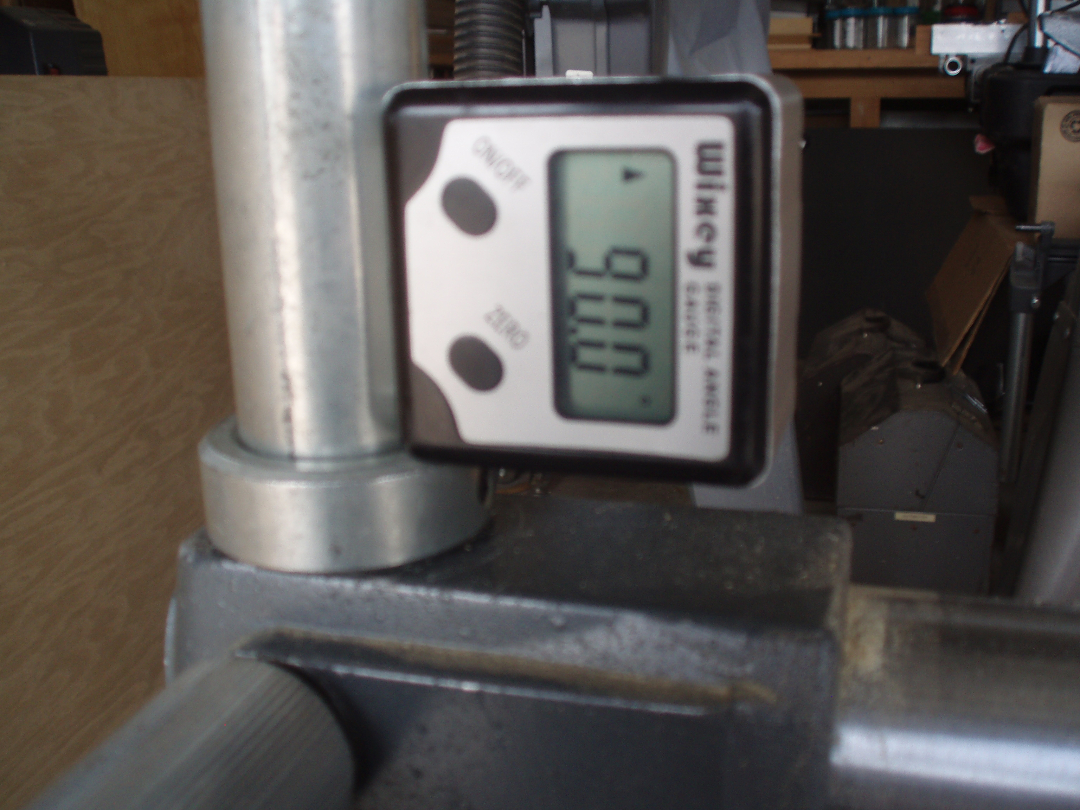

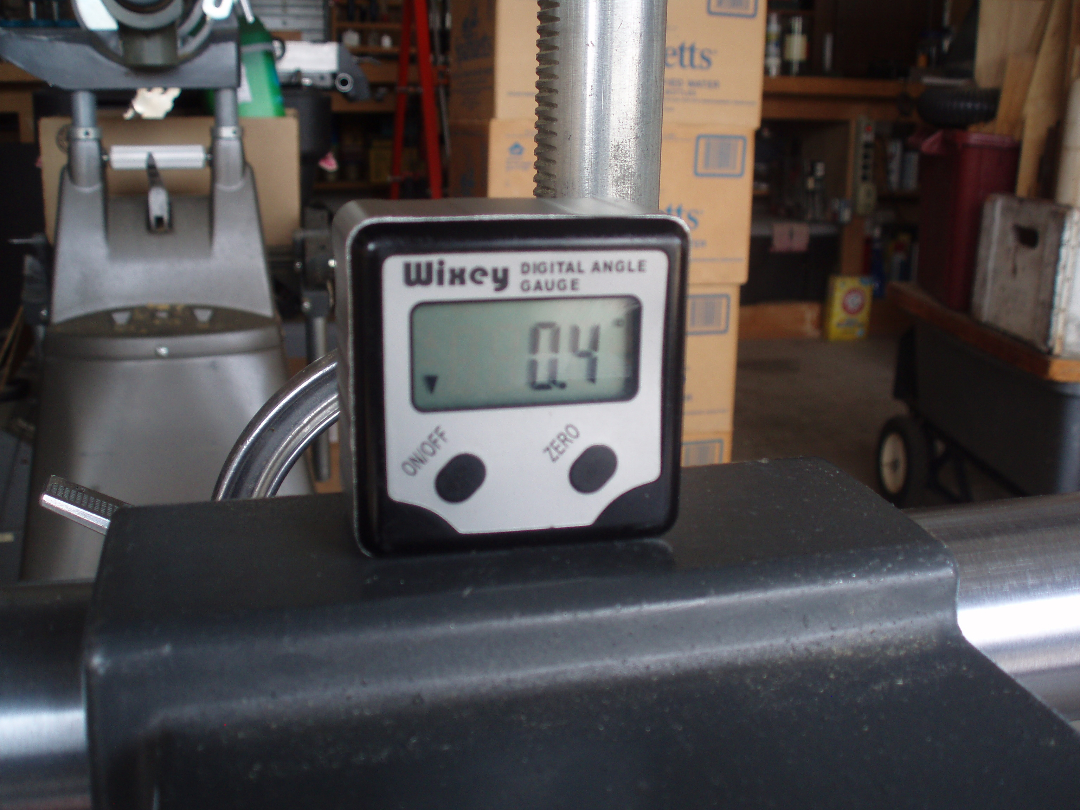

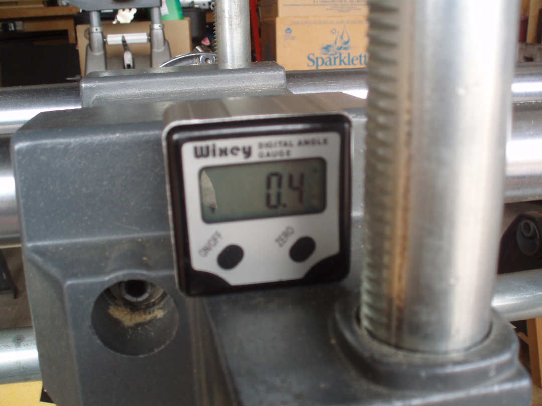

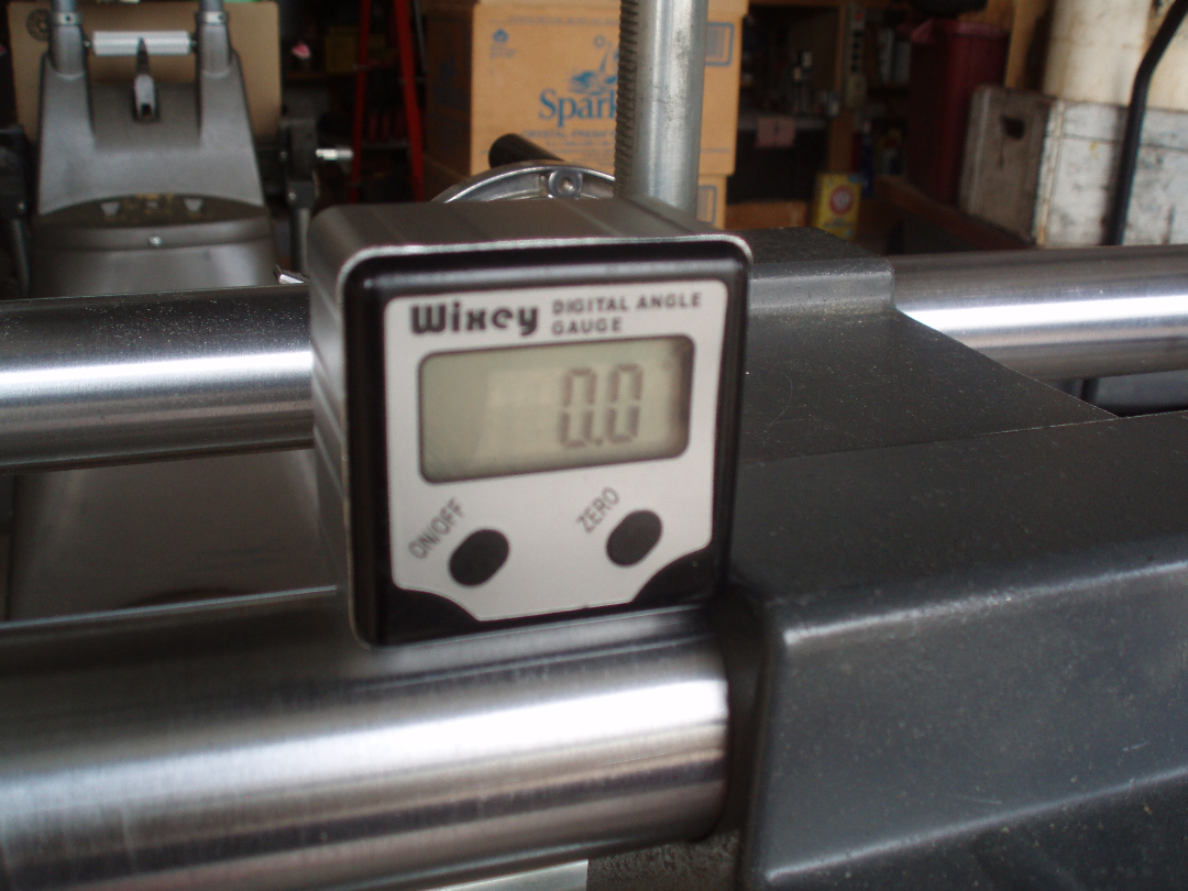

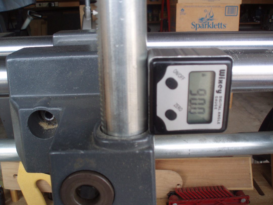

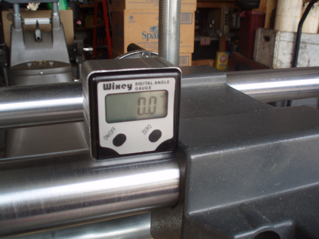

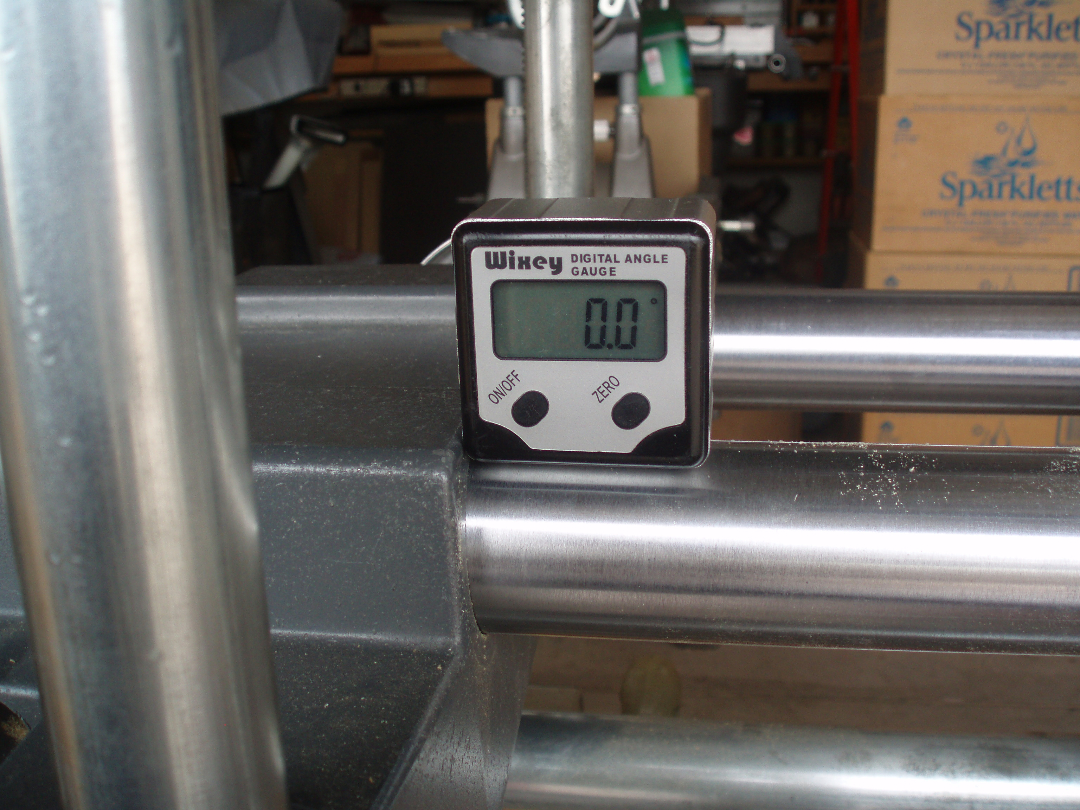

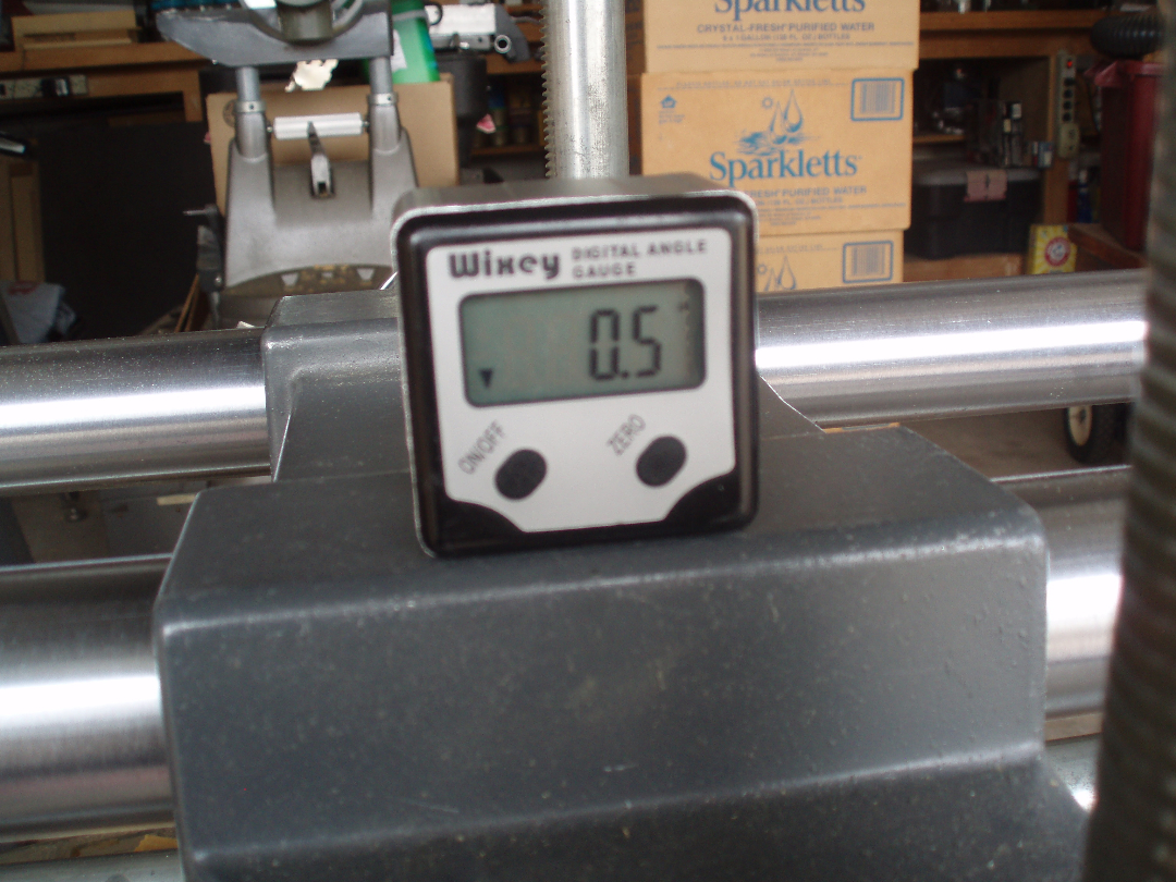

These same observations on my machine produce pretty much the same results. However, I do my checks with a heavy reliance on a Wixey. The first few images show how my Way Tubes, the Carriage and the Vertical Table Leg compare.
These first two show that the Way Tubes are level. Actually I zeroed the Wixey on the first one and then never zeroed again.
This shows that the vertical table leg is at 90°to the Way Tubes.
This shows that the top of the Carriage is NOT parallel to the Way Tubes. I believe this explains some of your stated concern about the Carriage.

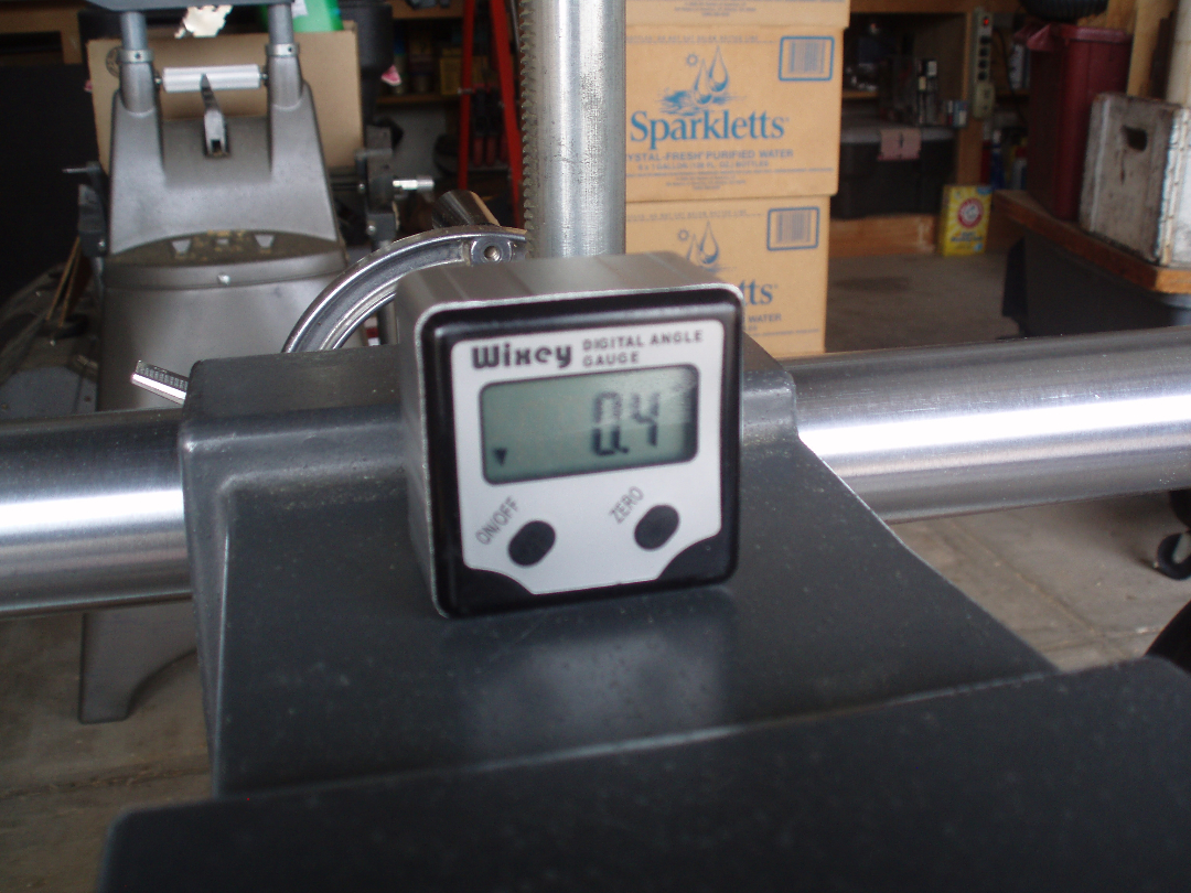

These are some images of the Carriage (the Wixey has been zeroed on the Way Tubes).

I really need to get a digital angle gauge. I have an analog one but it is almost impossible to read anything in the 1-2 degree range. I would certainly not expect that carriage surface to be perfect. That is why I questioned it except my result was consistent with the table leg and table top.dusty wrote:These are some images of the Carriage (the Wixey has been zeroed on the Way Tubes).

Perhaps the bottom machined surface of the carriage would be better to reference than the painted top. When I check my way tubes against the bottom they are equal.jsburger wrote:I really need to get a digital angle gauge. I have an analog one but it is almost impossible to read anything in the 1-2 degree range. I would certainly not expect that carriage surface to be perfect. That is why I questioned it except my result was consistent with the table leg and table top.dusty wrote:These are some images of the Carriage (the Wixey has been zeroed on the Way Tubes).
