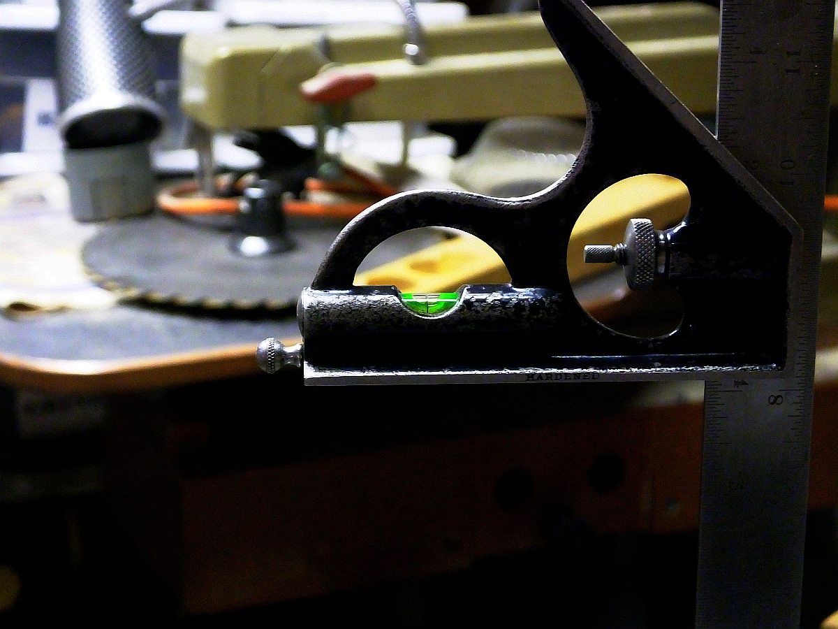

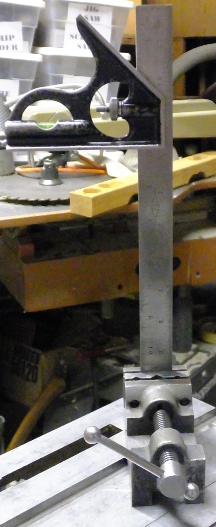

First a description of my 'height' gauge.
TABLE HEIGHT GAUGE.jpg (340.62 KiB) Viewed 1728 times
TABLE HEIGHT GAUGE LEVEL.jpg (716.36 KiB) Viewed 1728 times
The combination square is clamped into a model makers vise and is vertical as indicated by the spirit level.

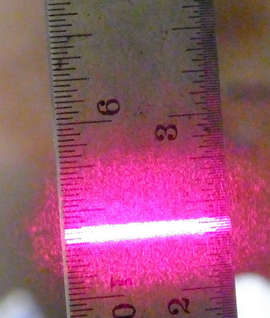

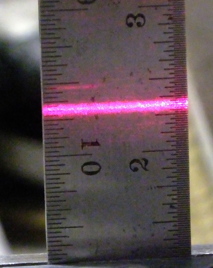

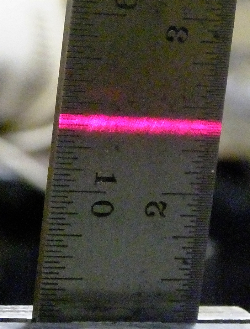

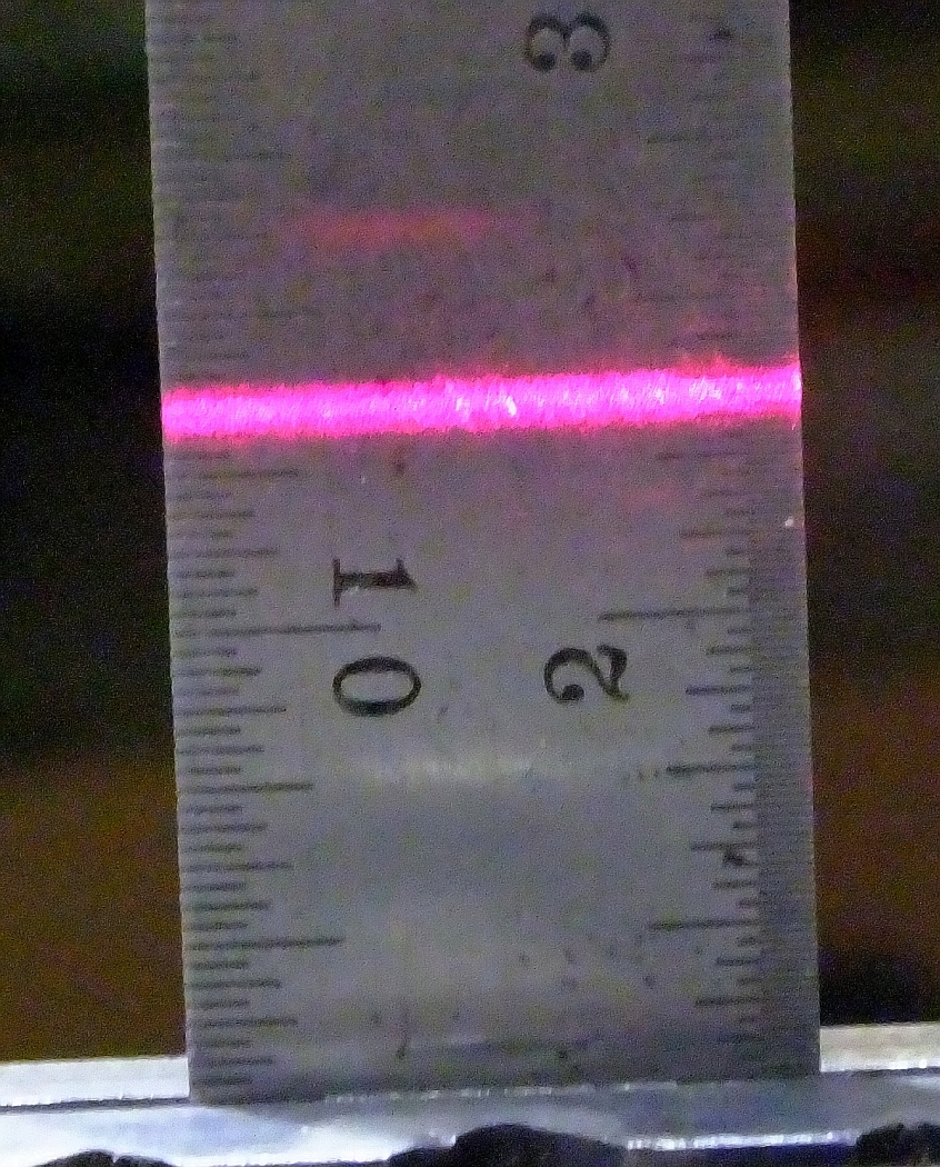

The following pix show the beam projected over the main table and the distance above it near the four corners of the table.

The indications are:(in '32' ignoring the 'inches')
Left rear Right rear 11+ 10+
Left front Right front 12+ 11+
However the beam is 1/32 low in the rear at the way tubes.
So approximately the height variation is:(in '32')
12+ 11+
12+ 11+
Which indicates a slight tilt down on the right side. Again that is the same slope direction as the left right deviation end to end. However the table is not 50" wide, so it does indeed slope down towards the right.
This means both the main table and the aux table have a slight tilt in the same direction.
The laser level does not provide precision due to the beam height(it is exaggerated in the pix due to I assume optics).
However it does serve as an indicator and I believe can be useful in adjusting the tables to be co-planer and parallel to the way tubes.
Doing so would involve much tweaking and repetition(not unlike other methods).
It provides a fairly quick overview.
It provides the crucial parallel to way tube detail that is not included in 'historical' methods.
It involves good record recording and eye squinting to determine those values.
It is not for everyone, but would serve as a method for those so inclined.
