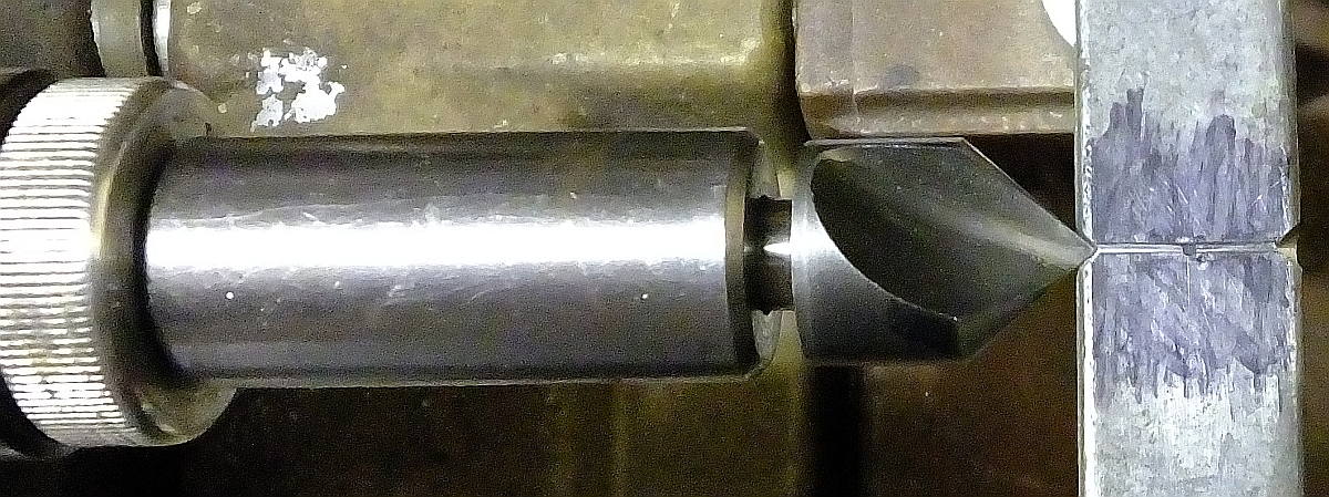

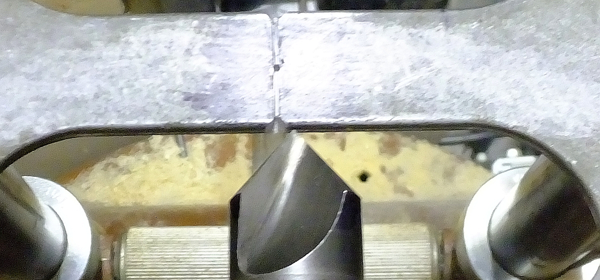

So the first step is to acquire a gauge that can be mounted to either spt mount and provide a reference relative to the spindle.
Aux table mounting tubes are a convenient source. The mounting base is marked so as to locate the center mid way between the vertical spt mount tubes. A 1/2" router chuck and a counter sink bit with a 1/2" shaft works as a 'pointer' that coincides with the axis of rotation of the quill.
The first two pix show the base mounted in both orientations. That illustrates that it matters not how the base mount is oriented.
The router chuck and countersink bit are mounted on the quill shaft, and the quill extended so as to reach the base mount at its midpoint.
centered right a.jpg (396.92 KiB) Viewed 2749 times
centered right b.jpg (490.3 KiB) Viewed 2749 times
That alignment should be automatic. i.e. I did nothing to make that alignment happen. Since the end casting cannot impart a twist to the way tubes at that end, the quill axis should always project to the mid point between the spt mount tubes. The only adjustment I made was to set the height of the mount and attach stop collars so as to achieve the same height repeatedly.

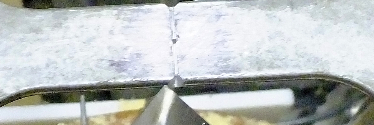

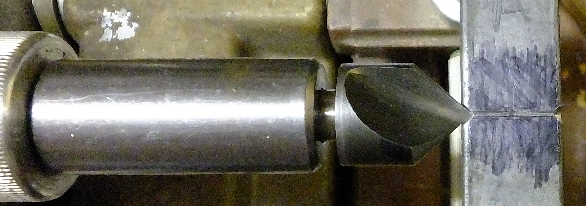

So now how about the left end? Move the router chuck with countersink bit to the upper shaft on the back of the headstock. Move the spt mount to the left end. Slide the headstock to the left until it is barely short of reaching the mount.
The next two pix show the rest setscrew is not adjusted correctly.
off center left rear low.jpg (553.49 KiB) Viewed 2749 times
off center left back high.jpg (329.23 KiB) Viewed 2749 times
I apologize! The pix description is incorrect. reverse 'low/high'. :o
Now for the difficult part. That setscrew is humongous and not easily turned. The newer Mark V has a hex head socket screw. The older Mark 5 has a slotted head screw. A large bladed screwdriver is needed for that.
Now this tweaking must be done accompanied with other tweaking that assures the tie bar actually comes to rest both at the front on the casting, and the set screw at the rear. Moving the set screw alters the tightness of the clamp. Raising the set screw causes the clamp to become tighter. The inverse is true when the screw is lowered.
The clamp MUST assure the tie bar rests firmly on the casting and setscrew with no slop. The clamp has a tapered head(like a flathead screw) that nests into a tapered(similar to a counter sink hole) hole that makes the clamp center the tie bar to the screw. That occurs both laterally(front to rear) and vertically. It is the vertical clamping that becomes critical. If there is vertical play, the tie bar will not rest tight to the casting and setscrew.
So the clamp screw must be continuously readjusted as the rest setscrew is adjusted. It should not be so tight as to bind when the clamp handle is lowered, but also the tiebar must not move vertically when pulled up with the clamp secured. A lot of adjust/test/repeat necessary.
I did not take a pix of the left with the setscrew properly adjusted, but it would look essentially the same as the right.

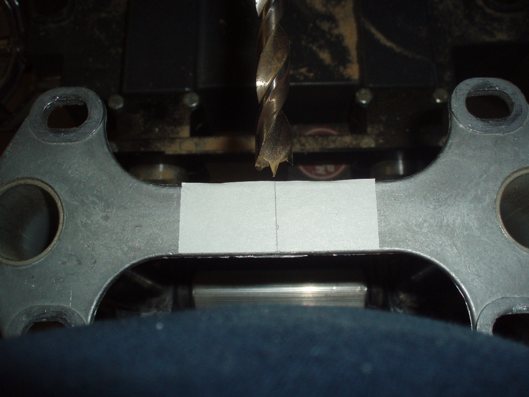

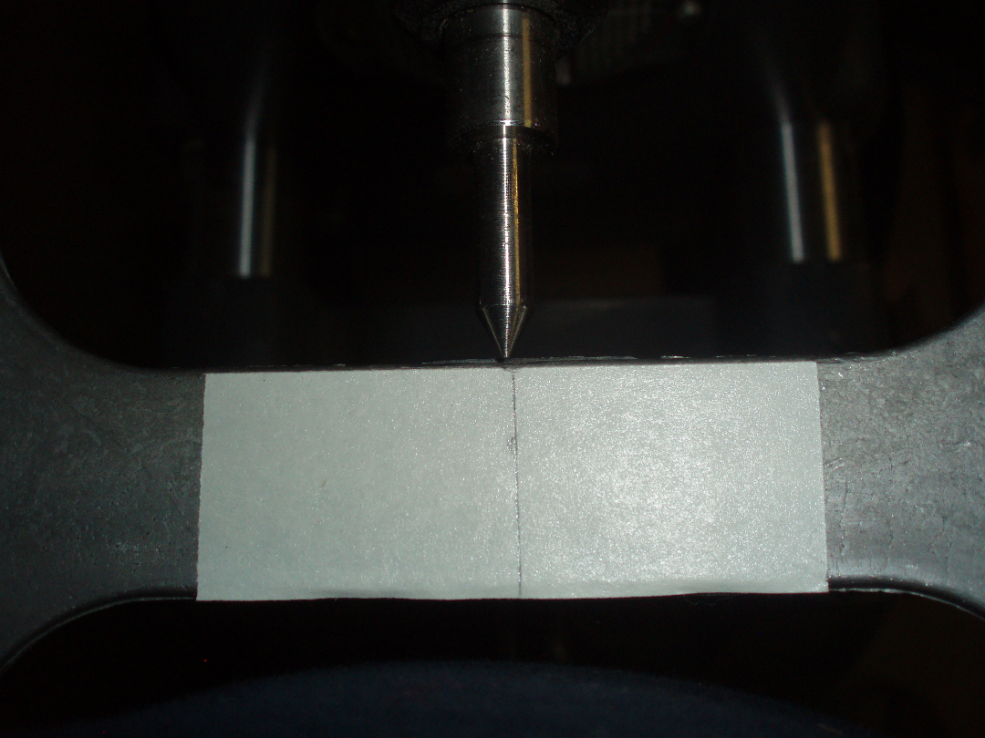

Re: Attempting to Align the BASE
I have been to the shop and it was an enlightening effort. I don't know exactly where I go from here but these two images show what I have to start with. It is important to know that I have two Extension Tables that do not maintain table top alignment if I swap them from end to end. Used where they were aligned, they are as close to "right on" as I need them to be.
It is also important to know that the set screw in the tie bar (on my machine) is not being used. It is screwed in where it touches nothing.
JPG has offered a procedure that is intended to correct the problem that I have. It looks to be very viable.
Left Side Indicator.JPG (1.03 MiB) Viewed 2709 times
Right Side Indicator.JPG (1.11 MiB) Viewed 2709 times
I would normally consider what we are seeing here as "close enough" but given the circumstances I am not going to do that.
Where is the set screw? It is in the tie bar (on the left end) on the outfeed feed side. If I use the set screw, what will it do? I THINK it will move the pointer on the left side toward the infeed side of the machine. This appears as though it would correct the problem with the pointers. I don't know what it would do for table top alignment.
I wonder why that set screw is located in such a difficult position?

Re: Aligning BASE
Raising the set screw moves the mount towards the front. Yours is already too far forward. That is why I repeated the need for the tie bar to be in contact with it clamped. It MUST be tight against the casting/screw. It takes considerable force to make that happen. The clamp needs to be adjusted very carefully. Too tight and it binds. Too loose and it does not accomplish the 'tightness'. Pulling up/rocking the way tubes should not cause any movement off the casting/setscrew.
