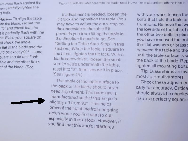

Dug through my in progress reorganization to get the manual. In mine it is on page 27.
See below.
Re: For you digital gauge guys
Remember the wheel and blade is 'canted'! As such, the blade at the bottom of the workpiece leads the top.
