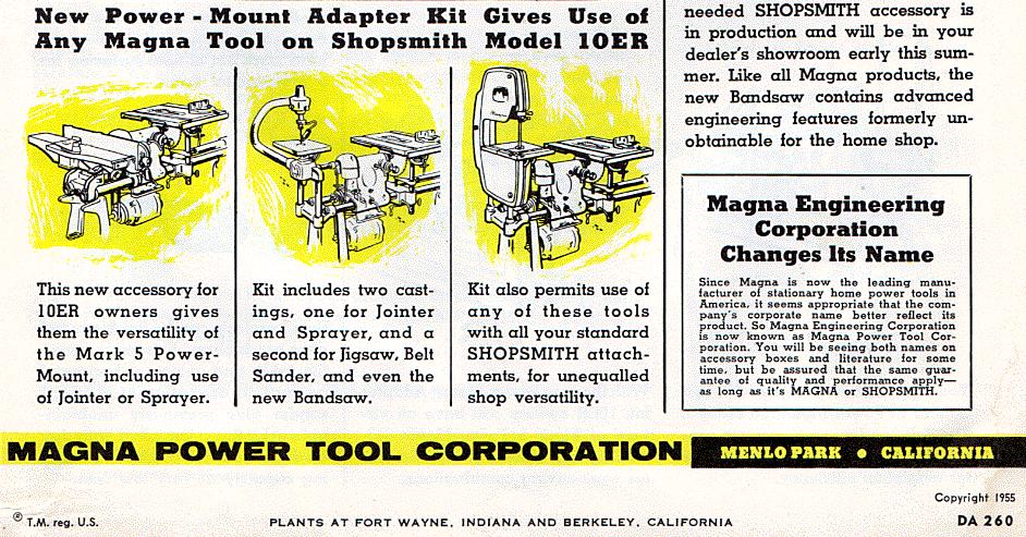

In the Power-Mount Adapter Kit manual it says the A adapter is for the Jointer and the Sprayer, the B adapter is for the Jigsaw, Belt Sander and the Bandsaw.
The B adapter is shown to be mounted in the lower position.
pwrmnt1.pdf
(327.47 KiB) Downloaded 780 times
And this shows a better shot of the bandsaw mounted on the adapter.

rpd wrote:In the Power-Mount Adapter Kit manual it says the A adapter is for the Jointer and the Sprayer, the B adapter is for the Jigsaw, Belt Sander and the Bandsaw.
pwrmnt1.pdf
Thanks Ron. I thought I was good at reading fine print, but I totally missed the fine print that tells which SPTs go with which adapters.
I just measured my bandsaw mounting tubes, and they are not long enough to reach down below the 10ER way tubes, as they would have to if using the A adapter inverted. So it appears that I would have to get some longer tubes if I went that route.

I looked at the manual 4 or 5 times and missed it also. However, The A adapter in the low position will work for the band saw or any other B adapter tool with longer tubes.
I would jump on that 10ER with A adapter for $200. I paid $270 on eBay for the complete adapter kit about 4 years ago and have not seen a complete kit since. You see an A adapter or the pulley very rarely on eBay. I can't ever remember seeing a B adapter.
