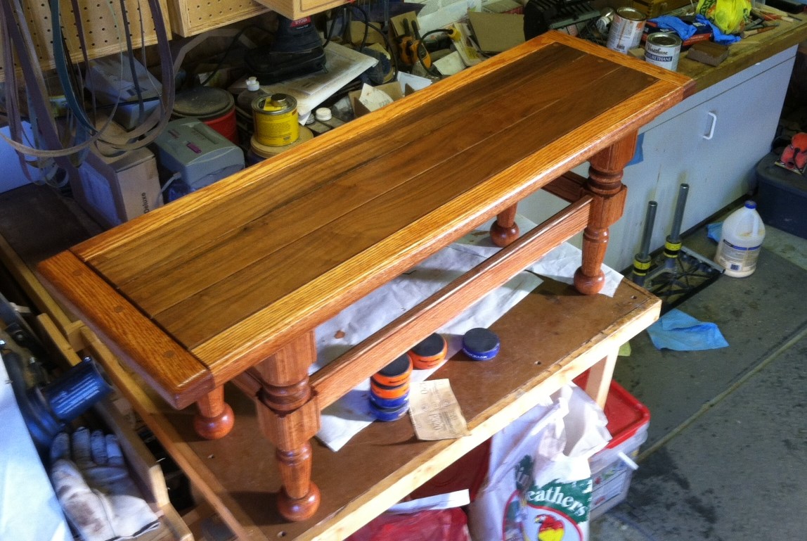

Last Post Here! Got finished in time for Christmas.
Varathane water based Autumn Stain - Varathane water based clear Satin finish.
Top view - Bench.JPG (262.66 KiB) Viewed 3138 times
Re: Once more - the Mark V comes through
Posted: Thu Dec 17, 2015 8:21 pm
by algale
Looking fantastic, as usual!
Posted: Thu Dec 17, 2015 8:42 pm
by ERLover
Great work!!!!! Now tell me about the legs? You have come along way since that cabinet project a few years ago!!!!!!
