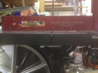

I plan on getting the table removed. Don't have a grinder but do have a couple of Festool sanders. Maybe the machine shop? JPG is right...my Magswitch fence won't work (I think I have a fix for it). I did lay my Woodpeckers square across it and there is a definite bow starting a couple of inches in from each side. Not sure if the "upgrade" to aluminum fence is worth what SS wants.

Trying to attach the picture of the "dish" in the table.
- Table.jpg (28.14 KiB) Viewed 4538 times

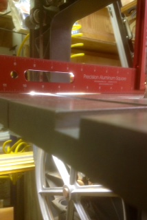

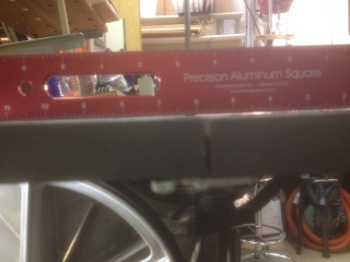

Maybe better views.
- IMG_2540 SS dish.jpg (26.89 KiB) Viewed 4535 times
- IMG_2542 SS dish 2.jpg (29.26 KiB) Viewed 4535 times

I vote new table if it looks like that after it is unmounted and the mounting hardware off. At this point it is looking really bad...

It is a fairly significant dish and boy does that make it interesting when trying to resaw.

The last two pix show the 'tie' bar not tightened to bring the front in line with the back. I think the front/back difference will be greatly reduced if that was securely tightened(both screws).
The first is the problem.
You have a flat surface grinder in the disc sander, but this looks too severe for that to be practical.

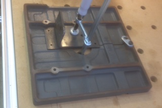

I got the table off and clamped to my MFT table. It was still dished when I took it off but didn't take much pressure to flatten. The one pic with the bolt not installed was before I got a new one and got it all cinched down. It did not make any difference in the dish of the table. I'll see how this works. Heat wise the best I can do is a hair dryer?
- FullSizeRender.jpg (23.73 KiB) Viewed 4502 times

I plan on letting this sit for a few hours and if it doesn't help I will shim up the outside edges slightly and see if I can get it flat with a little more space between the face of the dish and the table. Probably will end up looking lite a pretzel!
