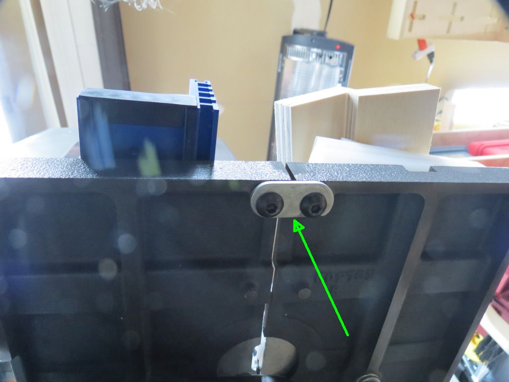

Do you have the table leveling latch and screws in place and tight?

Not sure where those are?
Re: Bowed Cast Iron Bandsaw table.
On the underside of the table where the split is.

Yes i do but only one screw attached. Thanks. Will get another screw and see if that helps.

Ok, I have the screws in and tightened as tight as they wii go but that had no affect on the table bow ib the moddle at all. Should there be washers ubder the clip?
