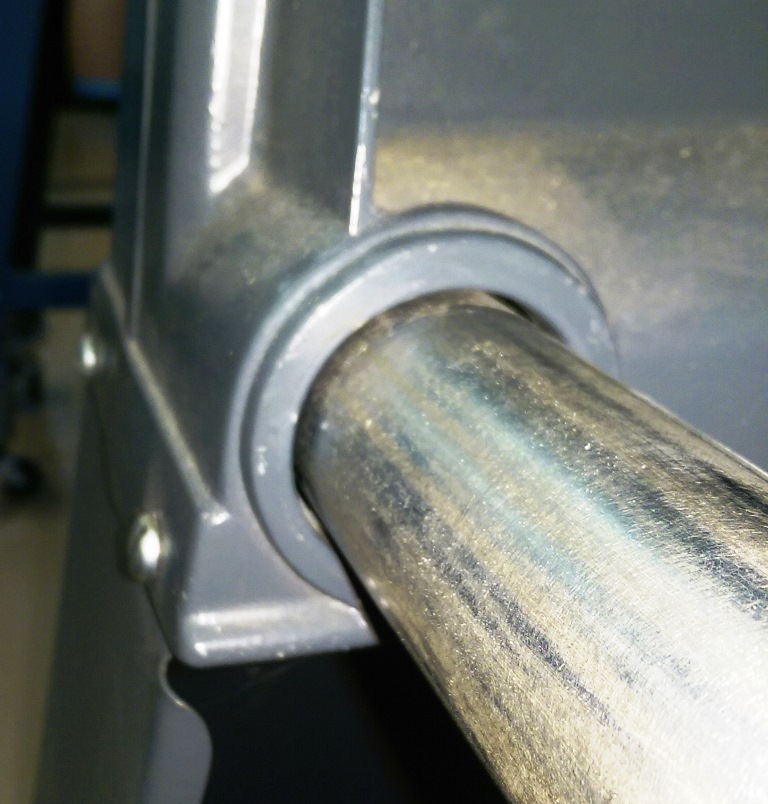

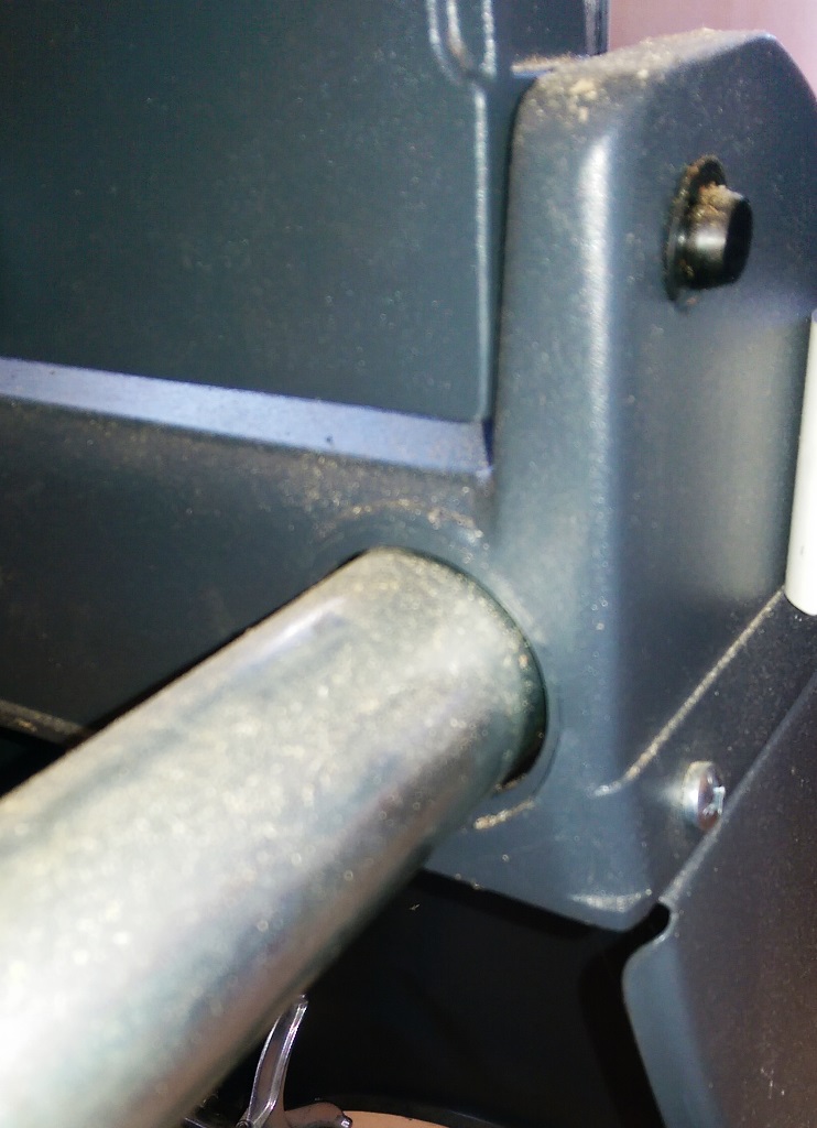

I think the bench tube holes in the base casting are just clearance holes. They have nothing to do with the diameter of the bench tubes. The tubes are held in place by the bosses and the clamps inside the casting.dusty wrote:Is it possible that there was also 1 7/8" grey units. I ask because, as previously stated, I have Bases and Headrests that would accept 1 7/8" Ways. One set of those is on the 510 that I purchased new in 1991. It came with 1 3/4" Wat Tubes but....
The first picture is of a set of base castings I bought on eBay to make my shorty. Vintage unknown. The second picture is of the new double tilt castings bought in 2012 installed on my original 1994 510 when I upgraded it to a MK 7. The original base castings from the 510 are now on my dedicated MK V drill press. I don't have pictures because of the shelf on the tubes but I can assure you they look the same as the other two pictures.

As I said those holes have nothing to do with tube support. They are only clearance holes and still exist in 2012. Hard to believe SS made them smaller for any reason for any amount of time and changed back. I know you know how much it costs to make an engineering change to a drawing let alone the cost of new tooling to implement that change.
