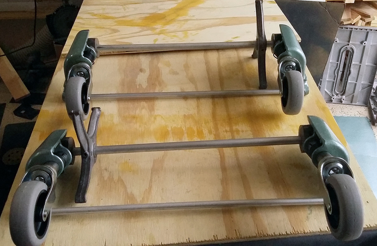

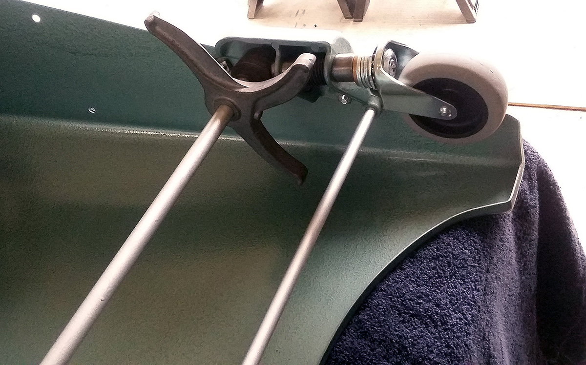

Worked on the Casters, I was going to put the Premium Casters from SS on this Greenie, but decided the Red wheels would clash, so I bought these 3" gray neoprene casters on AMAZON, 175 lbs. per caster load rating, and I had to add 3 - 1/2" SAE flat washers plus a 1/2" bronze thrust washer, liked the idea of the bronze washer being the bearing point, but in reality another SAE washer would have done. The big plus is there is no pedal arm clearance problem. NOTE: I did purchase the metal bracket to precisely drill the holes to move the chaster mounts, they don't match up perfectly with this Greenie, close but not perfect, had to force the bolts in at an angle and twist the mounts to get the holes lined up.
Showing the washers to achieve the needed height
Assembled and ready to put on the legs

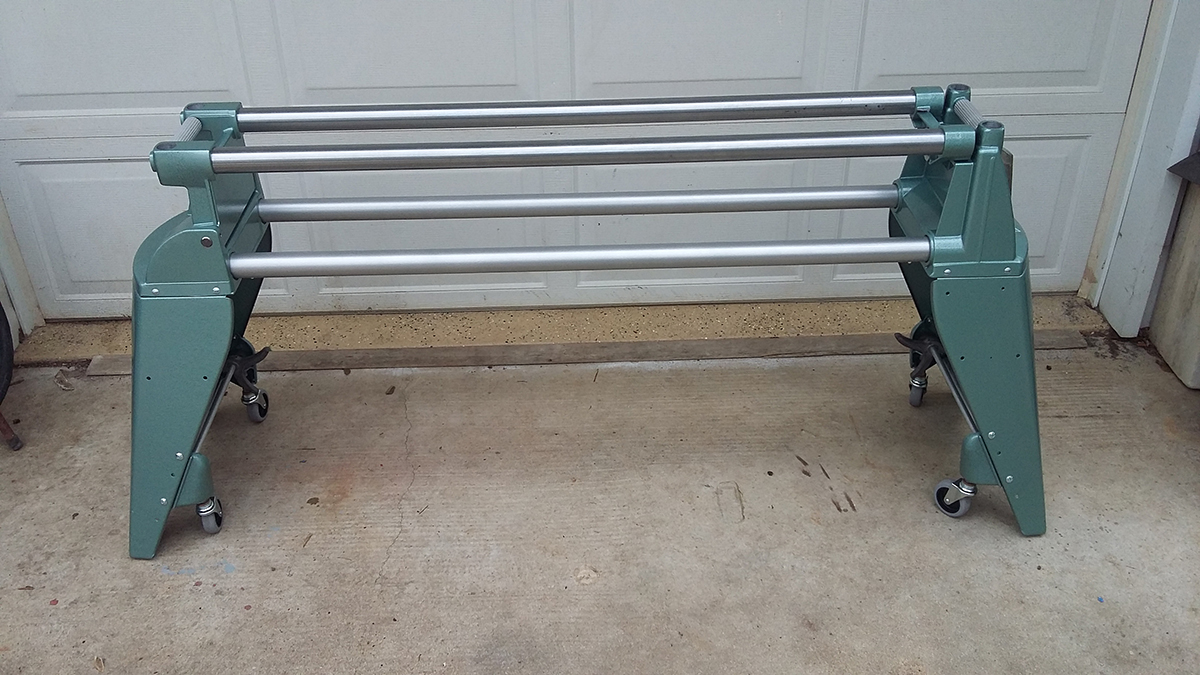

Got the bench tubes back from the Powder Coater today, they look awesome!
Put the bench together this afternoon, now we can progress!
Here the bench is
Here the bench is
Bench complete.jpg (574.14 KiB) Viewed 3428 times
