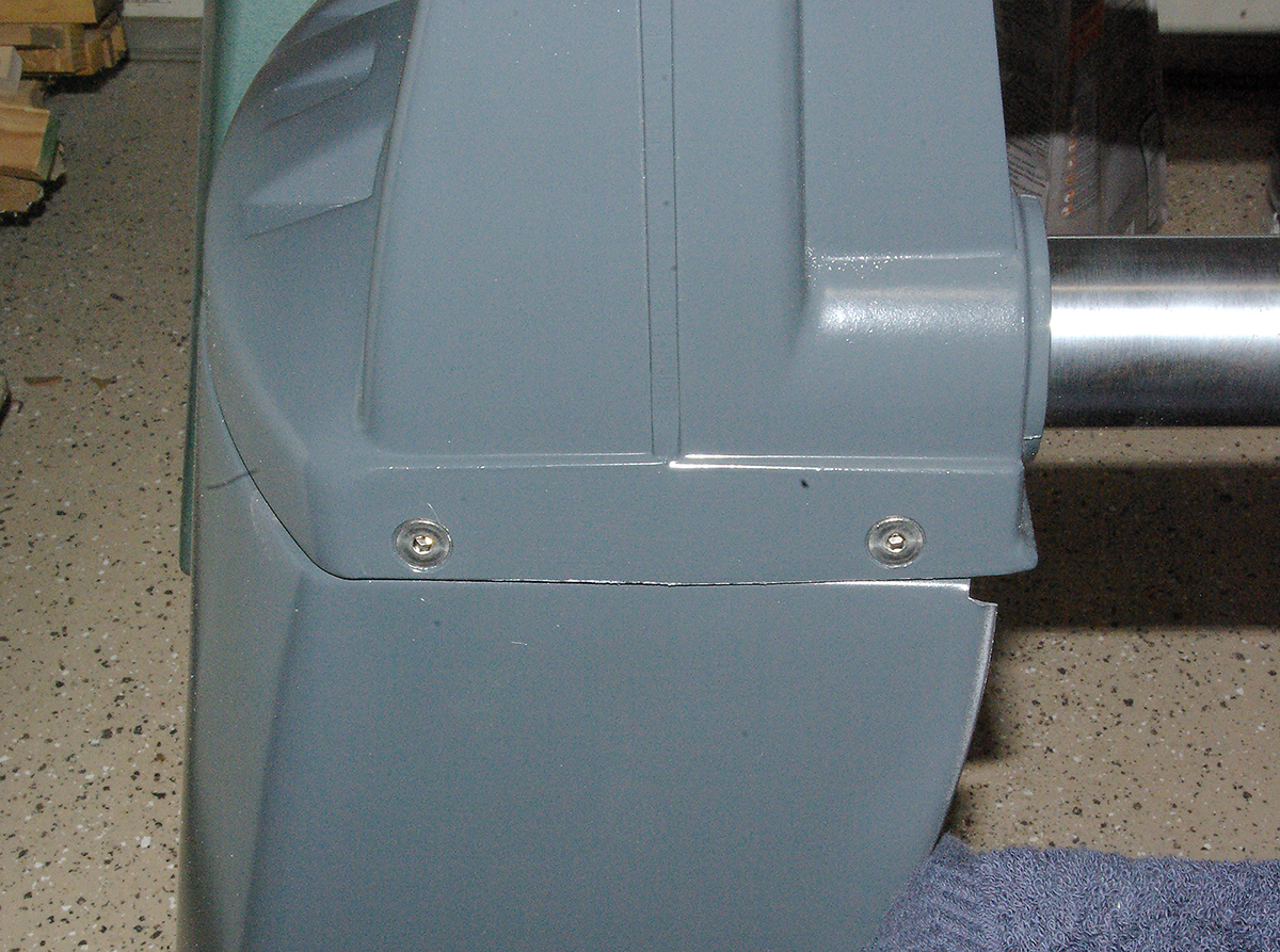

Part of the rebuild was to replace the countersunk slotted head screws with countersunk, stainless steel, Allen head screws, I just liked the appearance better.
Leg screws.jpg (1.28 MiB) Viewed 3209 times

You said "Part of the rebuild was to replace the countersunk slotted head screws with countersunk, stainless steel, Allen head screws, I just liked the appearance better."
I like the appearance and functionality of these. Did your local nut and bolt supplier stock them or did you order them from someone?
The machine is a testament to your workmanship and is beautifully restored.

jjbuzard wrote:Part of the rebuild was to replace the countersunk slotted head screws with countersunk, stainless steel, Allen head screws, I just liked the appearance better.
I like it but I have a question. When did SS change from counter sunk screws to pan head? My new from SS 1994 510 now MK 7 had pan head screws as does the double tilt up grade. The eBay castings (vintage unknown) I bought for my shorty also have pan head screws.
Re: 81 Mark 5 conversion to 520 and Power Pro.
I donno. Sometime after 1981. I believe when they were calling them a Mark 5, they had the csink screws.
What did they call the 1981? 5 or V?
