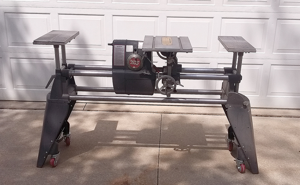

OK new project, I am going to upgrade my 1981 Mark 5 to a 520 with a Power Pro Conversion.
Here is the subject of this conversion.
1981 SS Mark 5.jpg (476.71 KiB) Viewed 4157 times

I am thinking 2 tone, new Shopsmith Gray and Satin Black on the legs,

Re: 81 Mark 5 conversion to 520 and Power Pro.
The ext table(s) on the left are a modification.(two 4" tables)
Even though neither one can be used with the tubes, they are handy to have(they still provide support).
IIWM, I would definitely keep the 'dual 4 inch' one.

JPG wrote:The ext table(s) on the left are a modification.(two 4" tables)
I made the Dual table after I bought the wider table, a simple aluminum plate tied the 2 together.
