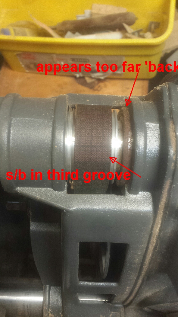

Got the 3 pix in the 'pix' email.
The drive sleeve pix is interesting, although I do not think it has anything to do with the 'turn off/loaning' problem.
The headstock pix revealed nothing unusual.
The internal pix was less informative than the previous.
chuck drive sleeve.jpg (425.74 KiB) Viewed 1587 times
Interesting that the bearing appears rusty. I looks like the drive sleeve is too far to the rear. A pix of the back end of the headstock would help determine if it is a problem or not.
There is some difference of opinion re the poly-v groove that the front of the belt rides in. If the drive sleeve were forward, the third groove would likely make more sense. It is the poly-v belt riding on the idler sheave that makes a difference.
A pix of the rear of the headstock that includes both the drive sleeve bearing(on the top) and the eccentric/idler shaft will be helpful.
I am a bit concerned re the bearing location. I hope the new pix will provide an explanation.

JPG wrote:There is some difference of opinion re the poly-v groove that the front of the belt rides in. If the drive sleeve were forward, the third groove would likely make more sense. It is the poly-v belt riding on the idler sheave that makes a difference.
So should he move it forward or backwards or left or right? :rolleyes:
Re: Turning off mistake
I think we need to verify correct location of the drive sleeve. That forward bearing looks too far back to me. May be poor memory?
As for the groove, IMHO the third groove(that leaves two empty grooves both front and rear). Important thing is alignment with the idler pulley hub.

The bearing is part of the control sheave. Even if you 'recovered' it, the control sheave hub appears severely damaged Besides it is possible the bearing caused the chain of events. Also that thin washer may be the shield off the bearing.
I do not (yet) think the porkchop is damaged. (insufficient details).

JPG, LOOKS LIKE I'VE FOUND THE PROBLEM.
IT APPEARS THEY DROVE THE BUTTON BEARING SO DEEP INTO THE SHAFT END NO LONGER HAS A CUP FOR THE BEARING RIDE IN.
I'M GOING TO TRY TO ATTACH THESE PIX.
Says they are too large, will send to your email

Is the retaining ring in place at the rear of the 6205 bearing? Just a thought.
Bill V
projectdiy
Silver Member
Posts: 19
Joined: Wed Apr 27, 2016 9:00 pm
Post by projectdiy »
wa2crk wrote:Is the retaining ring in place at the rear of the 6205 bearing? Just a thought.
Bill V
No it appears to be gone. I did find those in the motor pan but they appeared to be crushed.
Is there supposed to be a "cup" for the button bearing to ride in??
