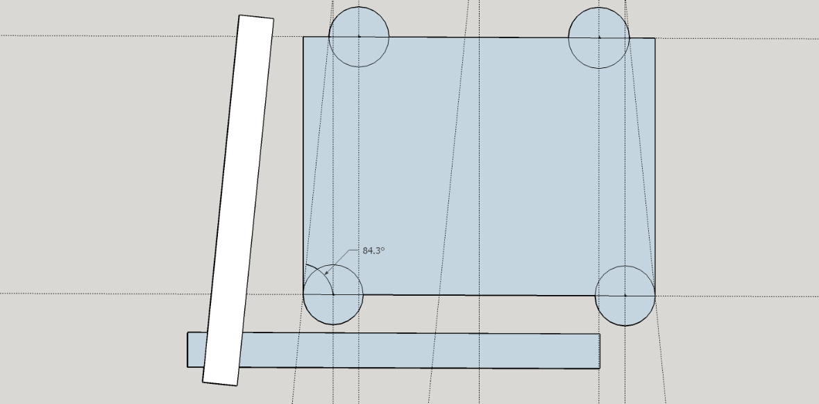

Several comments to this thread and others have stated that the relationship of the bench tubes and way tubes to one another is very important. What I have been missing is that the angular relationship to one another is also important. Reference the following:
Shaft and Tube Angle Verification.png (96.33 KiB) Viewed 2230 times

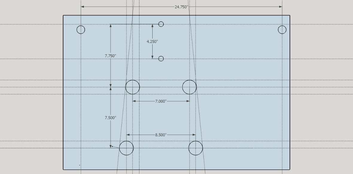

Dimension have not been included because I suspect that no two machines will measure exactly alike. This is one of the barriers to this quest.
Again, dimensions will likely vary from machine to machine. I have annotated this drawing with the angle measured at only one corner of my machine. Measurements must be taken at all four corners. More importantly, if interchangeability is to be achieved, all four corners must be the same.
I have three setups on which I can check this relationship. Three setups means twelve corners to measure. After making and recording the twelve corner measurements I was astonished to find that I had absolutely no correlation at all. I made twelve measurements and got twelve different results. Some are close to expectation while others are not.

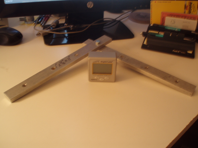

Here is the tool that I cobbled together to make the measurements.
Tool to Check The Tubes.png (71.43 KiB) Viewed 2192 times
Angular Verification 001.JPG (125.46 KiB) Viewed 2230 times
The solution is still most elusive but I am getting closer each day. I have a real nice sliding bevel square but it is not long enough for this task so I "made one". The iGaging Angle Cube is really not needed to ascertain whether the four corners are the same or not. If they were the same that would have been obvious.

I'm embarrassed to say that I'm not sure what these diagrams purport to show. Are these the base castings? Viewed from above? From the face where the way and bench tubes enter?
Re: Mark 5/V Extension Table Alignment
From the bottom up, a pair of bench tubes, a pair of way tubes, an idler shaft and at top the quill shaft.
I am not sure why the way/bench tube angle is being measured. Perhaps to establish the bench tube/way tube/quill shaft relationships. The spt bores are what is relevant from this perspective.
In the second pix, the way tubes appear to be 'twisted'.(IIUC)
Keep in mind, the way tubes will only affect the main table.
algale wrote:I'm embarrassed to say that I'm not sure what these diagrams purport to show. Are these the base castings? Viewed from above? From the face where the way and bench tubes enter?
They show nothing except as a collection of facts for me to use as I stumble my way through all of this. If my machines were assembled correctly as should find those relationships in reality.
As for the ways with respect to the bench tubes, if they are not in the proper perspective, alignment of the extension tables could be effected. Someone keeps mentioning twist. Here is where I can measure the existence of twist if it exists.
You might say they are the bench castings but they really are just the end view of all the tubes and rails with the drive shafts thrown in.
