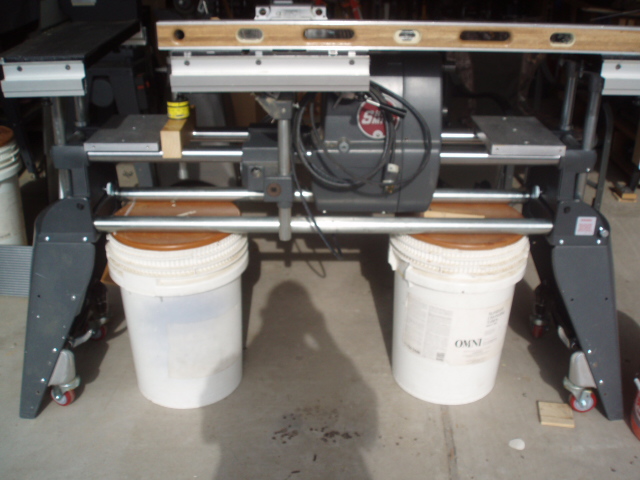

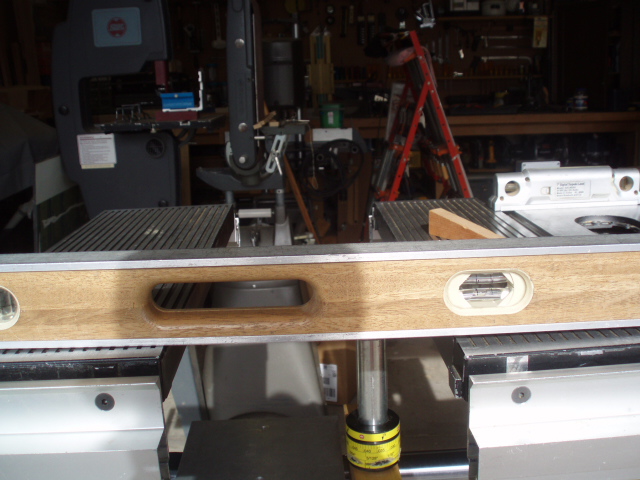

In response to your post, however, I have done something else. I have the Bench Tubes being supported by two barrels so that the Shopsmith legs are off the ground. I did this as sort of a pseudo return to the rebuild process. In addition, I have loosened all four of the Way Tube set screws so that they can take their own positions in the Pivot Arm bores.
This is a look at the Extension Tables after the swap but I think I have to disregard this and start over now that the Mark V is resting on other than its own four feet.
- Up on Different Legs 001.JPG (148.33 KiB) Viewed 3732 times

I do not know what is supporting the two aux tables in the second pix. However it indicates the tables are not in a common plane left/right.

I am not sure what was accomplished by placing on an unknown surface(barrel tops) and loosening the way tubes other than to cause the way tubes to assume an alignment to the unknown(due to the barrels) alignment of the bench tubes.
IIWM, I would for now back track to not referring any alignment to the main table, but rather simultaneously align the two aux tables to each other at opposite ends, then swap and 'observe'. Dig out that laser level.
