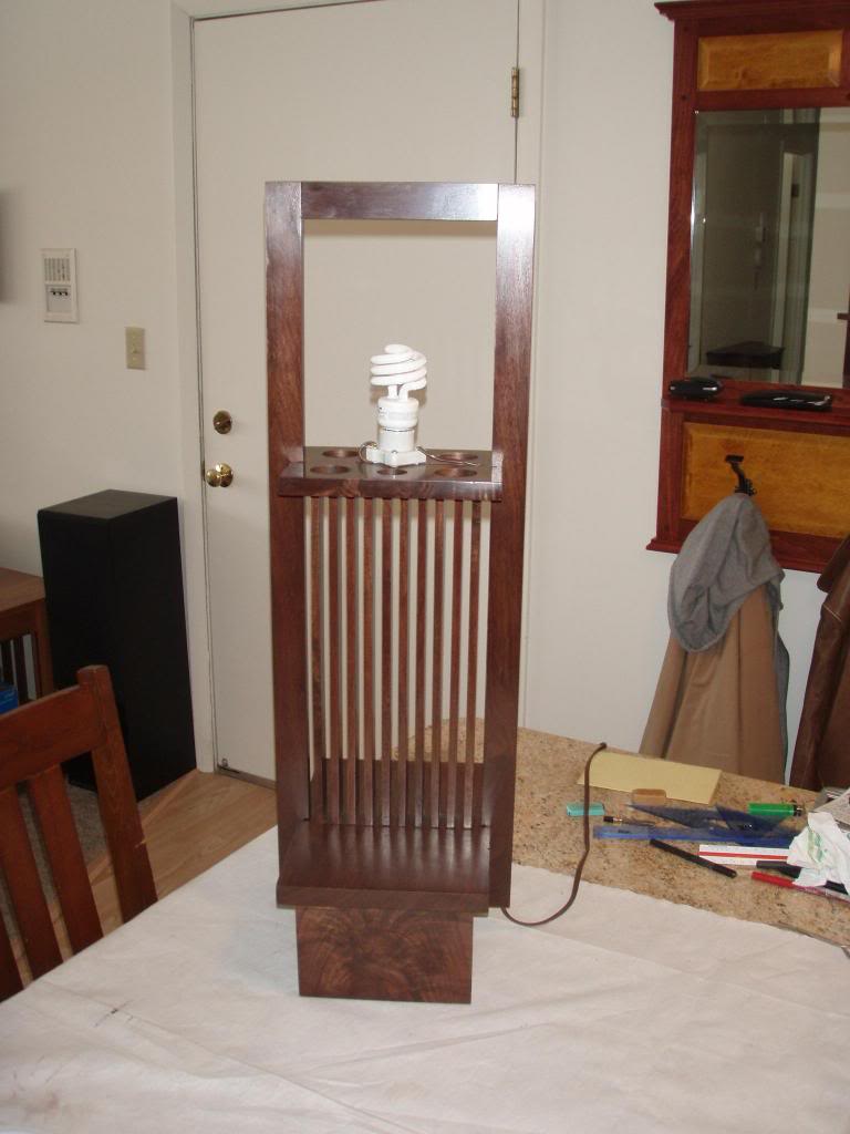

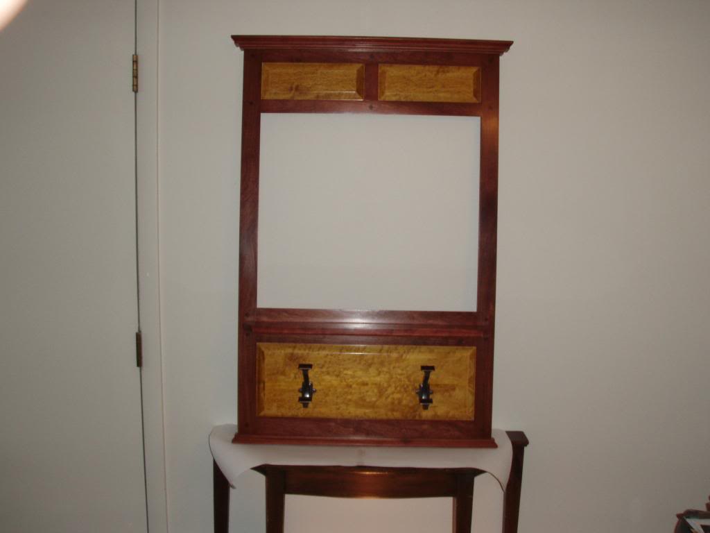

Charlese no disrespect intended, I agree with Reible on my experience also, I use Tite Bond II except for exterior projects then Tite Bond III even though they are not submerged, II would be fine, and never have had a edge glue up fail that was a rip line glue up. Including all my furniture I made for my abode, Select Red Cherry, end tables, coffee table, sofa table and entertainment center.
- P1010082.jpg (232.31 KiB) Viewed 14395 times

More
- P1010178.jpg (229.68 KiB) Viewed 14392 times
