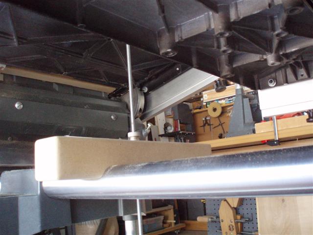

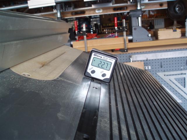

When I need to use the tilted table to make a cut where the "angle is critical" I do not use the protractor on the tilting table. I use a digital angle gauge (Wixey for me). I also have one from Sears (digital level) that works well. To fine tune the tilt angle I use the adjustable stop collar that is installed in a block of wood that spans the way tubes. Get the tilt angle close and then tweak with the stop collar.
I'll try to locate a photo so you can see better what I am talking about. I use the adjustable stop collar for this function far more than more anything else.
I am unable to locate a photo that shows the adjustable stoip collar being used for adjusting table tilt but with some imagination this image shows the same procedure. In this image I am using a piece of threaded rod through a block of wood that spans the tubes. Tilt is adjusted my adjusting the length of the threaded rod. Same procedure - different tools.
- 4 The Mechanism (Small).JPG (49.21 KiB) Viewed 10843 times
- 2 Final Objective (Small).JPG (53.76 KiB) Viewed 10843 times

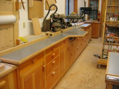

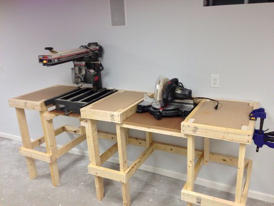

I am thinking about an area that when done will be a combination of a laid in Radial Arm Saw, and a Miter Saw similar to elements in the two photos attached.
The RAS extension on mine, I hope to have hinged in a drop away with slide out 2x4 supports below.
I will use stem slotted elevator bolts, T-Nuts and lock nuts to level the Radial Arm Saw from beneath to the fixed table countertop, with a drop in replaceable Masonite type top plate over the saw area.
Have some of you built something similar for your shops?
Everett
