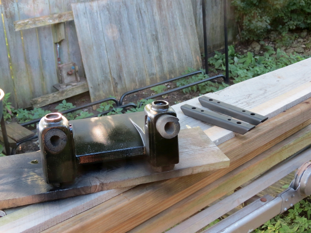

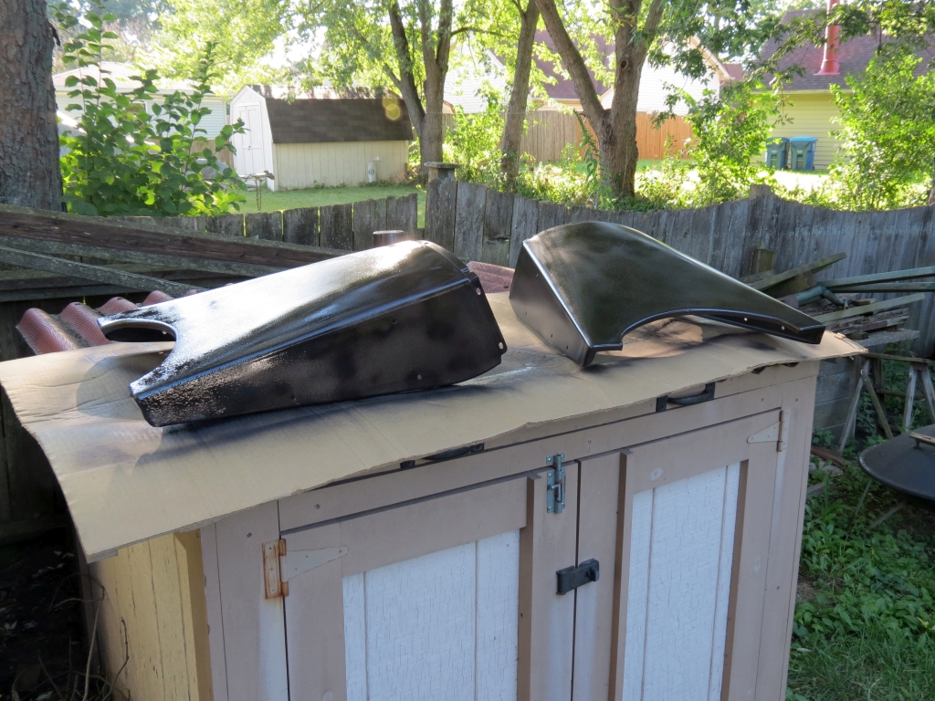

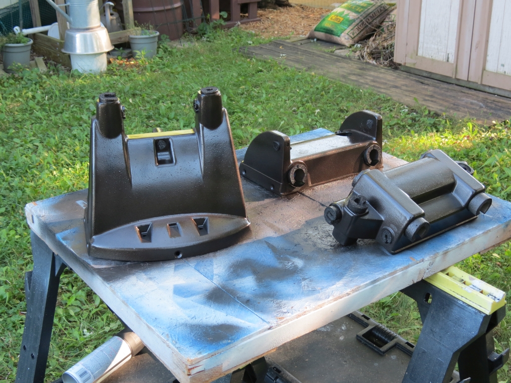

Got the legs cleaned up pretty well this morning before we had to run off. Still need to do a little cleaning on the folds at the bottom of the legs then clean them off before I hit them with some undercoat.
The one leg shows pitting but has been repainted and no sign of rust coming through the new paint so I'm going to chance it and not sand. The other leg is in much better condition, may be even off a different machine???
I'd like to work on it a bit more now but I've been pretty busy/and out and about for most of the day and I think that might be pushing it a bit too much so I'll do a few other projects that I have going and come back to the legs tomorrow. May only need another half hours work or less but it rather late in the day to be painting.
Re: Time to plan the shorty shopsmith
So a little time has past but I got back on the project this afternoon. Got paint on but the weather report says it might be a few days before I can get a second coat on and dry. After this coat dries I have to decide if I will leave it black or go to some other color. Black is a tricky color to paint especially when the surface is ruff and pock marked......... which mine sure is.
Hope it will be dry enough to put in out of the possible overnight rain before it gets dark, skunks happen in the back yard so once it is dark it will either be in or will spend the night out.
