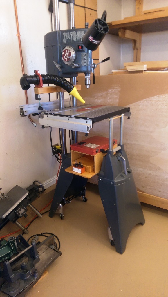

Re: Time to plan the shorty shopsmith
I did exactly the same think with my 18" cit offs. I don't find the leg to be in the way because my foot fits under the arch in the leg and the other foot is outside the leg.RobertTaylor wrote:Thanks John. I used the 16" cutoffs for a model 510 "drill press" only machine, carriage and headstock on backwards. I feel that the front leg is still is in my way, need to shorten the tubes even more.jsburger wrote:FWIW, a 510 carriage works fine with 18" cut off. That is what mine is.RobertTaylor wrote:I cut 16" from my tubes with a "pipe cutter". I used 510 carriage but with a 500 carriage it should work with 18'. the pipe cutter gave a nice smooth square finish to the tube ends.
