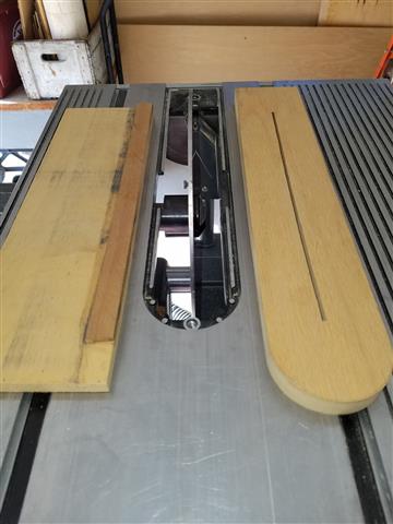

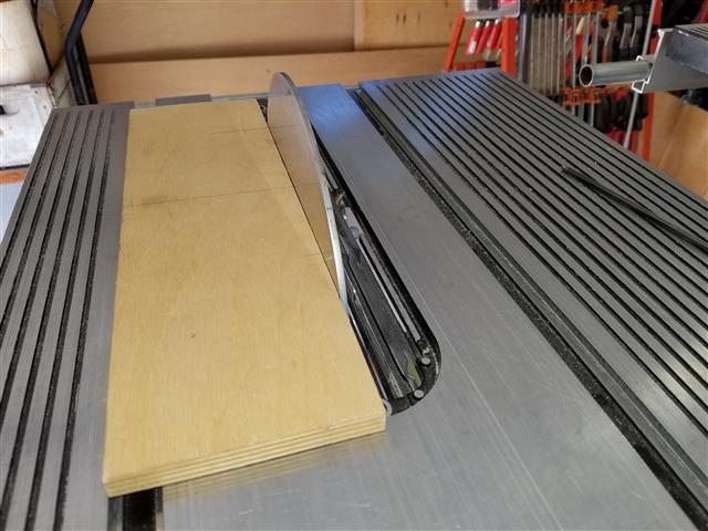

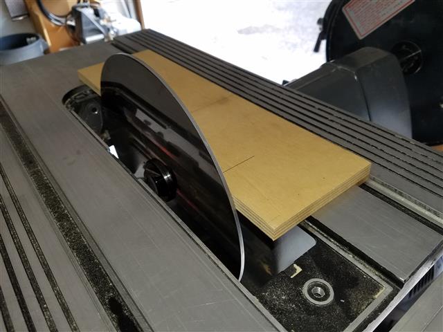

I am not yet prepared to write a Review but I made some quick checks this morning and the New Toy from Infinity Cutting Tools is going to work out just fine. The setup plate has two advantages over a saw blade or sanding disk. The first and most significant is that the plate is thicker (therefore more rigid) and it has no teeth therefore no interference.
I need to remake a couple of my flavor Table Alignment Tools because of the dimension differences but that will be simple.
These are the tools:
