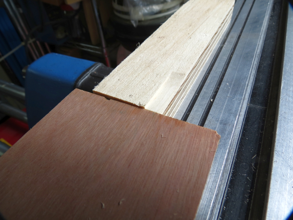

Set up to reduce the thickness of the top and bottom shelf where the plywood thickness was so different. Used the dado blade and adjusted to get the thickness the same as the other shelf material. Just cut the bottom 3 edges where it needs to fit in the uprights.
Here you can see the different in thickness and where I set up to match the thickness of the other shelf material.

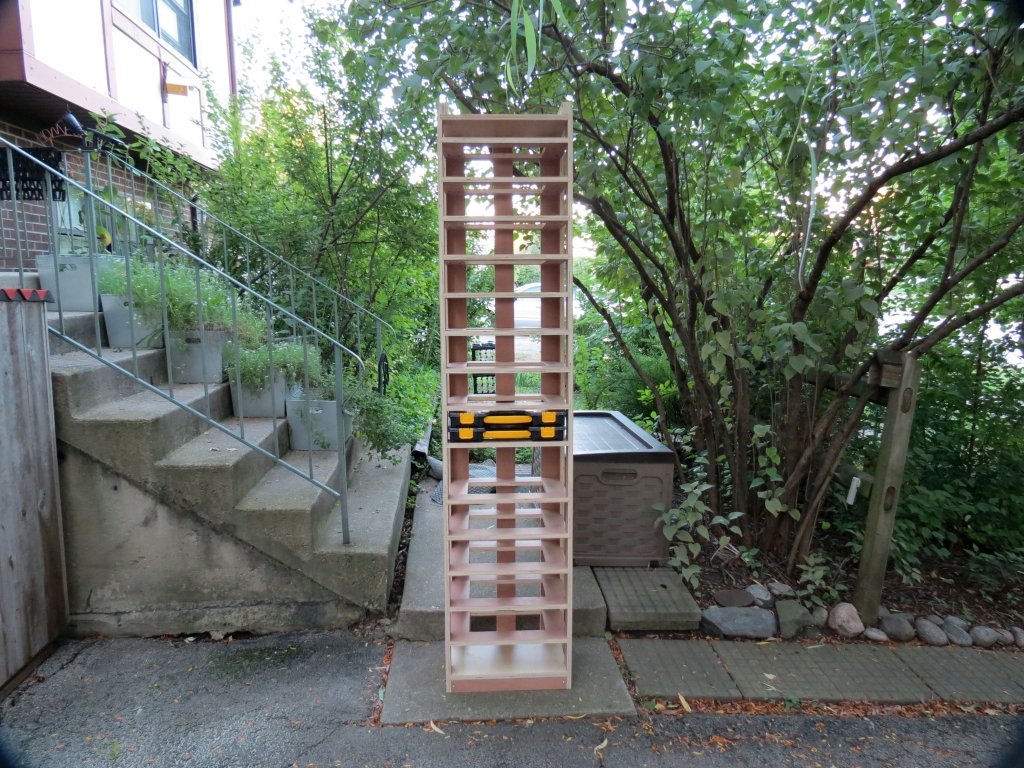

Finally cooled off a bit so while it was still a chance of rain this afternoon I went for it anyway. It is all put together except the casters. Need some hardy screws with big heads to attach them. Hardware store run tomorrow will take care of that.
Already have 28 boxes to to fill it up. But I will work on the casters and the pull out drawer before I start getting it in place and filling it up.
