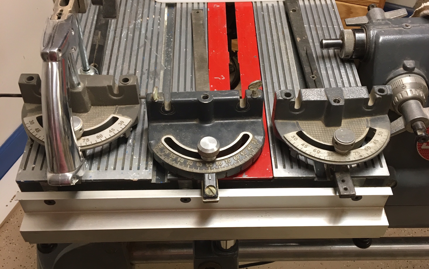

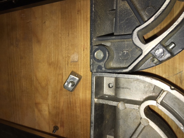

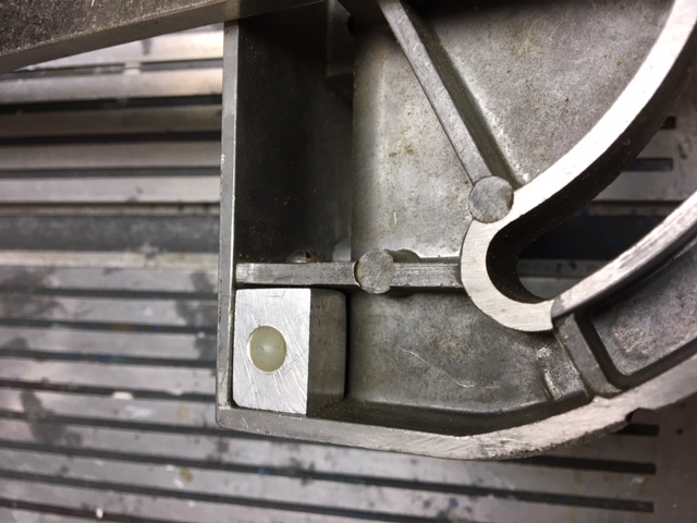

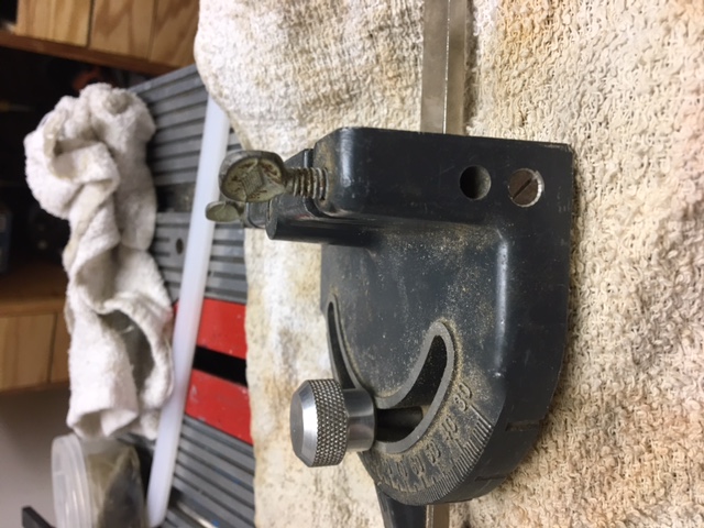

In case anyone was wondering about the differences between a 10 Er, Mark V and a newer Mark V or 7, I attached a couple of pics of each. The hold downs on the older miter gages are removed (one is on my Incra 120 setup). The glides on the 10 ER are like new from c1947! Also, the 10ER came with a 3/4 bar and fits my 1964 Craftsman table saw.

- 10ER glides
- 10er guides.JPG (109.28 KiB) Viewed 3387 times
- Shows the removal point for a 10ER guide
- 10ER side view.JPG (128.76 KiB) Viewed 3385 times

Re: miter gage
The last picture there shows a screw that appears to tighten down against the glide, am I seeing this correctly?
Wouldn't that destroy the threads on the glide?
Thanks for the pictures.
Hobbyman2
Hobbyman2
Re: miter gage
That aluminum block with the glide and two screws that hold the block in place is an 'owner enhancement' as are the two thumbscrews.

Re: miter gage
Not so sure about that. Check the castings... 10Er on the left has no casting for the glide... BUT... I am certainly NOT an expert on 10ERsJPG wrote:That aluminum block with the glide and two screws that hold the block in place is an 'owner enhancement' as are the two thumbscrews.
- 10ER vs Mark V.JPG (116.93 KiB) Viewed 3347 times
Chris Neilan
Re: miter gage
Which is WHY the owner enhanced it(the 10er version) with the block etc..ChrisNeilan wrote:Not so sure about that. Check the castings... 10Er on the left has no casting for the glide... BUT... I am certainly NOT an expert on 10ERsJPG wrote:That aluminum block with the glide and two screws that hold the block in place is an 'owner enhancement' as are the two thumbscrews.

Re: miter gage
So, how was the 10ER gage originally set up? Did it have glides?
