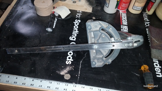

Maybe a picture of the gauge would help to identify it. They haven't changed much except for the bar for the newer tables.
Re: miter gage
Does the miter bar fit snugly in the miter track? If it does, it is probably a Shopsmith Miter Gauge. I know there are at least two models.

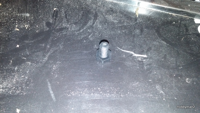

Here are the pictures of the gage and the replacement part they sent.

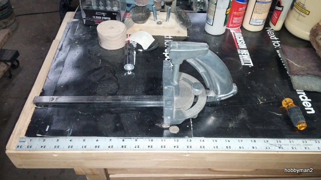

Post by Hobbyman2 »
I have the hold down off do to using a jig .

Hobbyman2, I am looking at the miter guage that came with my MK5 500 that I bought new in the early 1990's. It looks just like yours. Mine has two nylon like hex head bolts with a screw driver slot; the bolts are on each end of the miter base. I took one off, and it measures a total of about 3/4" with the thread lenght being about 1/2" Looks like it is for smooth gliding on the table and stabilization.
Re: miter gage
Yes there are two type of guides and they are quite different. I have the old parts listing so I will look up the part number and post here.
There are several other parts changes and some of those parts for the old version can not be gotten through shopsmith. I hope those screws are not one of them as I have several of the old models.
The guide change occur about the time they made the ribbed table for the 510, the smaller guides could catch on the ribs at certain angle adjustments.
