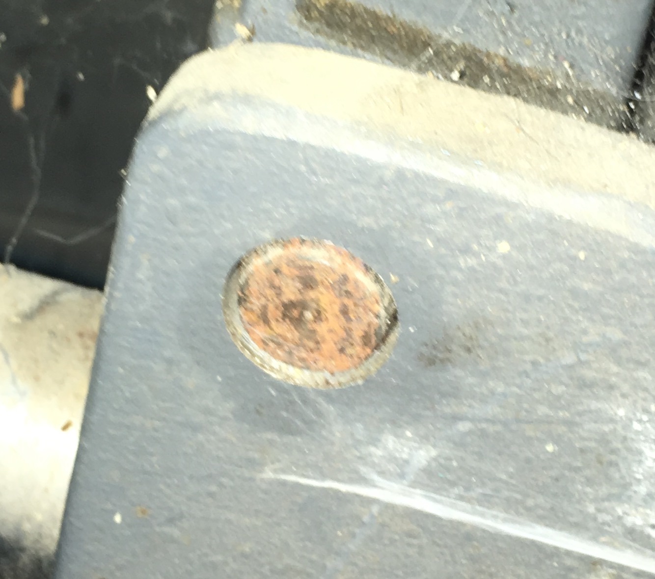

Back Home. Tried the rubber hammer again, Up and down; no movement. Sprayed move JB. Tried a little pressure with a Bottle jack and no movement. I'm thinking I am going to have disassemble the thing and press out from the bottom. Does anybody know what holds this pin in place? Does it just drift out?
- IMG_2064.JPG (272.85 KiB) Viewed 3788 times
Re: Tailstock stuck in MK V
Yes IF you first remove the tension pin that retains it. The pin is removed by driving it INTO the base. There is an exit hole inside the base(it will drop out onto the floor).carpfisher wrote:Back Home. Tried the rubber hammer again, Up and down; no movement. Sprayed move JB. Tried a little pressure with a Bottle jack and no movement. I'm thinking I am going to have disassemble the thing and press out from the bottom. Does anybody know what holds this pin in place? Does it just drift out?
The pin may be on either the front or back of the side facing the headstock.

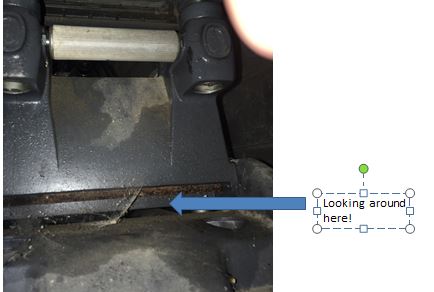

I assume by tension pin you mean a roll Pin? I don't see it or where it could be.
