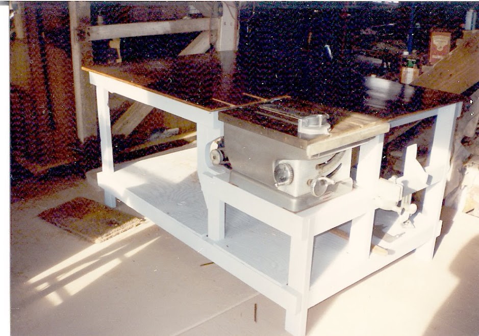

Before my Ridgid TS-3650 years ago this was my answer for limitations of my SS 510. I used it mostly for cutting sheet goods and for tilt arbor applications. Its 3/4 HP motor did tend to be a little under powered for stuff like ripping 2" oak etc. I Finally I got around to running a 220 volt line over to it and switching the motor over. Problem gone.
I still have that saw and table and may actually put in the woodshop after I get some more stuff moved out, mostly to the "other" part of the basement. I'll move the stuff then decide. I did like using it. It also made a decent assembly table. The top is 4' x 6'.
WS - Big table for bench saw .jpg (159.8 KiB) Viewed 10491 times

Interesting set-up, robinson.
