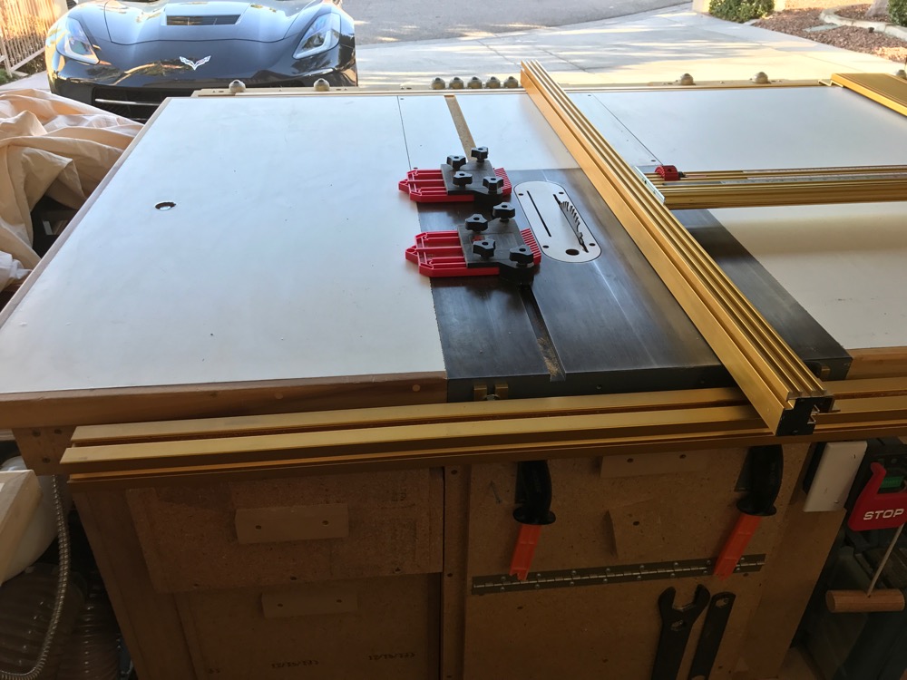

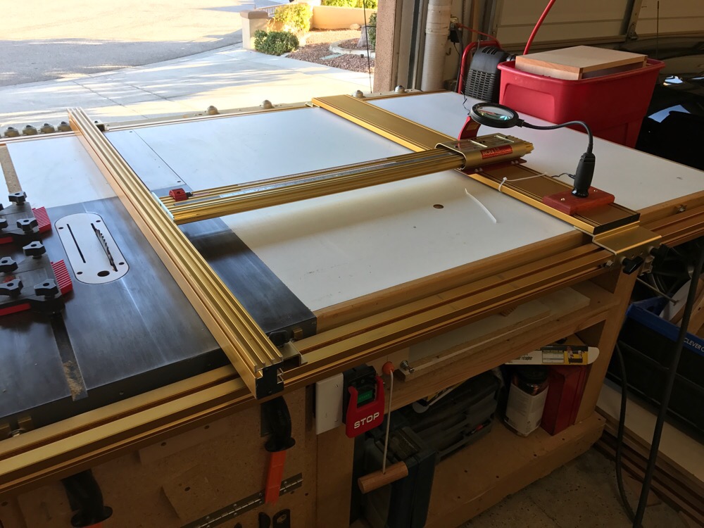

Here's a thought for you to consider. I was given an older Delta 10 inch contractors saw years ago and decided to use it to make a cabinet saw. The results were a great saw for very little money. I have added a larger motor and better fence system over time and it continues to perform even better. I originally made the entire saw out of four sheets of particle board and one sheet of melamine with the intention that if the idea worked I would remake it out of better material. Trouble is it works great and the particle board has held up very well. I cut all the pieces on the saw before I tore it apart. The legs are four pieces thick particle board and the frame is made of two piece thick members. It weighs a lot which makes it very stable but also has a caster system under it and is very easily moved. If you are interested I can elaborate more on the construction.

I would be interested in the construction even if no one else is. I do not have a saw but am still interested as a possibility in the future and as an assembly area.masonsailor2 wrote:Here's a thought for you to consider. I was given an older Delta 10 inch contractors saw years ago and decided to use it to make a cabinet saw. The results were a great saw for very little money. I have added a larger motor and better fence system over time and it continues to perform even better. I originally made the entire saw out of four sheets of particle board and one sheet of melamine with the intention that if the idea worked I would remake it out of better material. Trouble is it works great and the particle board has held up very well. I cut all the pieces on the saw before I tore it apart. The legs are four pieces thick particle board and the frame is made of two piece thick members. It weighs a lot which makes it very stable but also has a caster system under it and is very easily moved. If you are interested I can elaborate more on the construction.

Thank you, Paul. That is an excellent looking build you made. I would love to do that; however, space will not allow for it. Curious as to what motor you have on there now, and whether the saw is any more accurate due to the extra weight.masonsailor2 wrote:Here's a thought for you to consider. I was given an older Delta 10 inch contractors saw years ago and decided to use it to make a cabinet saw. The results were a great saw for very little money. I have added a larger motor and better fence system over time and it continues to perform even better. ... If you are interested I can elaborate more on the construction.

I noticed the large magnifying glass and the open garage door.
If direct sunlight makes it through the door, the magnifying glass could become a fire starter. Good idea to keep it 'covered'.
