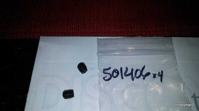

Hobbyman2 wrote:Just for heads up,,, the replacement slotted glides i bought from SS are now black ,,, no longer white.
'Early' headless ones?
Yea , the part number is on the bag ,,the x4 is not part of the number I ordered 4

I am wondering if the last guy didn't tighten a set screw down on the glides ,,mash out the threads and ruin the adjustment slot.
The new ones work like they are supposed to.
