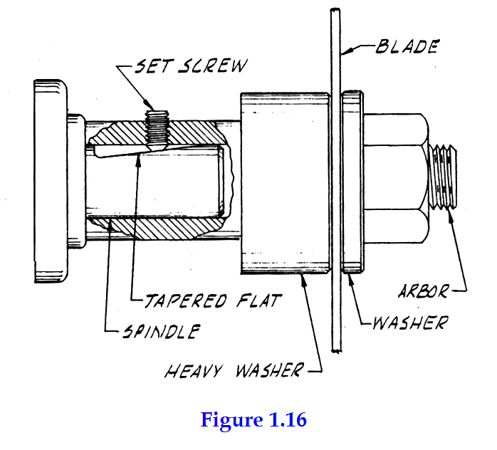

That is what the 10E/10ER's came with.
See Figure 1.16 which comes from the restored 1953 Power Tool Woodworking for Everyone book that I posted earlier this week:
Everett
Figure 1.16.png (87.54 KiB) Viewed 12883 times

chapmanruss wrote:90 degrees on both the horizontal and vertical axis, of course. :)
90° to the taper angle on the shaft? :rolleyes: :D ;)
Posts: 6585
Re: Arbors
No, as you know. :) The set screw in 10ER arbors are all 90° to the arbor as are many early MK 5/V arbors. Some here believe this is a real problem. Not so IMO. We have been using 10ER's for 70 years with no problems.
Re: Arbors
jsburger wrote:
Which was sorta my point. That drawing clearly shows a non-skewed set screw. I believe it also shows a set screw smaller than 5/16".
Posts: 6585
Re: Arbors
JPG wrote:
jsburger wrote:
That is what I thought. :) Yes it is a smaller set screw. I can check the size tomorrow if you want but, not tonight.
Re: Arbors
jsburger wrote:
JPG wrote:
1/4 - 28 ? ;)
