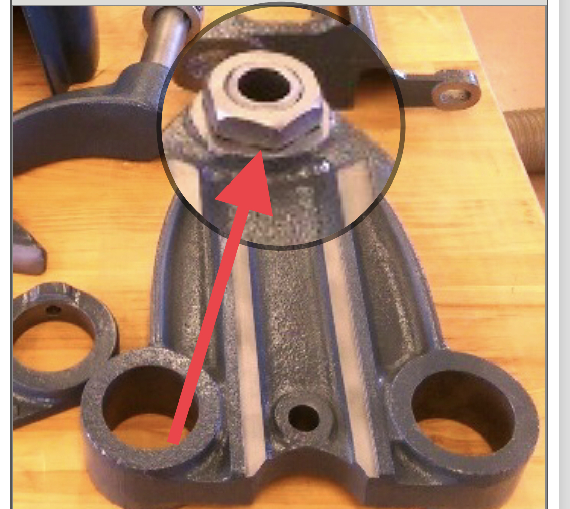

I’m in the process of revitalizing my father’s old 10er.
I remember him turning spindles on it as a kid.
But when reassembling the machine, it is missing the tailstock insert.
From reading these forums I understand that it is a Morse 2 taper insert.
See the attached pictures which I copied from this morning were very helpful.
Does anyone know where I can buy a replacement tailstock insert for a 10er?
rpd
Posts: 3045
Location: Victoria, B.C.
Re: Morse taper insert for tailstock 10er
Post by rpd »
Bartojj wrote:8E4F67DB-14B9-481F-A8E9-274DAA829C9B.jpegI’m in the process of revitalizing my father’s old 10er.
try MKCtools, http://www.mkctools.com/10erparts.htm
or HogWinslow. https://sites.google.com/site/hogwinslowwoodworking/
They both have parts not listed on their web pages so may be able to help you.
rpd
Posts: 3045
Re: Newb diving in
Post by rpd »
Oh, and MKCtools has the specs so you can make one or have one made. I knew I had seen it somewhere, just took some time to find it.
http://www.mkctools.com/10erfloatingcentersub.htm

Re: Newb diving in
More simply, just order a new one from The mother ship. The current one fits.
rpd
Posts: 3045
Re: Newb diving in
Post by rpd »
JPG wrote:More simply, just order a new one from The mother ship. The current one fits.
But the Mother Ship doesn't stock 10ER specific parts. :rolleyes: ;) :)
Re: Newb diving in
BUT the tailstock has not changed since then.
So that pix misled me. He needs that thing circled in the pix, not the tailstock center that inserts into it.
I think a simple way to get one is to find one on a 10ER tailstock from E-Bay.
