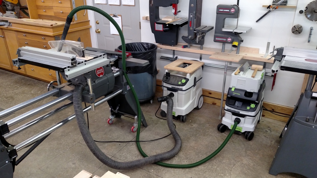

How are you attaching the Festool CT26 to your shopsmith tools?
Are you using the 36mm hose or an even larger hose?
Cheers,
John[/quote]
I use the regular 2.5" shopvac hose for the bottom blade guard. For now I am using a 27MM hose on the second unit to my homemade upper blade guard. It works pretty well but the Shark Guard that I have ordered will have a 2.5" dust port. I may reduce it down and use a 36MM hose on it but that decision will have to wait until I receive the unit and play around with it.

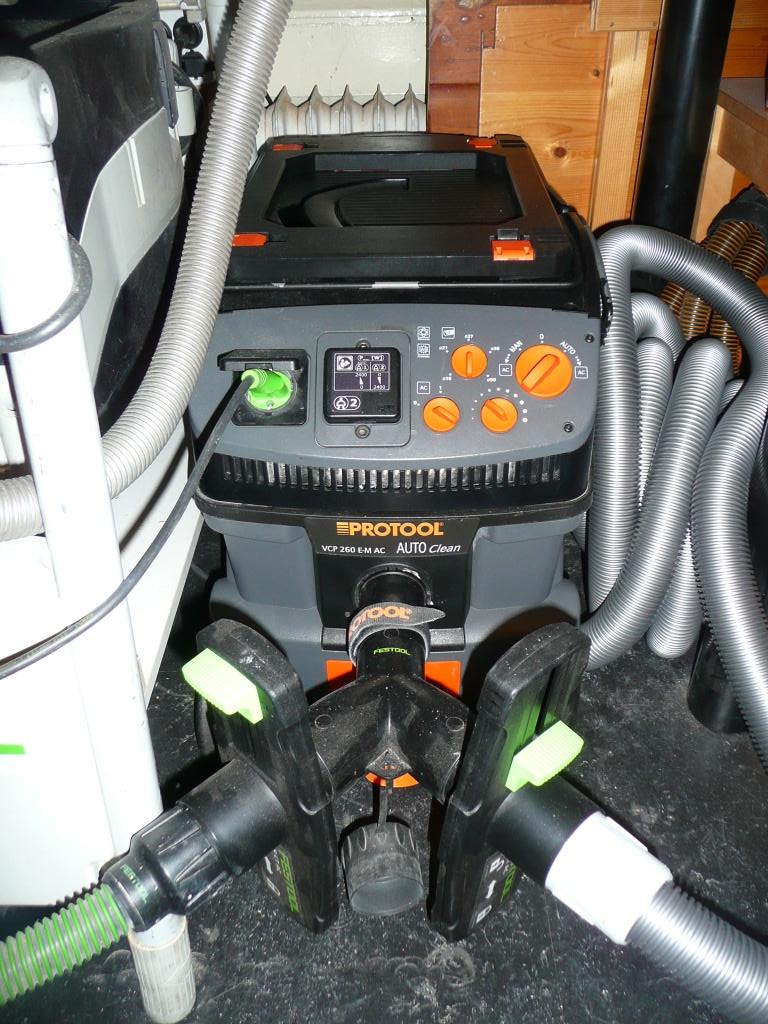

I would like to have these Festool blast gates but at $62.00 each they are insanely over priced. :rolleyes:
