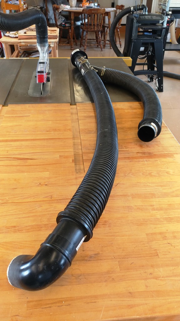

If you look at all the dust collectors of that style with 1 1/2HP motors with a few exceptions they all look the same. Like they were all made in the same factory regardless of brand. They all have a 1200-1300 CFM rating. That is the important number. So if one comes with only one 4" inlet then just put a 4" Y on it and you have two inlets.
When I had my JDS Dust Force I only used one port for the SS with the Shark Guard. The long branch with the elbow went to the Shark Guard and the short branch went to the lower saw guard. Then there was a 4" line to the JDS.
