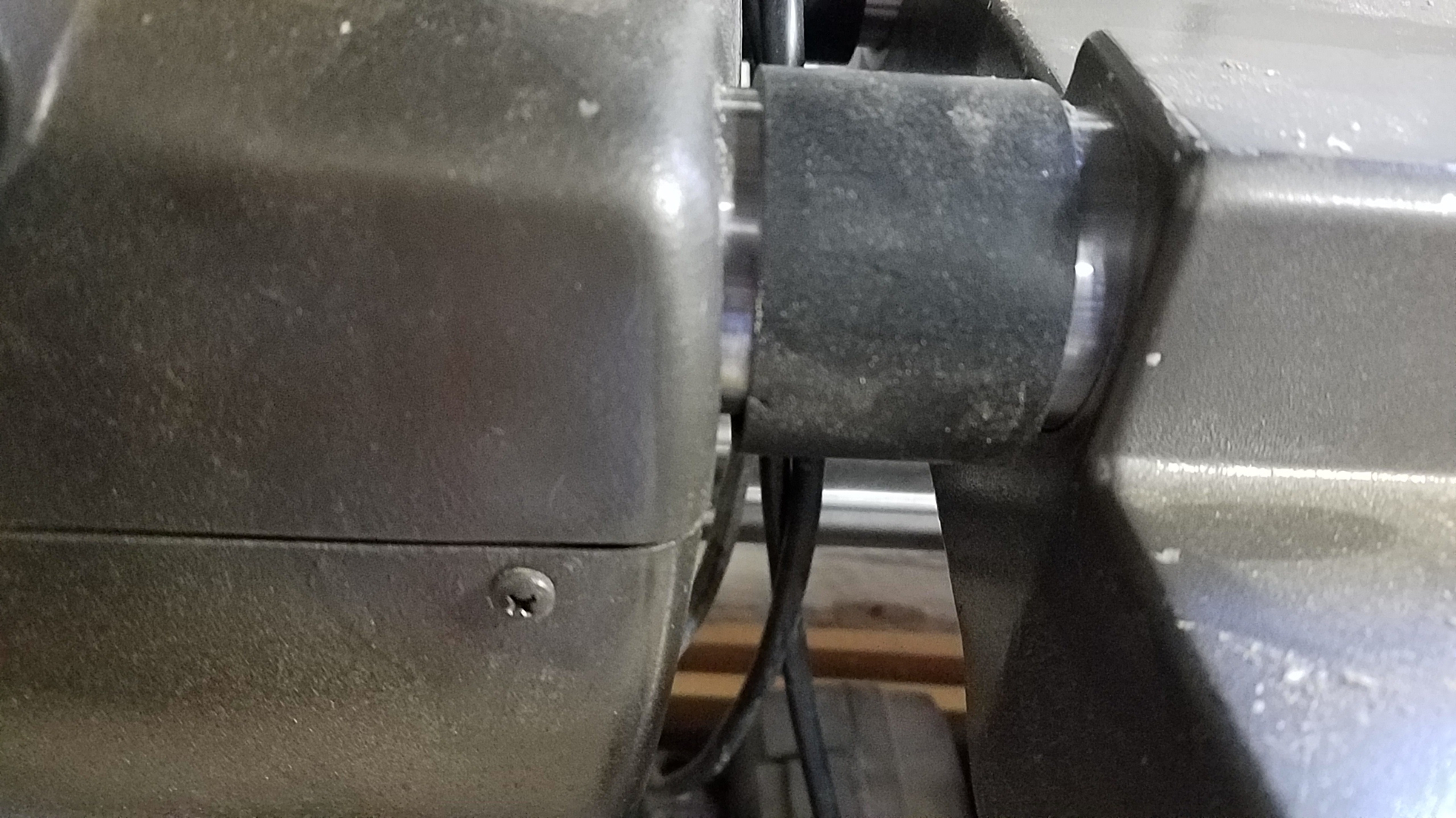

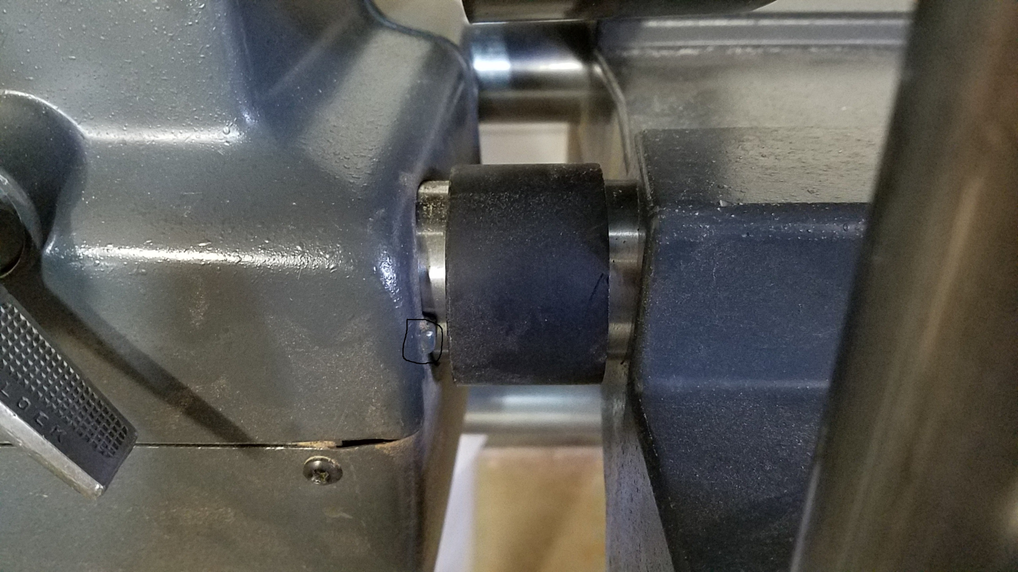

dynabase wrote:Shopsmith list several part numbers for rubber bumpers (517135, 517113, 516667). Does anyone have the part number for the 1 3/8 bumper. If I can get one of those I think my blade will finally center. I have the 1 7/16 bumper now and I'm still a little off of center. (Of course many people that know me will attest that I have always been a little off center.)
Michael
Yes, there are different rubber bumpers. Which one is the right one? I don't know and the Shopsmith documentarion does not tell me. But why are there different bumpers? Masybe because there are different headstocks and maybe even carriages.
Does this little nib (which does not exist on all headstocks) affect spacing? Absolutely. But which one goes where?
Bumper 00.jpg (1.71 MiB) Viewed 3639 times
What-No Bumper.jpg (1.49 MiB) Viewed 3639 times
