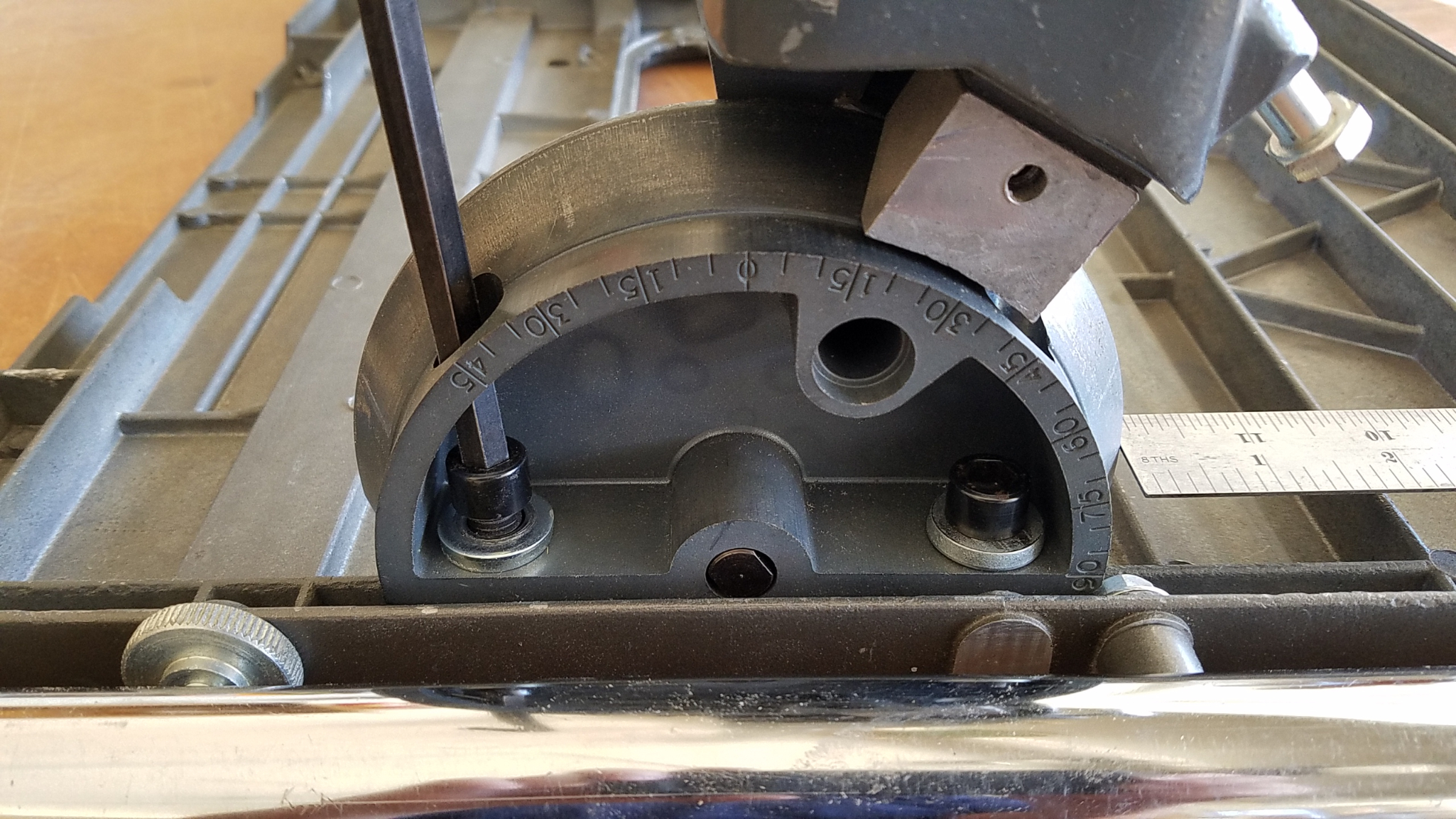

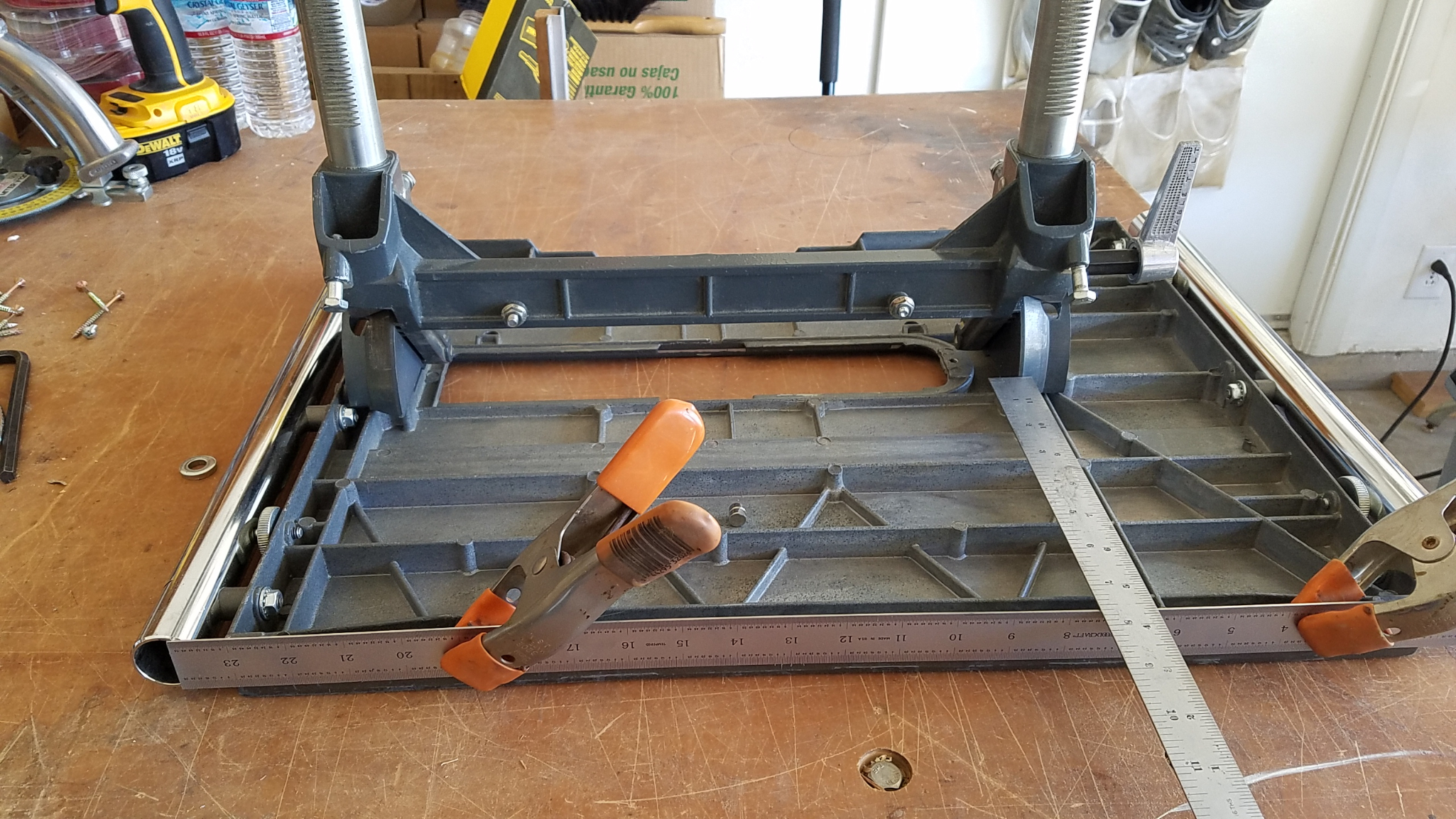

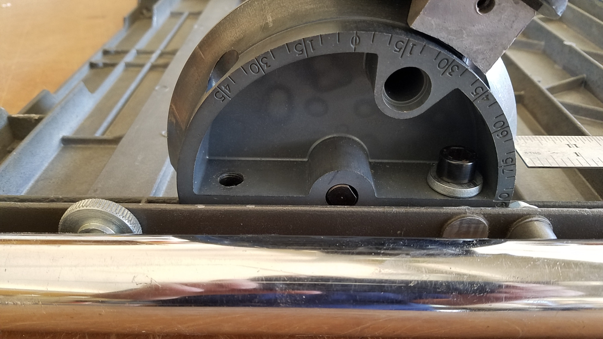

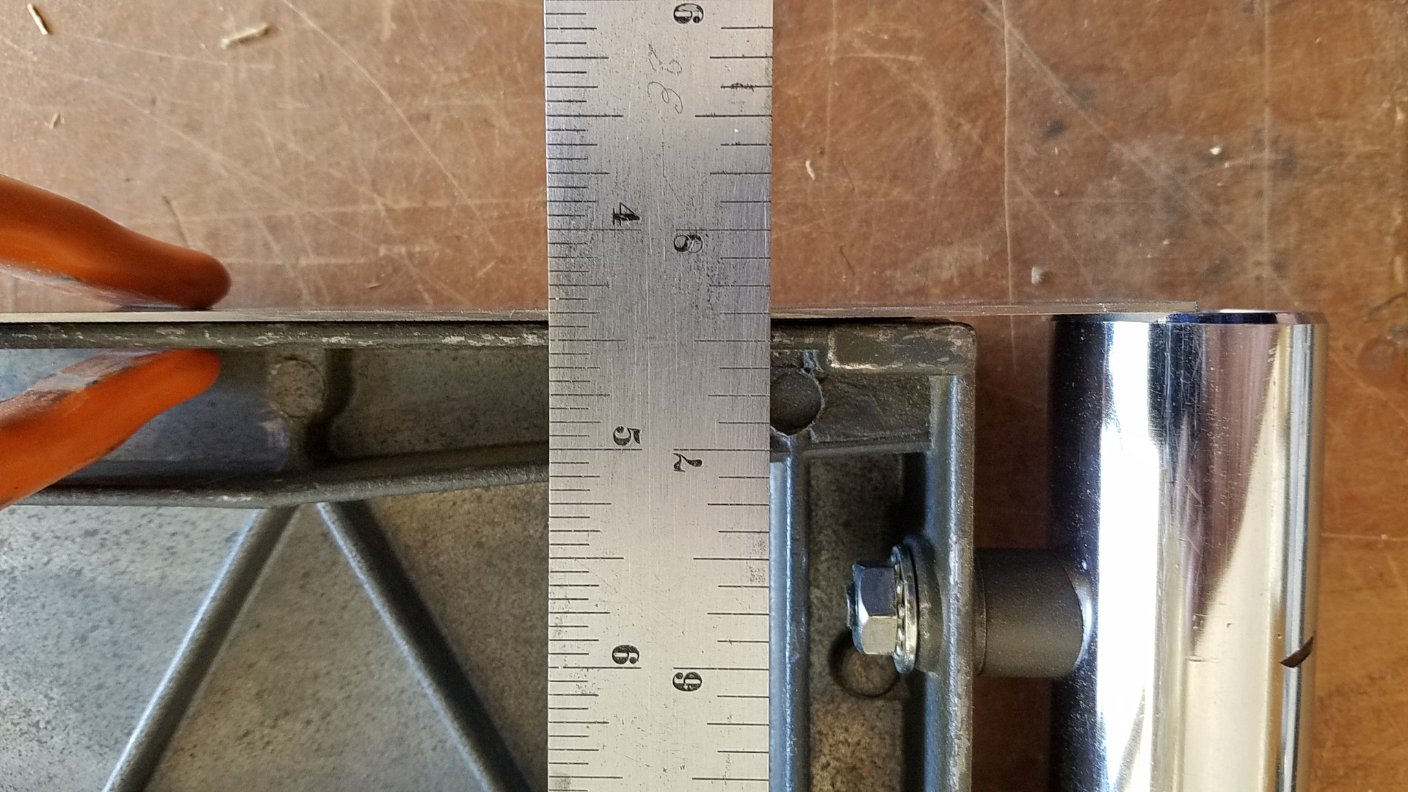

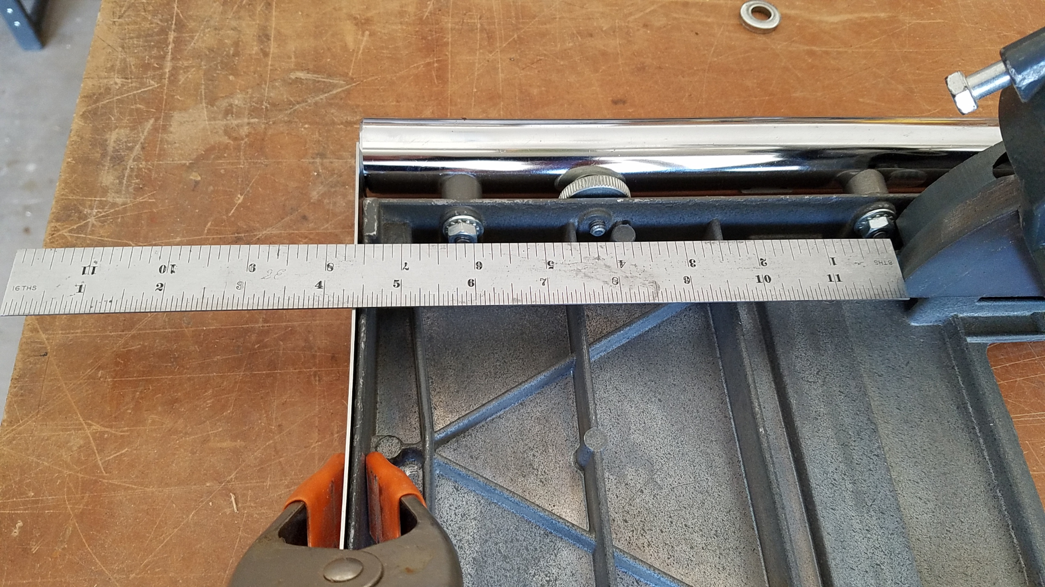

Problem solved! At least one of them. I located a trunnion with original size holes (3/8"). I can now check for alignment with no holes enlarged in either trunnion.
In the meantime, however, I installed the trunnion I got from dynabus. I installed it with only the left rear bolt installed. This creates a pivot point with virtually not lateral movement.
I then measured from the edge of that trunnion to the edge of the table. It measured 7 5/8". I then moved to the other trunnion and made that same measurement. It was something different so I moved the trunnion until the measurement was 7 5/8". My expectation is that when I install this table on a Mark V and measure squareness to the blade that it will be very close to square and nearly centered in the cutout.
I tightened the three bolts and double checked the measurements. I then installed the fourth bolt. It screwed right in with no difficulty. Because of the way I got to this point, I was not sure that the bolt would align to the hole. These five pictures depict what I have done so far.

Just as I had hoped.
Later pictures will show just how well it aligned to the blade. It is NOT within my normal target range of .005" and it is not centered but it is close enough to SAFELY used the table saw without further adjustment.

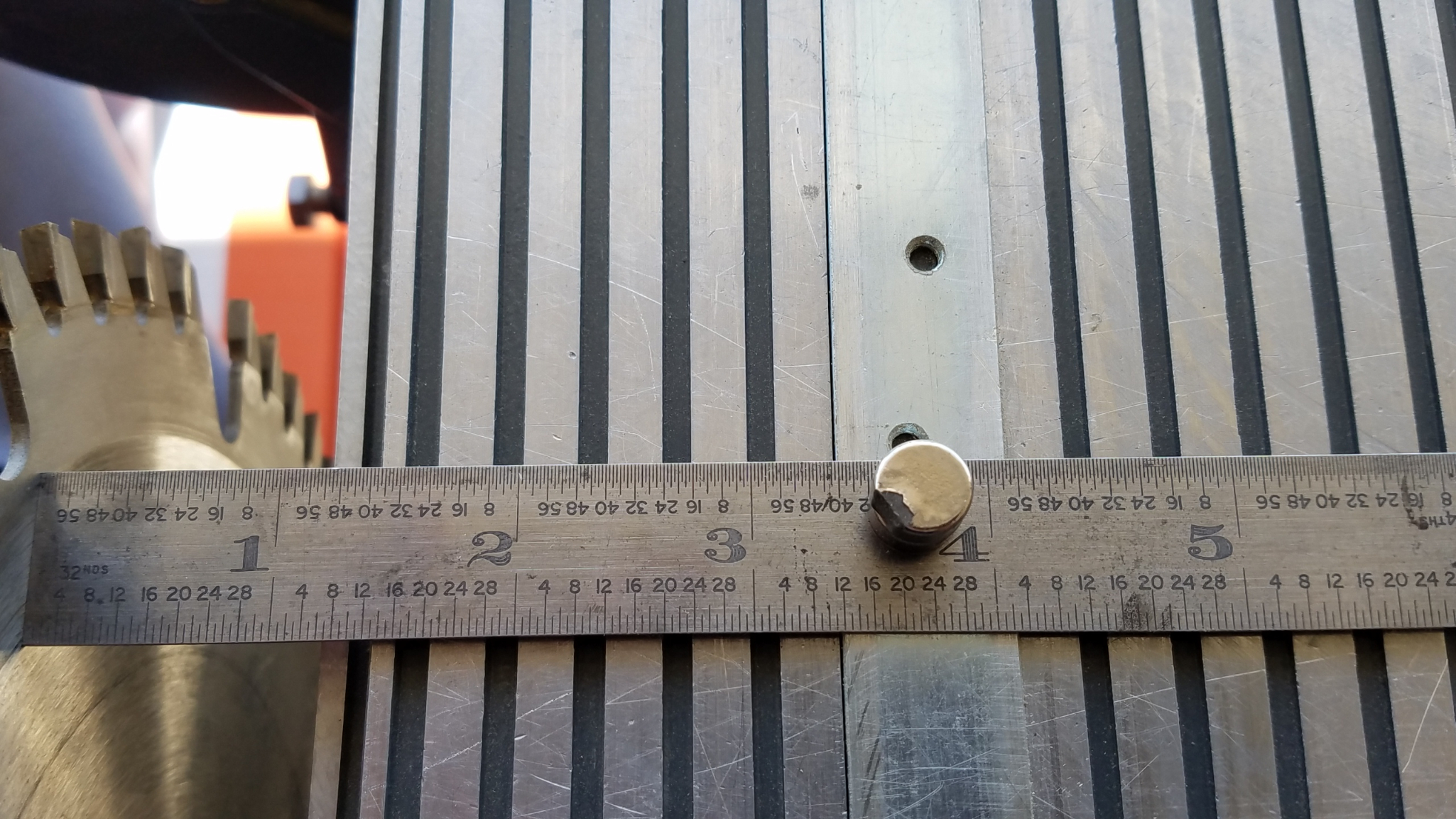

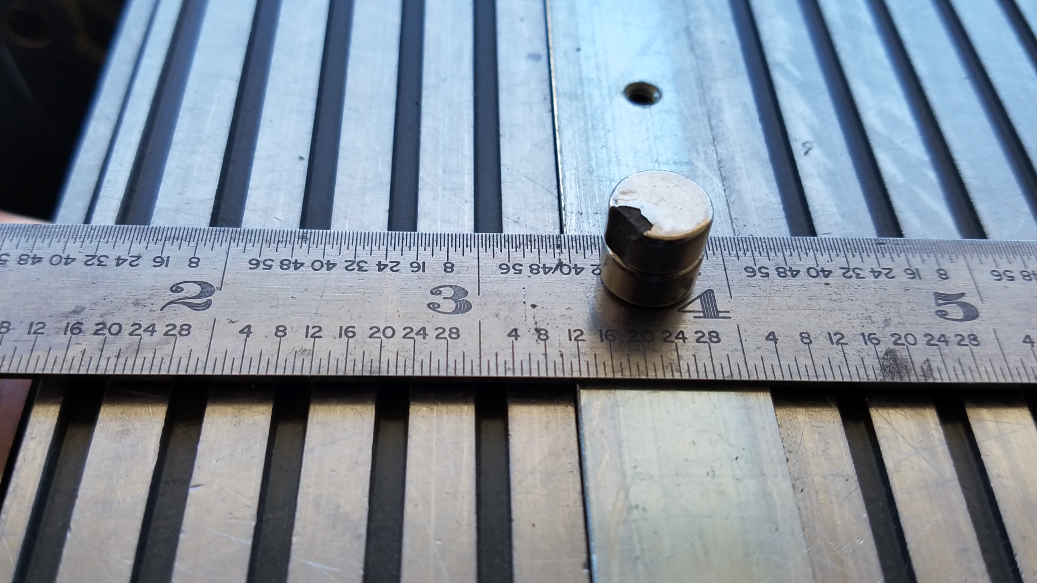

The images that I have do not tell the story accurately because of camera angle and sun glare but I will get others before I change this setup. Here is what I have showing that the right hand face of the blade is 3 3/8" from the near edge of the right hand miter track.
Undrilled Trunnion 018.jpg (1.75 MiB) Viewed 7828 times
Undrilled Trunnion 019.jpg (1.7 MiB) Viewed 7828 times
This basically places the left face of the blade very near center of the cutout.

For those interested, the naysayers included, the method for table alignment described above works BUT only if you are willing to accept precision to within 1/64". Aligning this way does not provide for tweaking to precisely center the blade but it does square the blade.
While playing with this, I equipped a table with two trunnions that had not been redrilled (all four holes = 3/8"). Installed this way there is no opportunity for changing alignment. You get whet you get. The span from the left face of the blade to the left edge of the left miter track is 4 17/64".
This places the left face of the blade 1/64" to the right of the centerline on the table cutout. My rubber bumper is 1 3/8" wide. The quill is fully retracted. All locks are secure. The table tilt is square to the blade. I am using a standard Shopsmith Table Saw arbor on a blade with a 1 1/4" bore.
I did this on two different table systems but on the same carriage.
That's my story and I am sticking with it.
