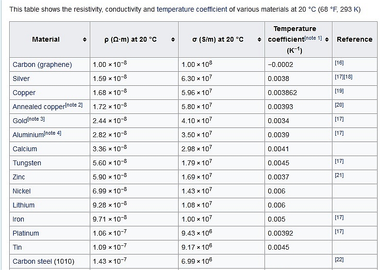

Re: Electrical Advice
jsburger wrote: No, silver is a very efficient conductor of electricity. Much better than copper. Gold is even better. Gold does not oxidize and silver oxide is somewhat conductive. That is why the wire and connectors are used. All the strands of the wire are silver plated.
Nope!
conductivity - resistance.jpg (248.63 KiB) Viewed 4391 times

JPG I think maybe when you figure in the cost and all the variables in the different resistance listed ,, maybe silver just fits the bill ?
Interesting info,, thanks again
Actually it is copper that 'fits the bill' for economical reasons.
