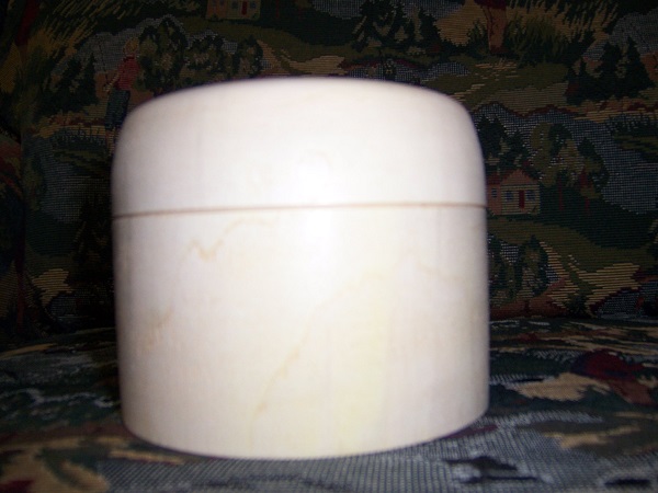

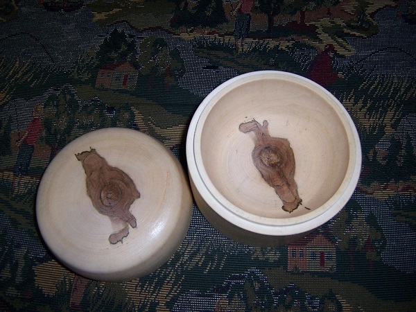

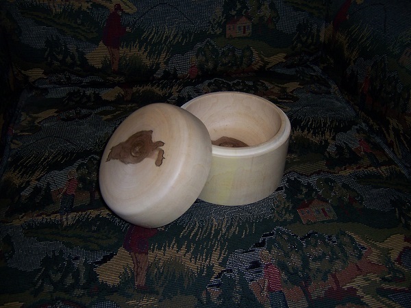

Turned a vessel (box) today out of some relatively wet maple on the ER. Not the best turning but just seeing what I can do with my ER. Very little sanding involved (it shows). Lid opens with suction. Don't know how long it will do so due to the wet wood that I anticipate will stretch across.
I like practicing on free wood. :D
Not the best photos either; but, here they are.
