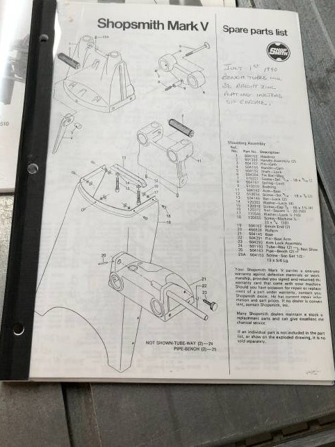

I have a copy of a Spare Parts List done by Shopsmith Inc. that includes changes made to the Mark V over the years to guide the user to the correct current parts that are needed to replace older parts. It is plastic bound and starts with 10 pages of parts lists with some hand written notes on the printed and typed pages dating as late as 1990. This is the most interesting section historically. Next it includes the Mark V Models 500 and 510 Maintenance and Troubleshooting Manual section pages E-1 to E-34 followed by 55 pages of How to do different individual replacements and repairs. Of interest here, on page 6 in the paragraph about the change from the Gilmer to Poly "V" drive. It reads as follows -
11. During the changeover from the gilmer drive to the poly "V" drive (see item #1), they provided a special quill. These units are identified with the letter "C" after the serial number. If a replacement quill is required and your serial number has this designation, please contact us direct for instructions.
Apparently there is something different about the drive sleeve and/or the spindle in the quill for these first poly "V" units
I have not seen a Mark 5 with a "C" after the serial number, has anyone seen it?

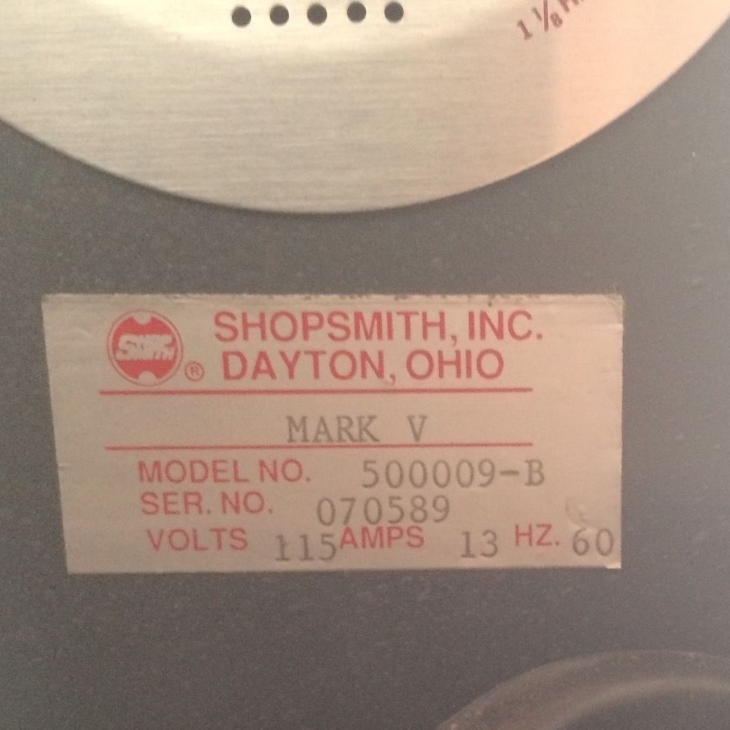

The term Mark V-B is not from the history, it is the model on the vent/serial number plate. Kind of like going from the 4" Jointer Model 620 to 620-C in the late 1950's. I have not seen any reference to what is was a designation for.

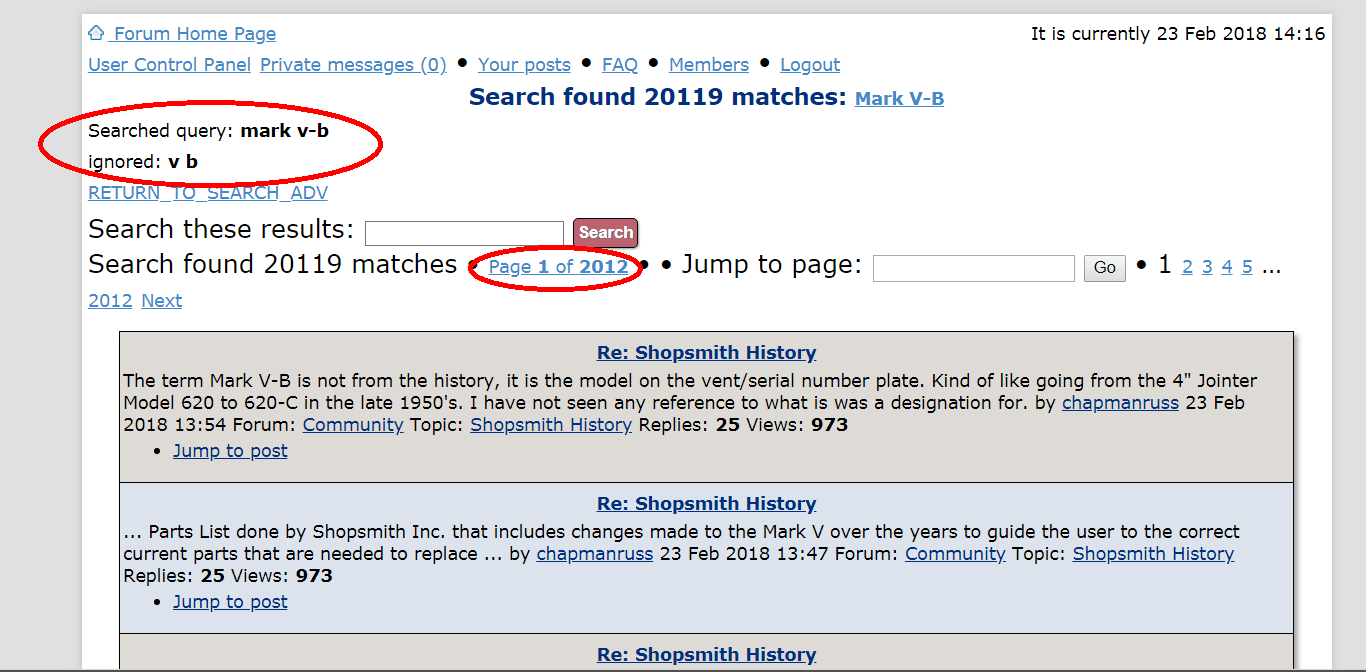

Here is a thread post discussing the fact that folks had been talking about theirs - http://www.shopsmith.com/ss_forum/viewt ... 13#p111213
Titled - What else .... "Mark V-B" posted 21 Feb 2012....
Interesting Shopsmith Forum Search results.... I searched for exactly the name of the thread 'Mark V-B' You guessed it, Shopsmith Forum Search found 2,012 pages of matches, none of which was the thread itself.
Why? They chose to ignore v and b (see screen shot)
Everett
Everett

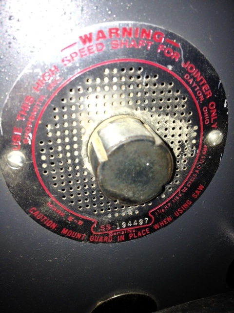

I also found that Ed wrote in post http://www.shopsmith.com/ss_forum/viewt ... 55#p111255 relative to that V-B vent plate discusssion:
"I have 3 machines I can look at, so if this data is helpful in find what machines do NOT have a "B"
1976 plate says MARK 5 and uses Vandaila OH as the location
1980 plate says MARK V and uses Vandaila OH as the location
1991 plate says MARK V and uses Dayton OH as the location
The tool history has a serial number 190000 as the beginning of the 2-bearing quill, as of 10/1984. That is close to your date.
Ed"
That date range certainly takes my thought of Mark V-C coinciding with the C headstock out of the discussion.
This was in discussion relative to SS 194497 which was a Mark V-B owned by Culprit posted 21 Feb 2012.
Everett

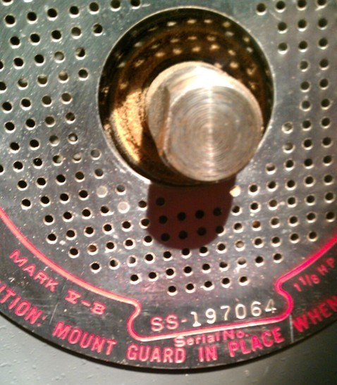

Re: Shopsmith History
It was still in use on SS 197064 - Early 1985 -
Everett

Looking through the pictures I have of Mark V/5 Vent/Serial Number Plates some things become evident. The Serial Number/Model Number stickers started with date coding. The stickers were moved away from the vent plate about 2002 to the side of the belt cover below the warning sticker. On machines with the sticker above the vent plate, adding the Hub guard will cover it. The Mark V-B designation appears to have ended with the introduction of the 510/505 Table system and calling the original the 500. The stickers include a number of different 6 digit Model Numbers (like 555861 - mine) and have different names above the Model and Serial Number lines. They include (for the ones I have pictures of),
MARK V
MARK V 510
Mark 510
MARK V 520 MODEL
MARK V 520 STATIC DISPLAY
MKV BASE UNIT
SOS Display Unit
STATIC DISPLAY UNIT
HEADSTOCK (SVC)
50TH ANNIVERSARY MKV - this is what is on mine date code 09-11-01
The picture below is a -B model number, don't know why.
MARK V
MARK V 510
Mark 510
MARK V 520 MODEL
MKV BASE UNIT
SOS Display Unit
STATIC DISPLAY UNIT
HEADSTOCK (SVC)
- 070589 Mark V Escondido CA_c.jpg (167.85 KiB) Viewed 11093 times
- Posts: 4533
I mentioned before the Spare Parts List booklet from Shopsmith and attached is the front page for reference.
