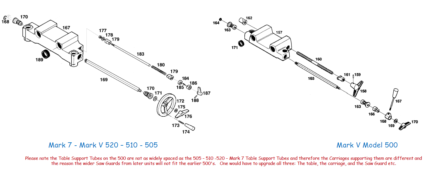

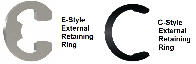

alohacnc wrote:Eclips won't work in that application. They don't do well in thrust loads. Either use a proper retaining ring.
https://www.mcmaster.com/#retaining-rings/=1c21icq
There is no rotating thrust load on the hand crank to raise the table, just a radial one as it rotates. The part numbers are identical through the years 1953 - to current. If you over tighten the lock, and the clip does not fit correctly or is thin, you might push it off.
Item 168 504259 Washer for model 505-510-520 and Mark 7
Item 164 504259 Washer for model 500
I spoke to Shopsmith who agree that the description washer on both was a hold over from the 1950's. Clearly it is not a washer. Mine are thick E-Clip Style Clips. At some point they may have been C-Clips.
They agreed to look into making a clarification in the parts description. I asked them to also consider putting size specifications in with it as it likely is locally available in many places.
I think E-Clip is somewhat of a misnomer, I think it truly is a E-Style External Retaining Ring.
Everett

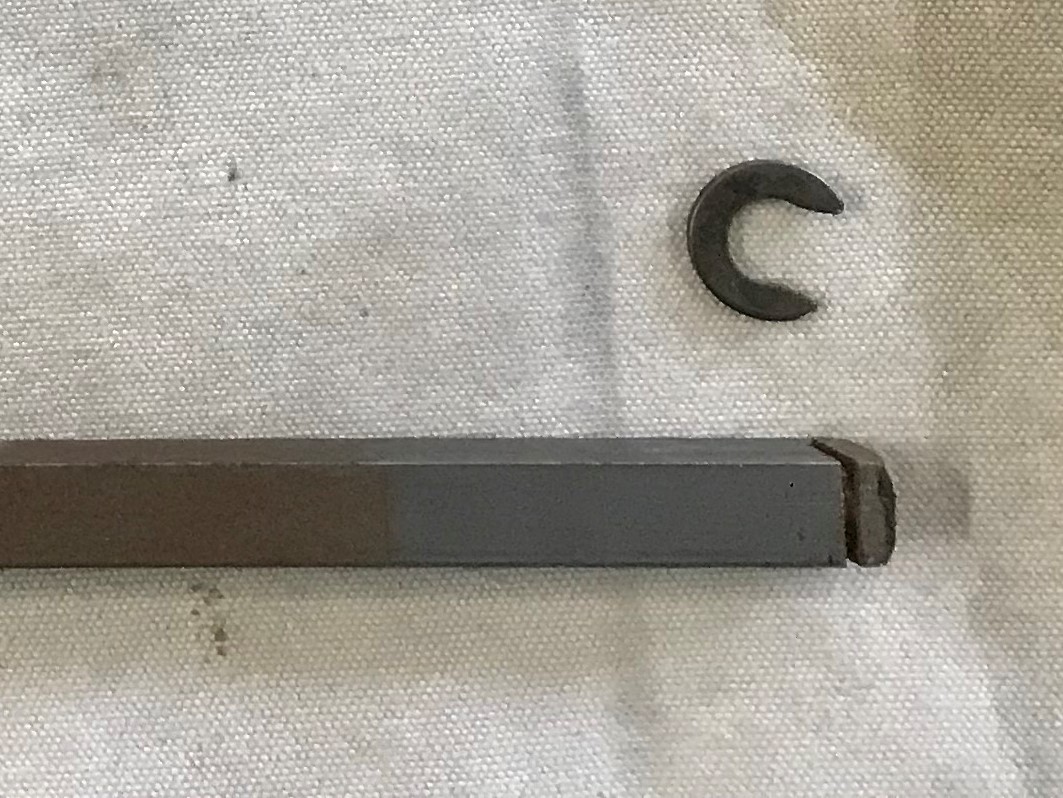

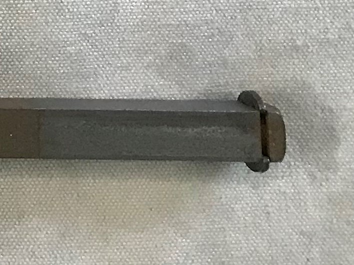

Here is the clip on the square rod for the 500 carriage. Note the clip is the thickness of the machined space in the square rod.
Here is the clip off the square rod for the 500 carriage. It is a heavy duty "C" style clip.
The clip goes directly against the Pinion Gear on the back side of the carriage - no washer. It is the same for the 505/510/520/M7 carriage except a longer square rod, different pinion gears and wheel assembly instead of a handle assembly. Hope this clears up what part is needed.
