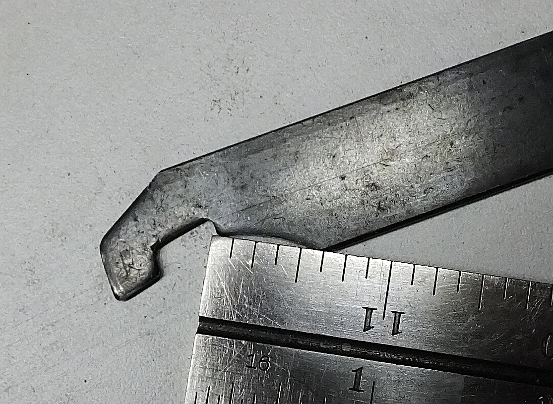

I think that since the 'current' gauge has the straight edge that it is a 'newer' gauge.
I will attempt to get a pix of my 'older' gauge.
Found one.
planer gauge arc.jpg (700.93 KiB) Viewed 4985 times
It came with my second hand planer which has the round height knob so it is an older version planer. I do not know it's age.

godavid2 wrote:Thanks russ, I marked my planner gauge 7/16" and the adjustments look good.
I hope this means that you have resolved your adjustment problem.
