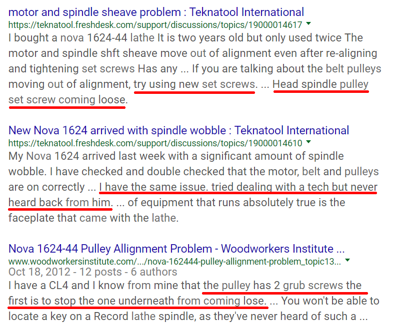

My bet is that his came loose and fell out. That is what happened to the fellow with the index/fan piece. His came out, but as it came loose, it scored the shaft making pulling it off difficult.
I am glad Dick found a solution for his.
Everyone likely knows that Teknatool builds the DVR Motor that Shopsmith and NOVA lathes use.
Seems Nova has some power-on issues, just like Shopsmith does Seems Nova has RPS1 Errors RPS0 Errors, Low Voltage Errors, Start/Stop Fault, and hmmn... rattling noises due to set screws that come out....
See: https://teknatool.freshdesk.com/support ... ed-readout
One of the most salient comments shows up in the snapshot of issues below where they state of all things..... that the technician didn't call them back.
Set Screws Coming out on Nova Gear made by Teknatool.png (87.12 KiB) Viewed 8587 times
Don't know how we can leverage pressure on Teknatool to support Shopsmith in supporting us... but that may be where the disconnect is.
I thought the Grub Screw being used as a back-up to prevent the first one from coming out was just something out of my past work experience, but it apparently is common knowledge of sorts at Teknatool that the 2nd set screw is a good idea....
Thoughts
Everett
