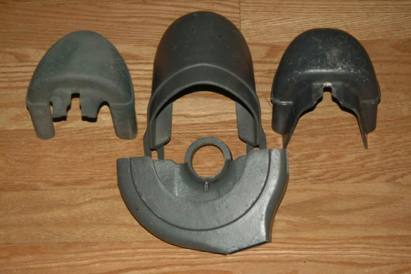

I have attached a scan of the page from Montgomery Ward 52-53 catalog that shows the guard. I have also attached a photo of a 10E / 10ER lower saw guard, and one of the early Mark V saw guard from that period. You can see the family resemblance before they moved to the round vacuum port.
You can also see the two versions of the 10E / 10ER upper belt guard and the elusive lower belt guard.

I am willing to pay a reasonable premium price for either the Model 10 lower saw guard or the motor pulley guard shown in the last picture. PM me if you have one you want to sell.everettdavis wrote:I understand there are a number of Mark 2's still out there and many can be restored to use.

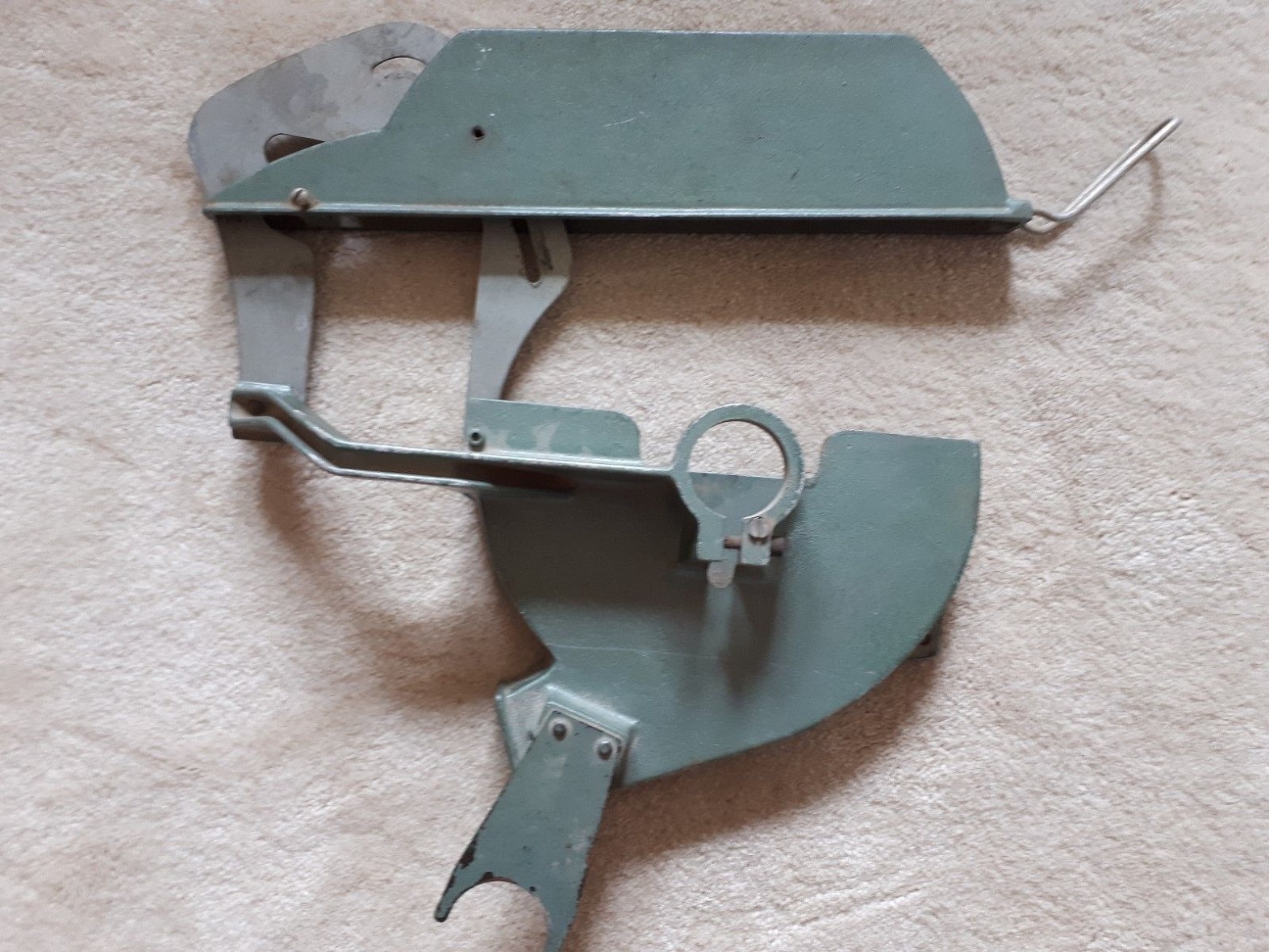

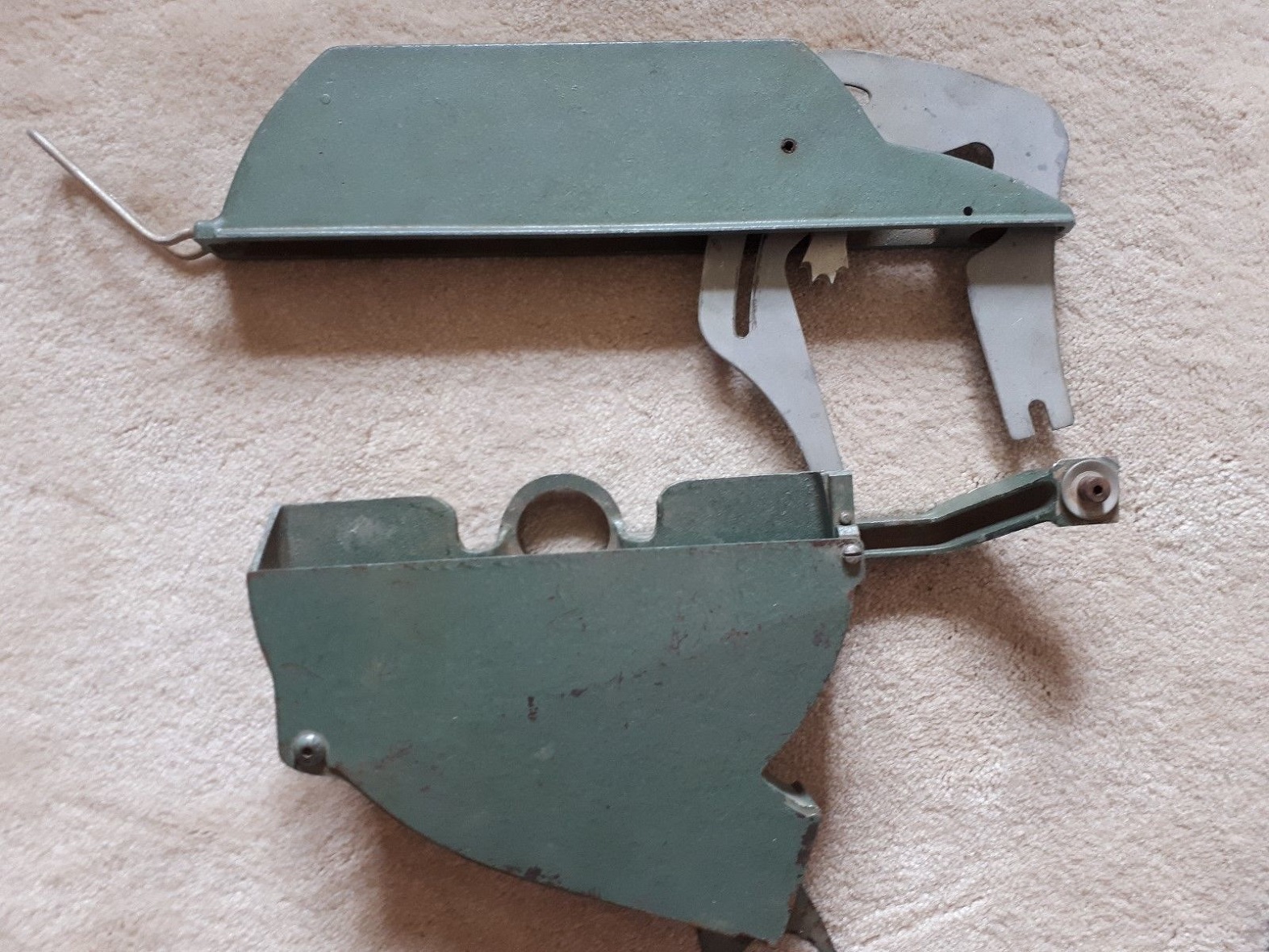

John those are not mine. I have even tried to locate someone who can help me me make a positive mold so I can have cast aluminum replicas made. They are scarce for certain. Not valuable, just scarce.
I haven’t made that connection yet.

I thought as much. I didn't word my post very well. It was supposed to be a general statement to anyone who had them.everettdavis wrote:John those are not mine. I have even tried to locate someone who can help me me make a positive mold so I can have cast aluminum replicas made. They are scarce for certain. Not valuable, just scarce.

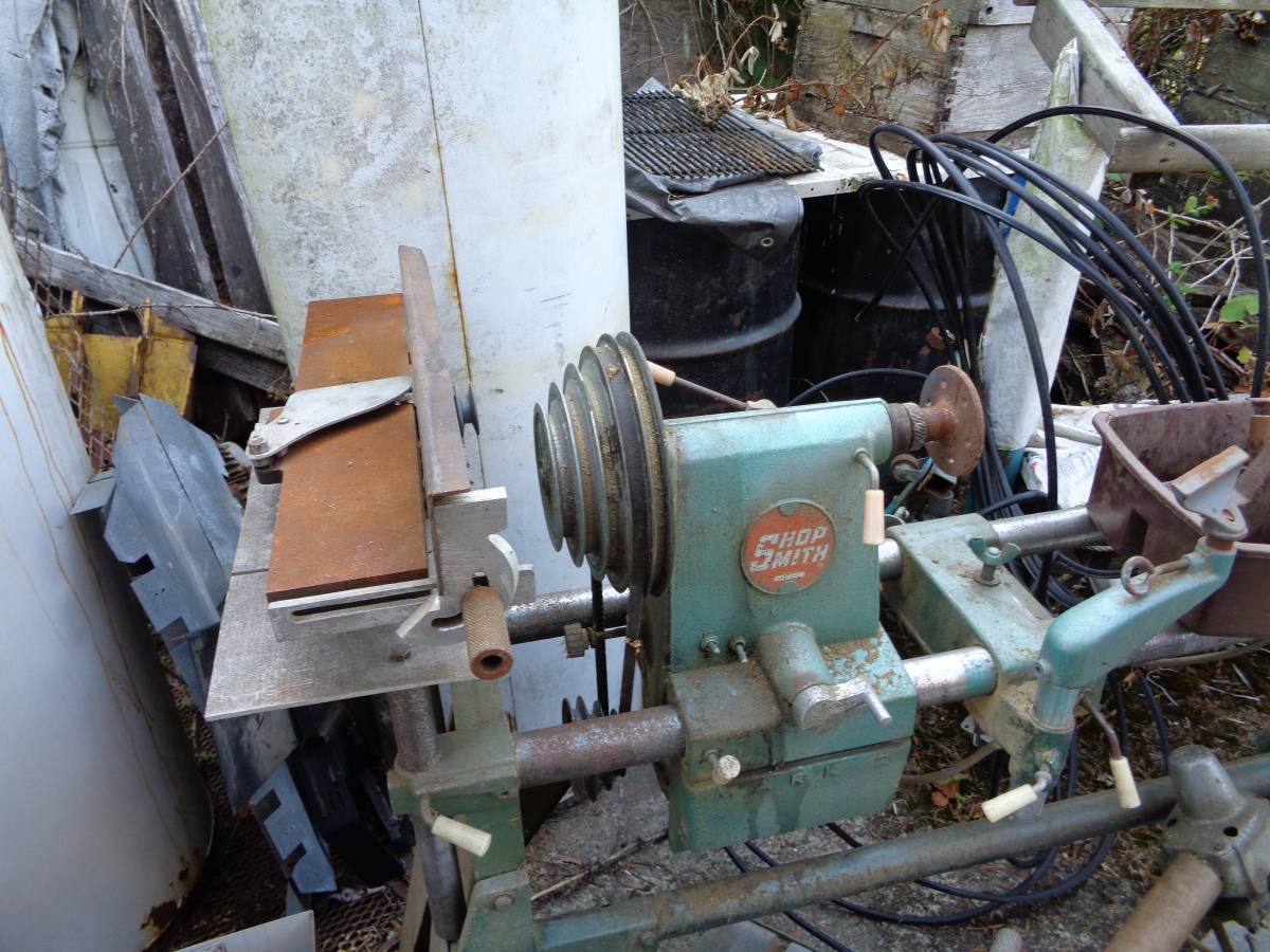

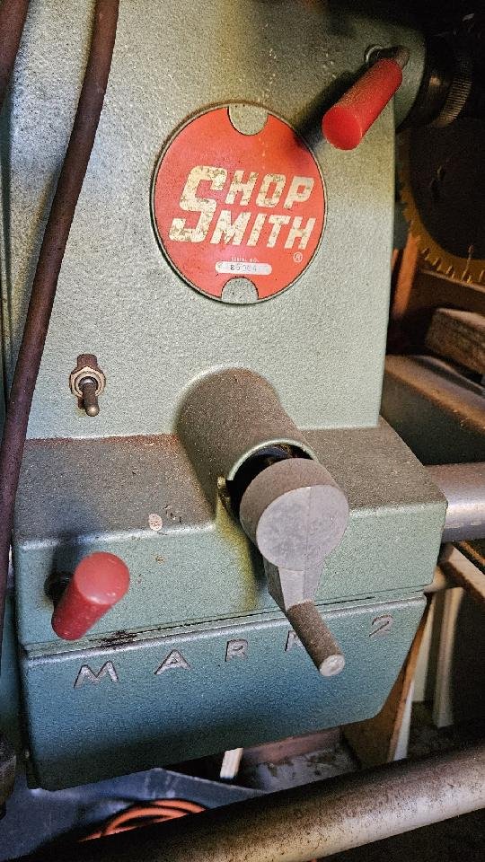

Hey team. I am doing research for my father-in-law's Mark 2. See pix. First question I have about parts is belts...can we still get them??

rsheffe,
The answer to your first question is yes. The Mark 2 uses a smaller width belt. The Drive V-Belt is a 34" long belt and a 3L not the more commonly used 4L Belt. I have found and purchased them for my Mark 2's. Look for a 3L340 size belt.
Your Father-in-laws Mark 2 looks to be in pretty good shape. I see it has the Belt cover which is often missing mostly because they end up broken. If I am reading it correctly it is serial number 85004.
