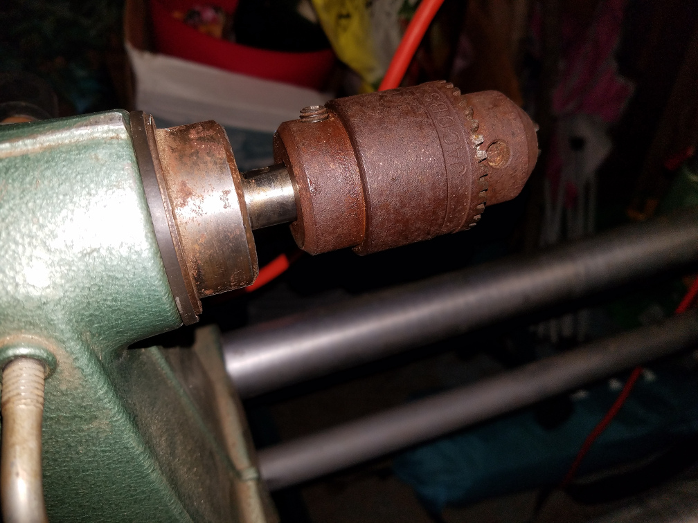

Thanks Bob. Here are some pictures of what I've got
- 20181002_175020.jpg (347.01 KiB) Viewed 58972 times
- 20181002_174952.jpg (309.5 KiB) Viewed 58972 times
- 20181002_175251.jpg (333.94 KiB) Viewed 58972 times

The saw function will need an arbor and a blade and a miter gauge(Mark 5/V version will work).
The lathe function will need a spur drive center, a tail center and a Mark 5/V tailstock. The Mark tailstock mount may be in a box of parts(not easily recognized). It mounts on the aux table which I cannot tell if you have. I recommend the Mark 5/V tailstock regardless.
The drill function will require some evsporust to clean up the chuck.

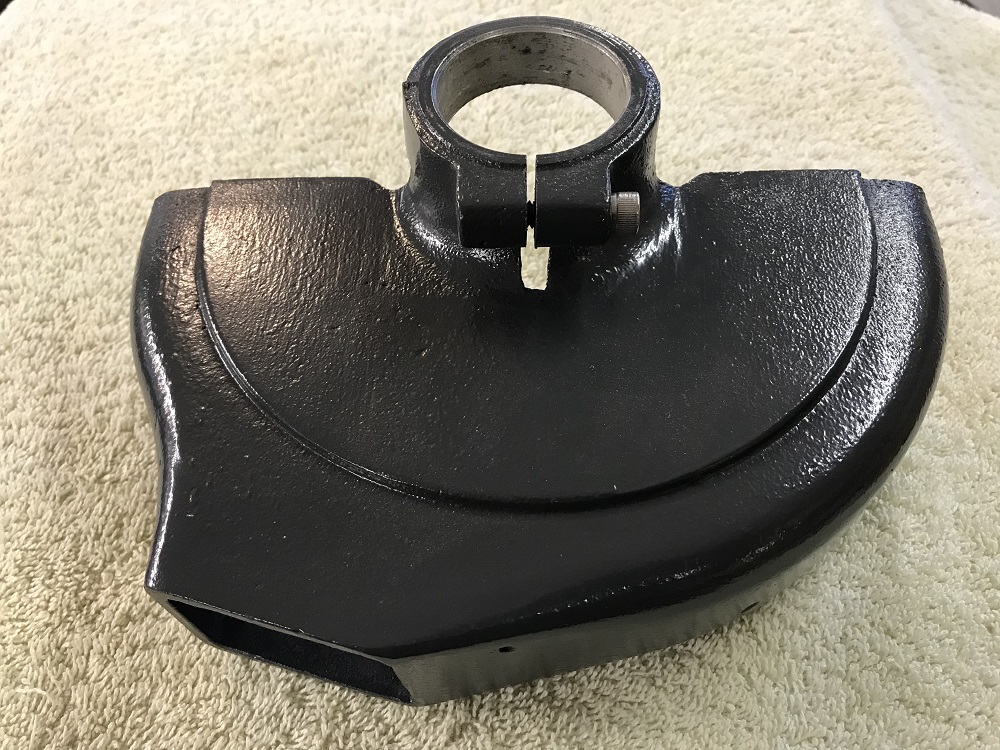

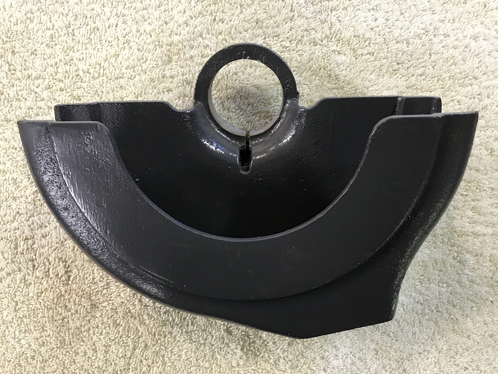

I have done some additional research on the Mark 2. First I bought one on Saturday and like most I have ever seen it is missing the belt cover. The Tailstock part for the extension is also missing but the person I purchased it from thinks he has it somewhere. On to what I have found. The Saw Blade Guard set I posted above will work on the Mark 2. The Lower Guard will require the extension to make it wider since the blade in it's original arbor (P/N 12 431) touches the outside edge of the guard. The 5/8" Universal arbor from the Model 10E & 10ER may work without the extension since the base is slightly shorter. The actual lower blade guard listed in an accessory catalog (2/15/58) has the same part number as the lower guard for the Model 10's. This guard does fit and can work with the Model 10's upper guard. The table has a threaded hole on the back side just like the Model 10's. The Upper Blade Guard (P/N 26 070) listed in the catalog has a different part number than any of the P/N's for the model 10's I have seen. The table of the Mark 2 is 16 3/4" front to back, not counting the fence rail, which is an 1 1/2" shorter than the Mark 5 but is slightly wider than the Mark 5's table. The Tables themselves look to be interchangeable but would have to be kept on their original posts. The Mark 2 has smooth posts, no teeth and locks like the Model 10's table. The Mark 2 is designed as an 8" Table Saw and the insert and extra saw blade cutout are shorter. The Mark 5 at the time was a 9" Table Saw. The Mark 2 can use the Mark 5 or V 500 Miter.

The one or two pictures of the Model 10 lower guard I have ever seen looked like cast iron as I remember. Is the MK 2 lower guard the same? Also, why do you say it will work with the Model 10 upper guard? The upper guard does no interfere with anything under the table.chapmanruss wrote:I have done some additional research on the Mark 2. First I bought one on Saturday and like most I have ever seen it is missing the belt cover. The Tailstock part for the extension is also missing but the person I purchased it from thinks he has it somewhere. On to what I have found. The Saw Blade Guard set I posted above will work on the Mark 2. The Lower Guard will require the extension to make it wider since the blade in it's original arbor (P/N 12 431) touches the outside edge of the guard. The 5/8" Universal arbor from the Model 10E & 10ER may work without the extension since the base is slightly shorter. The actual lower blade guard listed in an accessory catalog (2/15/58) has the same part number as the lower guard for the Model 10's. This guard does fit and can work with the Model 10's upper guard. The table has a threaded hole on the back side just like the Model 10's. The Upper Blade Guard (P/N 26 070) listed in the catalog has a different part number than the any of the P/N's for the model 10's I have seen. The table of the Mark 2 is 16 3/4" front to back, not counting the fence rail, which is an 1 1/2" shorter than the Mark 5 but is slightly wider than the Mark 5's table. The Tables themselves look to be interchangeable but would have to be kept on their original posts. The Mark 2 has smooth posts, no teeth and locks like the Model 10's table. The Mark 2 is designed as an 8" Table Saw and the insert and extra saw blade cutout are shorter. The Mark 5 at the time was a 9" Table Saw. The Mark 2 can use the Mark 5 or V 500 Miter.
More to come later
The Model 10 lower saw guard is the only thing (I think) that I don't have since I got the 4E Jointer motor pulley kit.
I have never seen a MK 2 for sale locally but if I find one with a lower saw guard should I buy it?

John asked
As for using the Model 10 Upper Saw Guard it works because there is a threaded hole just like the Model 10's have on the back edge of the table to attach the splitter to. Using the Lower Guard listed in the 1958 catalog, if it is the same Model 10 Lower Guard, requires an independently mounted upper guard. Again there in no picture or drawing of the upper guard in the catalog. The only guard shown is the set for the Mark 5 which is a 9" guard.
If anyone has a catalog or similar source picture of the Model 10 and/or the Mark 2 Lower Saw Guard it would be nice to see.
John,
As for buying a Mark 2 if you see one for sale with a lower guard it is up to you. I would be tempted to buy it if the price was alright. The one I just bought was $35 but there is another near here for sale for $350, Big difference! As best as I can tell it does not have a lower blade guard, belt guard or the tailstock block that attaches to the extension table. One or two a year come up for sale near me on craigslist and those are all common things I see missing on them.
The Model 10 Lower Guard I have is cast Aluminum I believe. Cast Iron would be heavier for the mass in the guard. Interesting the only reference I have for the Model 10 Lower Blade Guard is the November 19, 1951 Part Number conversion table. There are no pictures or part drawings on that table. I have not seen it listed in a catalog until the February 15, 1958 accessory catalog for the Mark 5 and Mark 2. It does not have a picture or drawing of it there either. Below is the Model 10 Lower Blade Guard I have which would be part number 162-1X or 12 370. I painted it but it was gray when I received it.The one or two pictures of the Model 10 lower guard I have ever seen looked like cast iron as I remember. Is the MK 2 lower guard the same? Also, why do you say it will work with the Model 10 upper guard? The upper guard does no interfere with anything under the table.![]()
