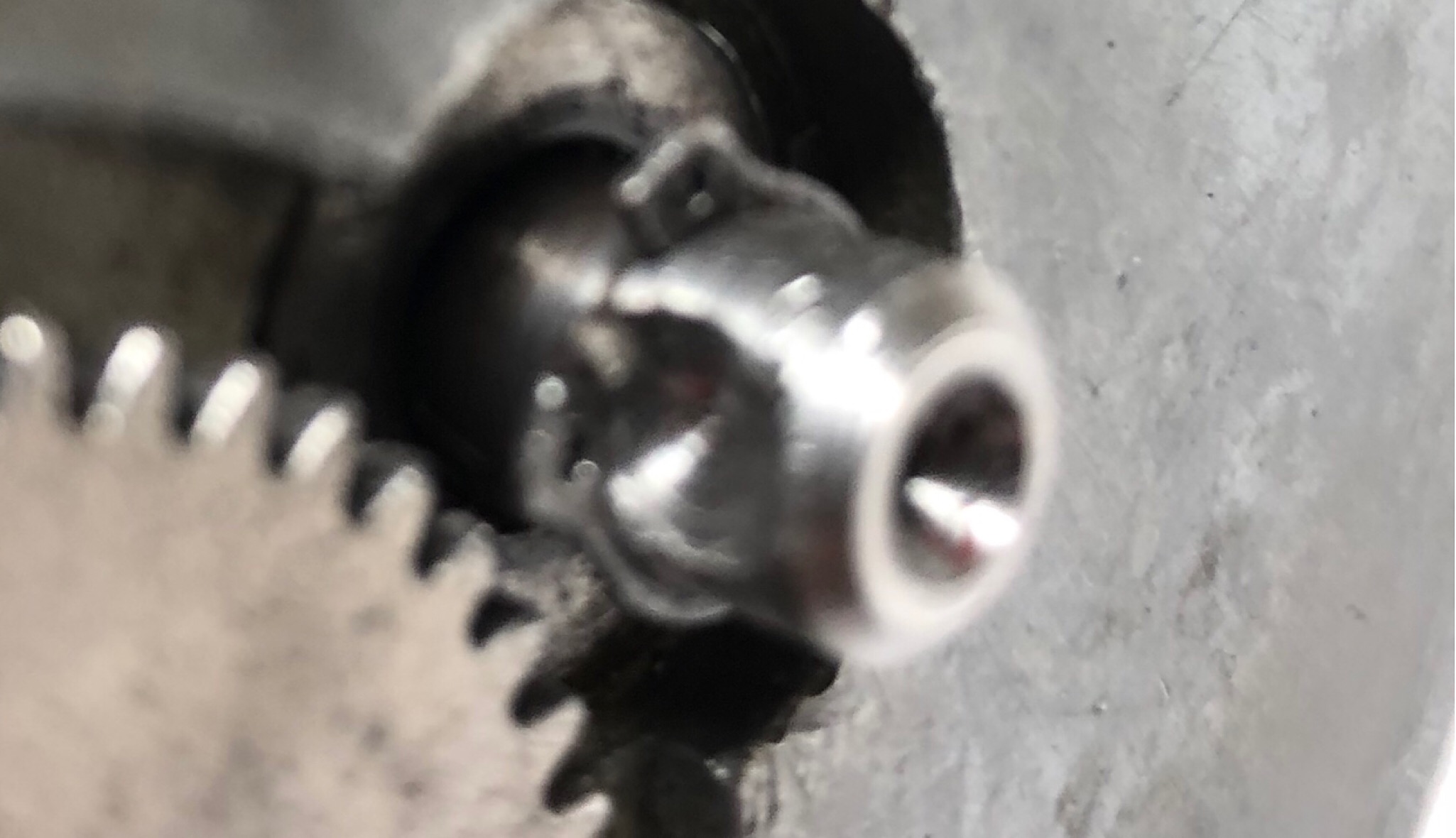

I followed JPG’s directions. In the process I found a small thing. The snap or retaining ring holding the worm shaft in the bushing was slipping out of its groove allowing the worm shaft to slide into the speed controller causing some kind of issue.
I should have replaced it when I put in the new worm shaft. (It’s a 5/16 external.) So I installed a new one. FWIW on adjusting the high speed set screw it is slightly short of the surface of the lock nut.

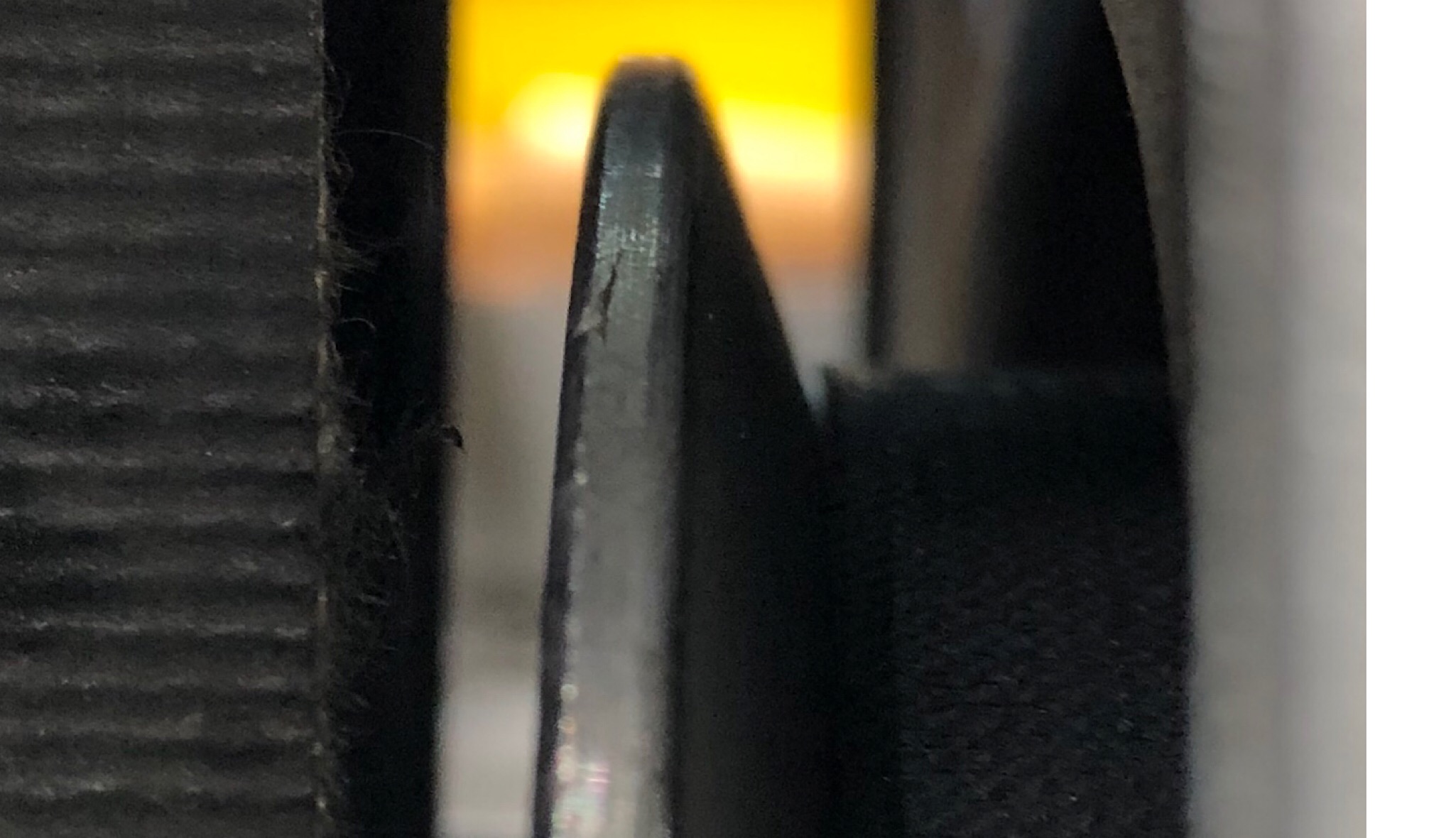

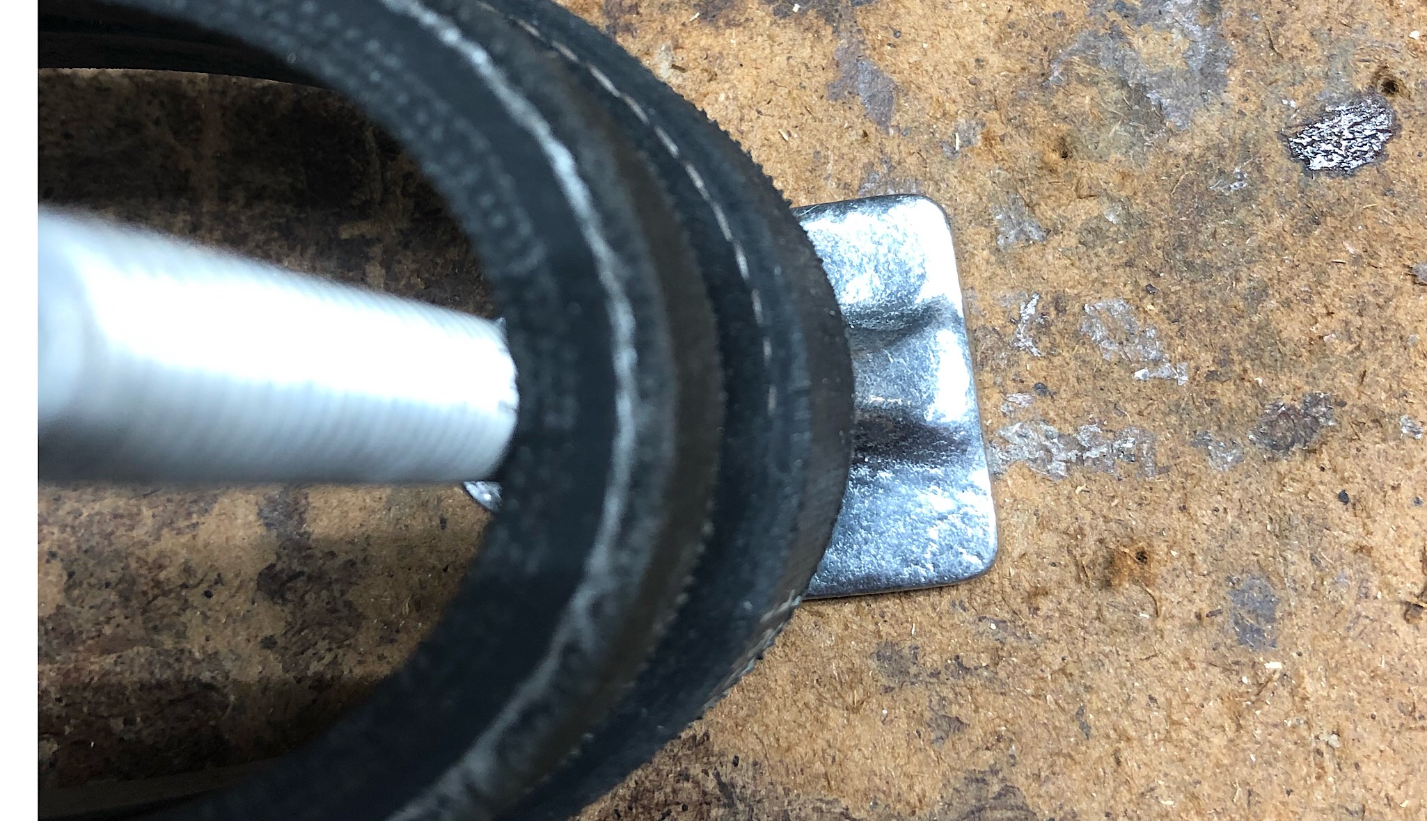

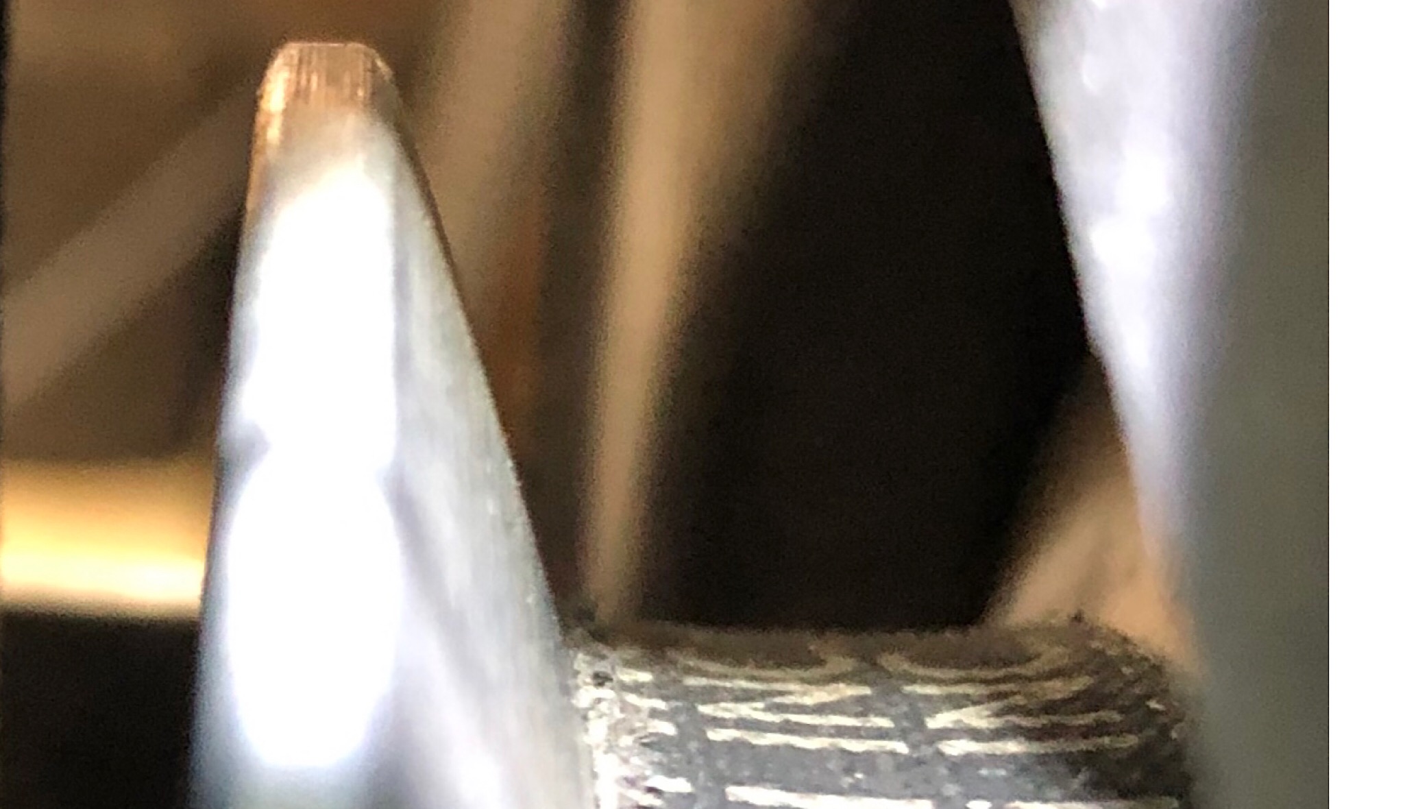

I replaced the new belt (15x675) with my original SS belt (504193). I measured the two and my original belt is about 1/2” shorter than the new belt. That difference is relative, not exact. This pic is of one end. The other end is the same.
I manually ran through the speeds and it bound up at “C”. Then I ran it under power. Same thing. That’s progress. But it still bound up. The speeds also increased since the test with the new belt.
“C” is now 1580 rpm (previously “D” was 1660)
“I” is 2310 (was 2170)
“M” is 3230 ( was 2880)
I’m afraid to run it at Fast for fear it would tear apart due to very high rpm.

Well the belt lengths explain some of what we have observed.
We are left with the premature stoppage before reaching 'slow'.
I think a pix of each pulley when that premature stop is reached may help reveal the cause. The height of the belt in the pulleys as well as the amount of motion left for the floating sheave to open(spring fully? compressed) and the porkchop position.

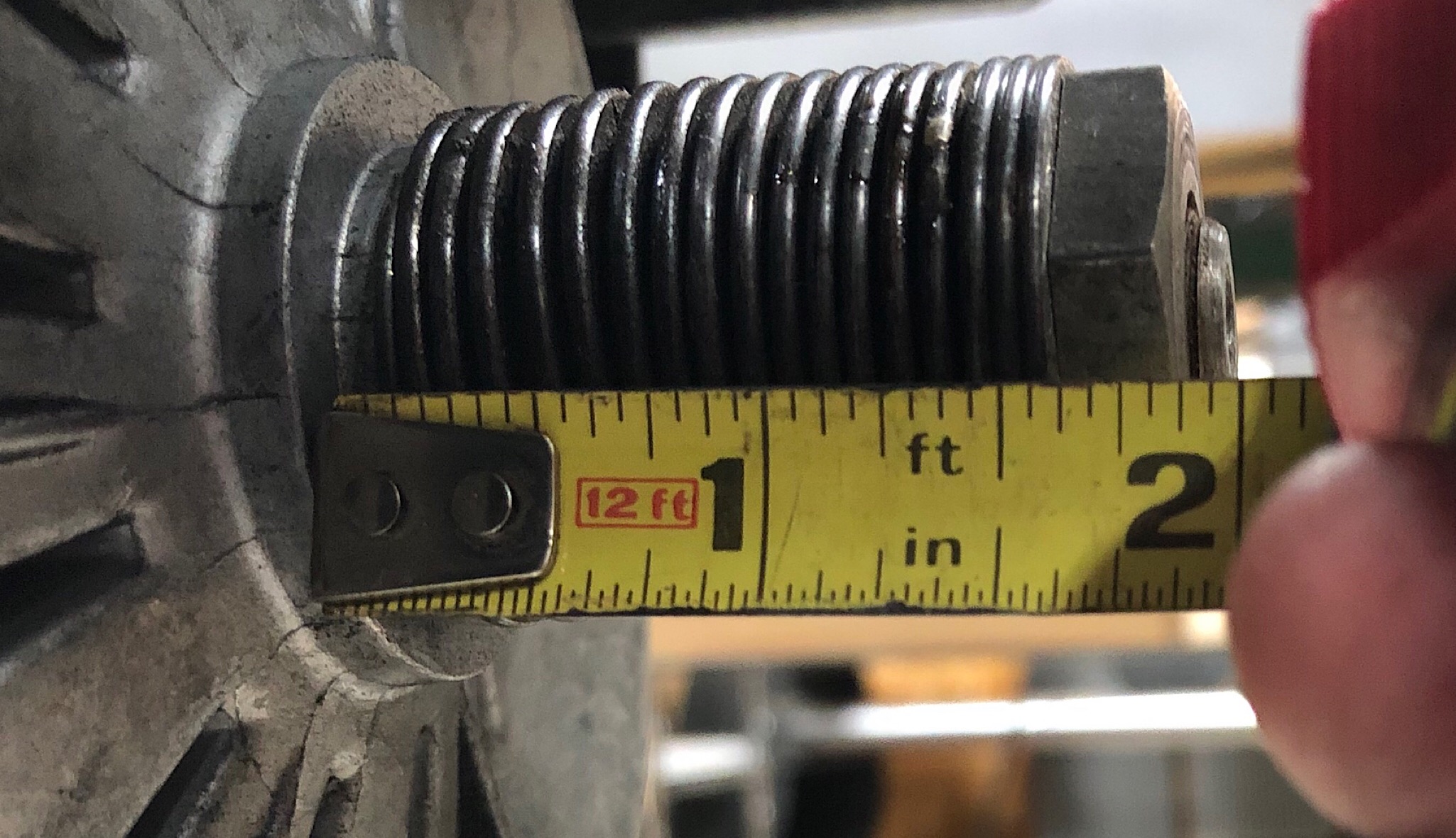

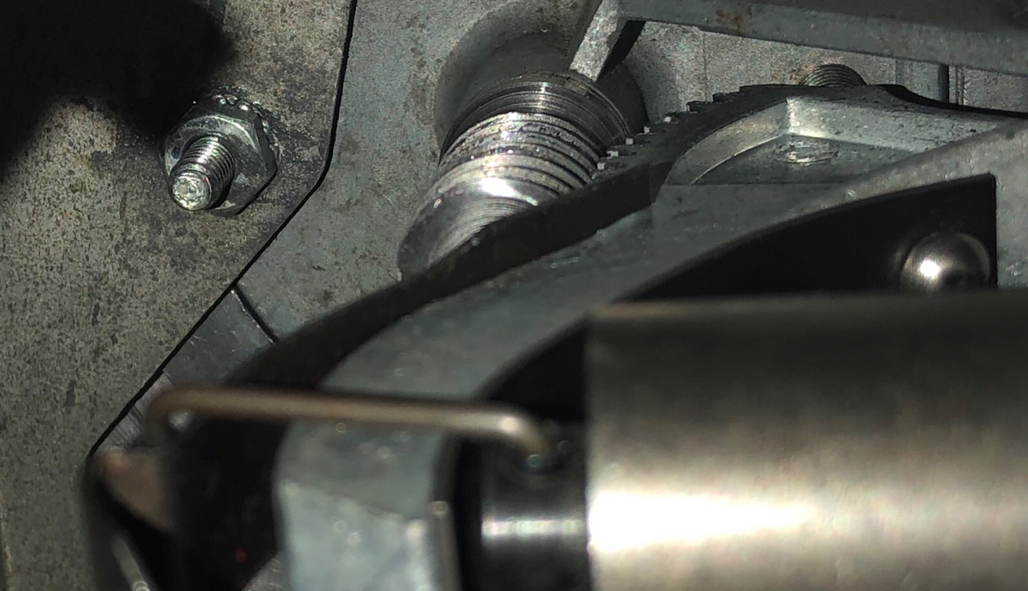

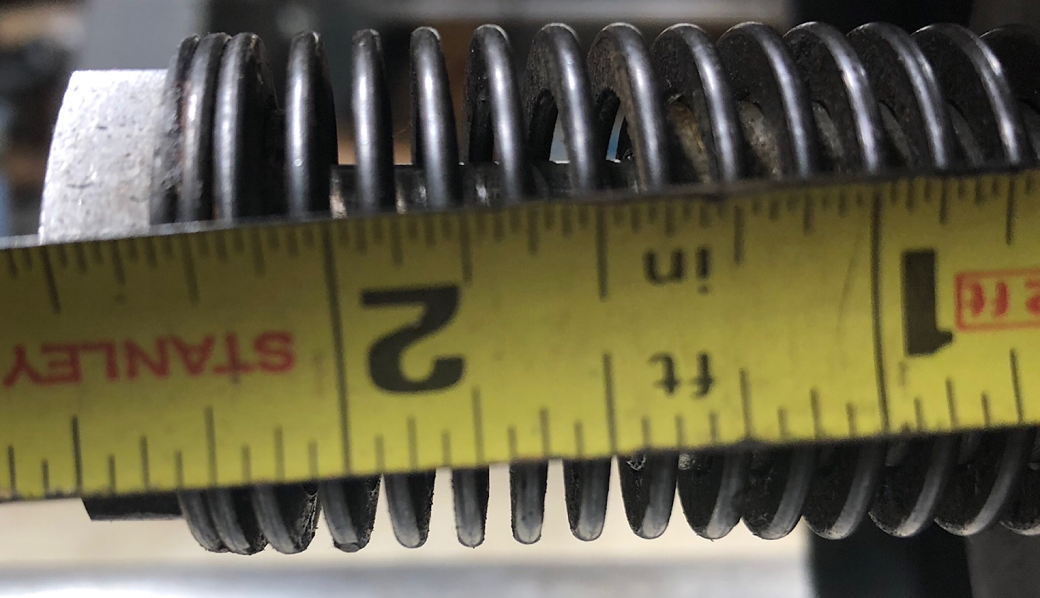

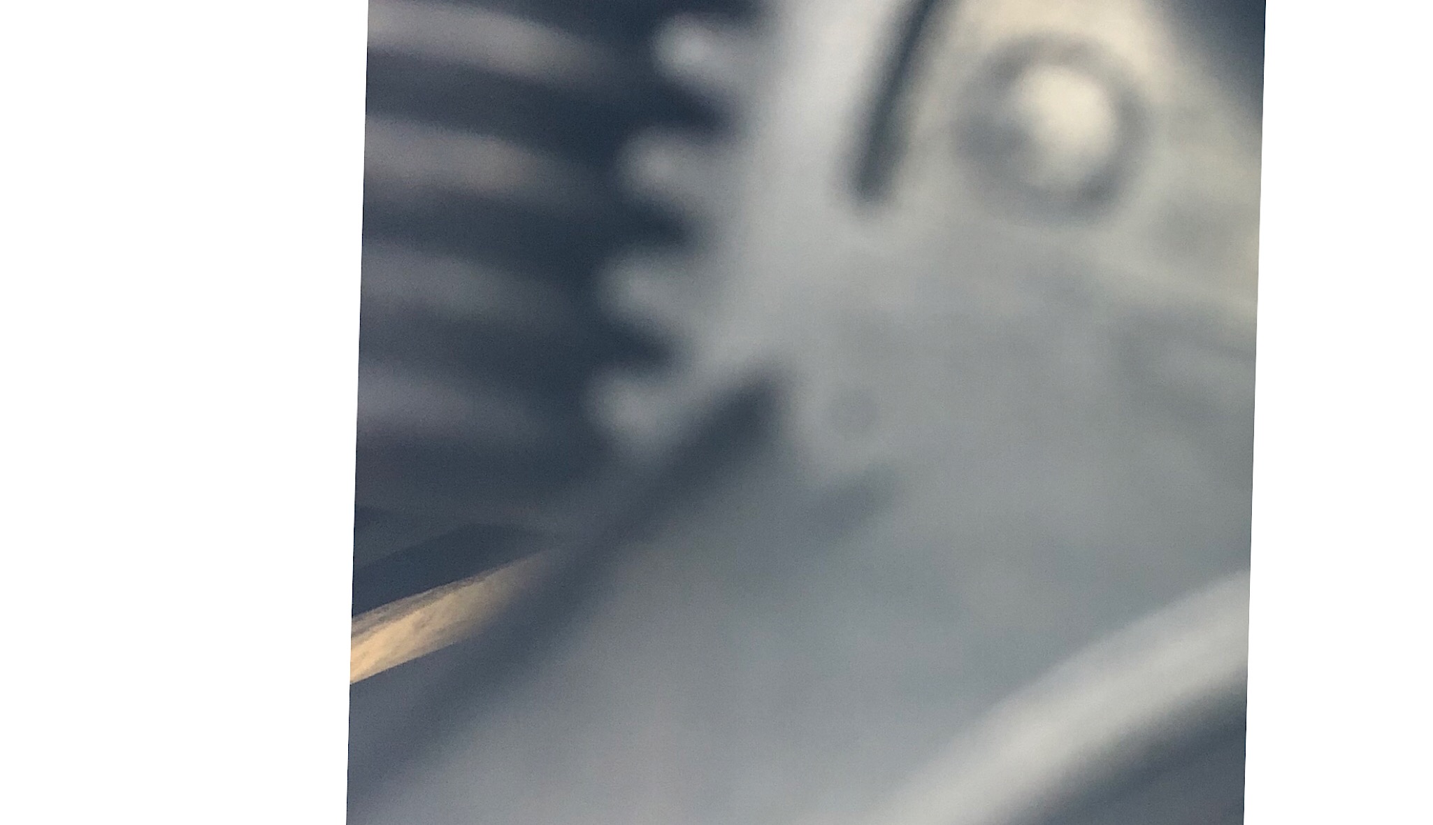

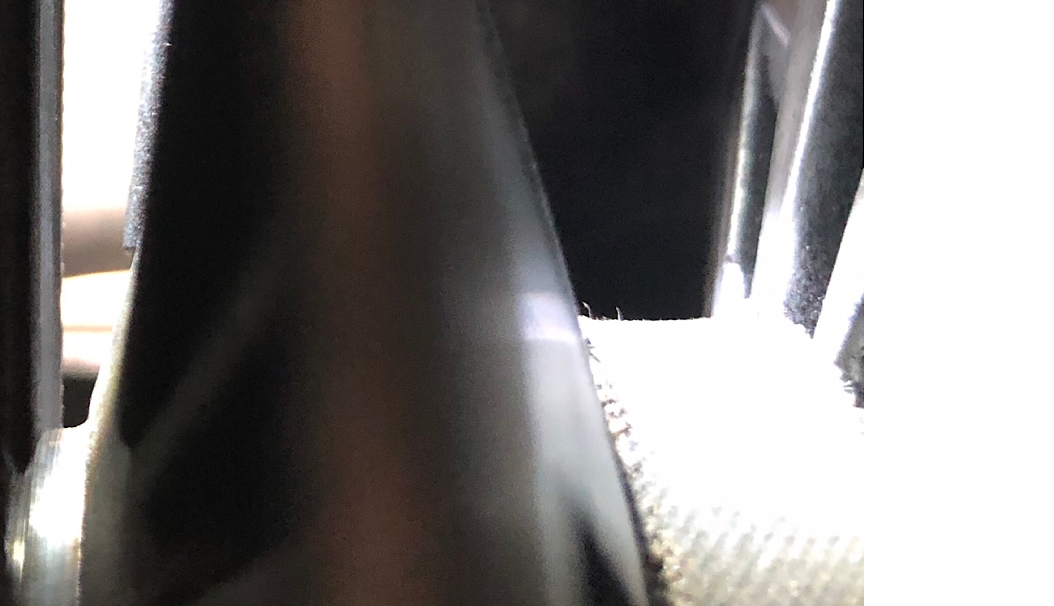

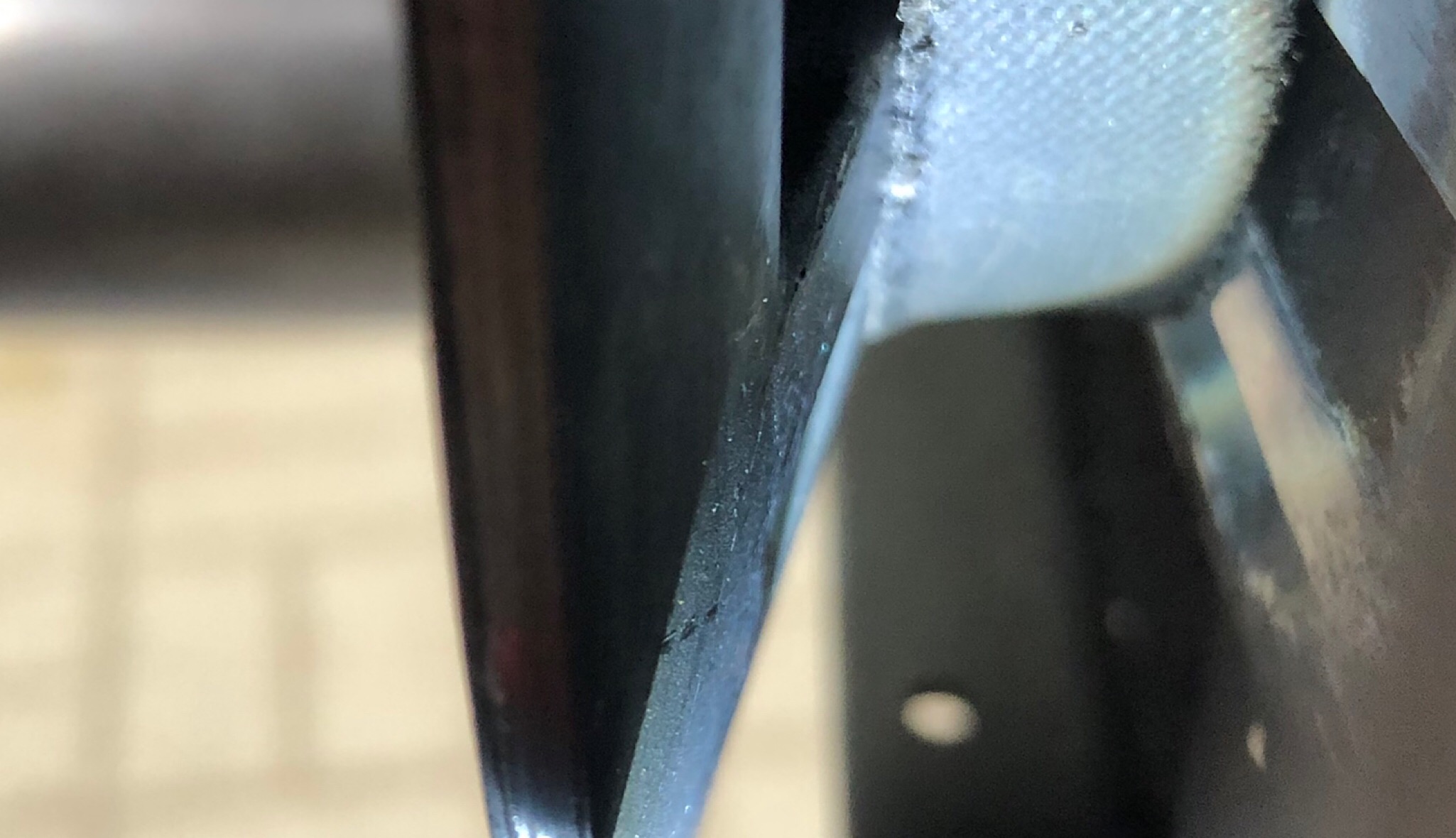

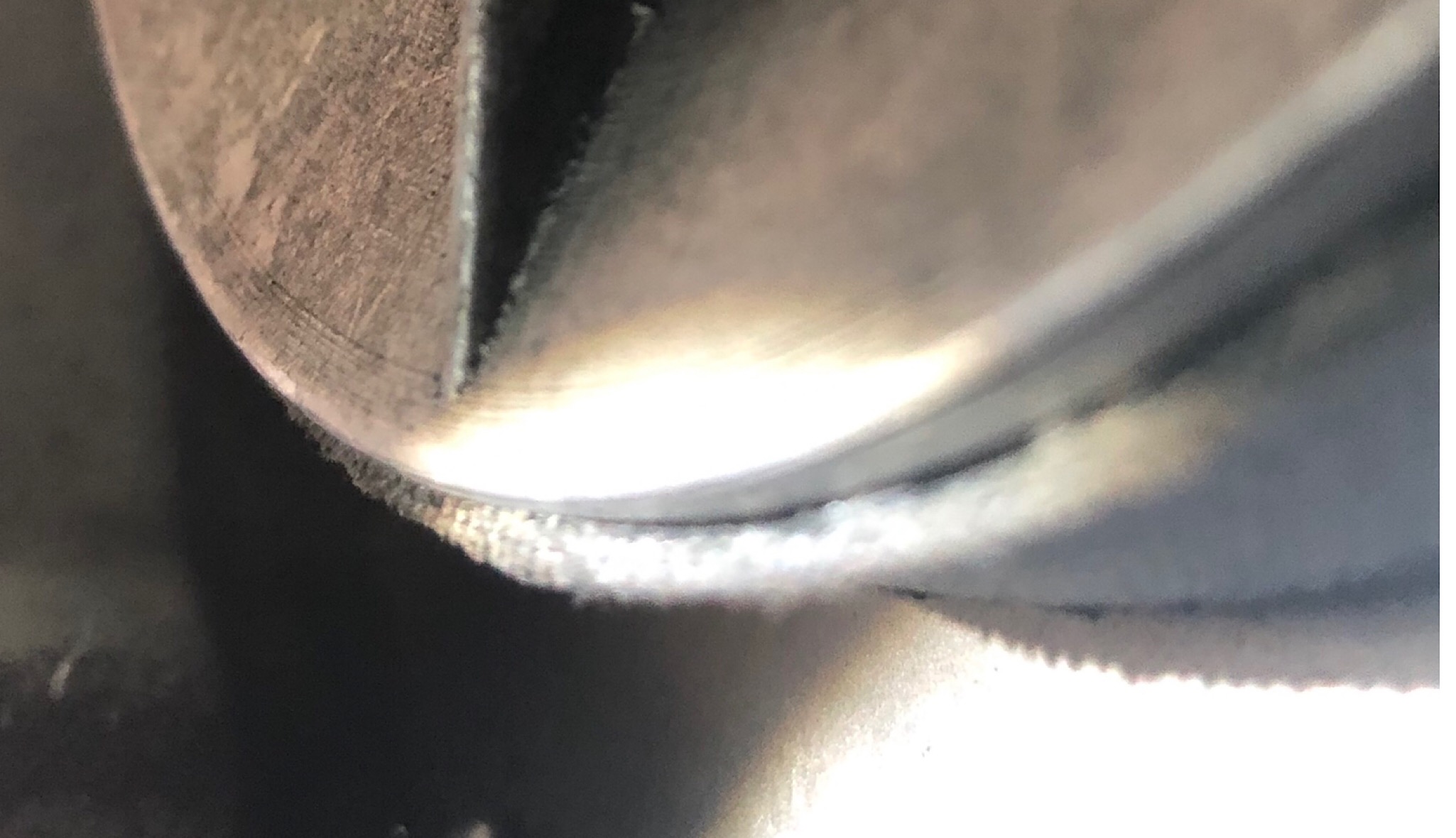

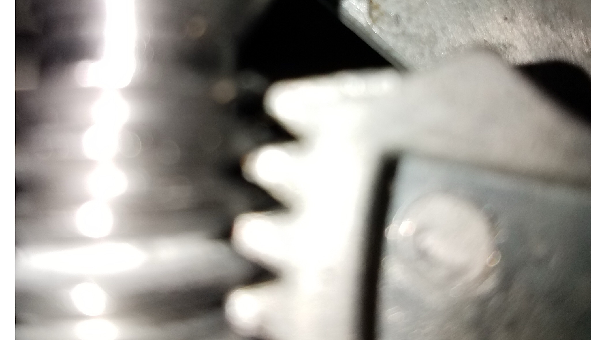

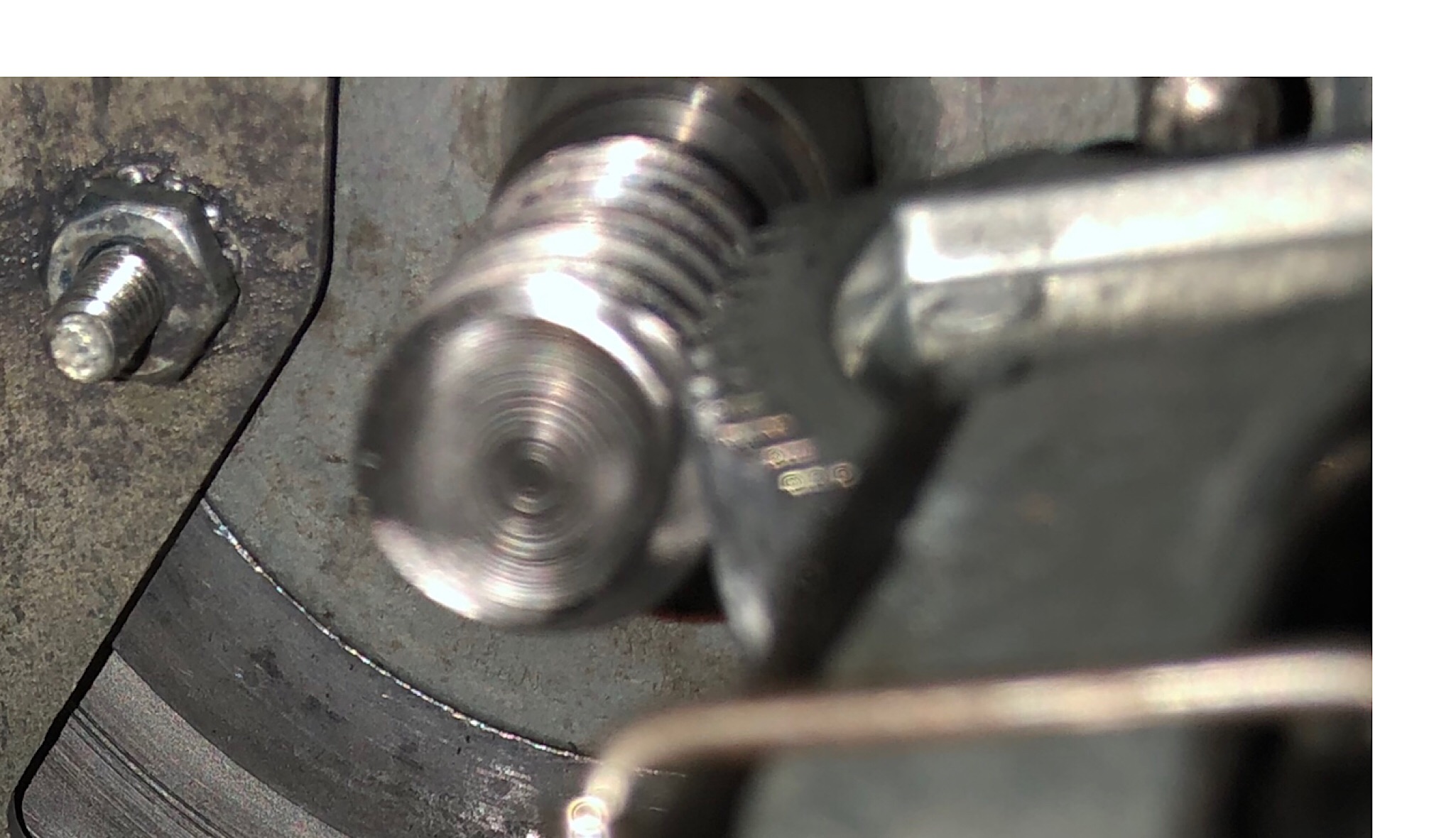

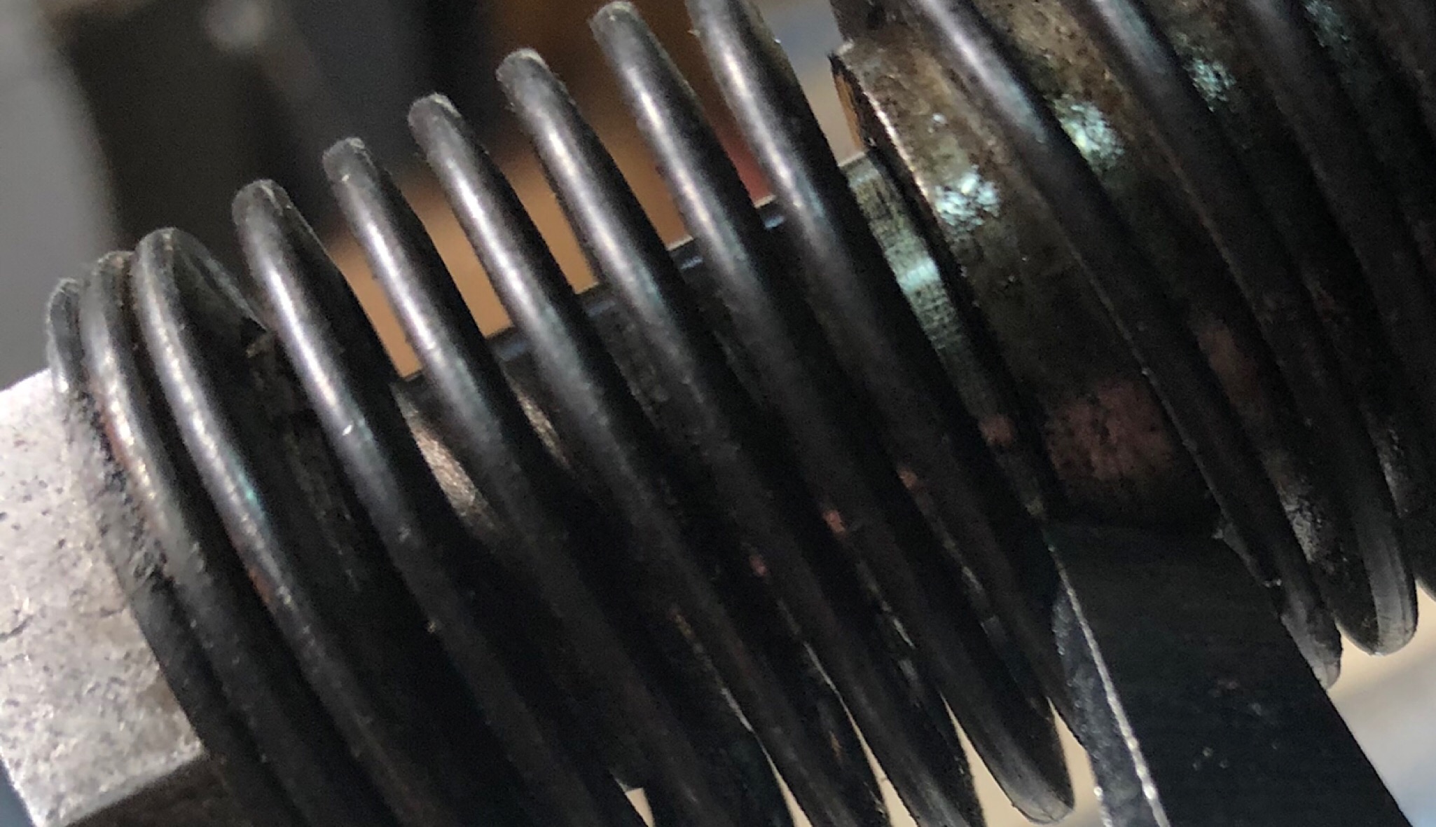

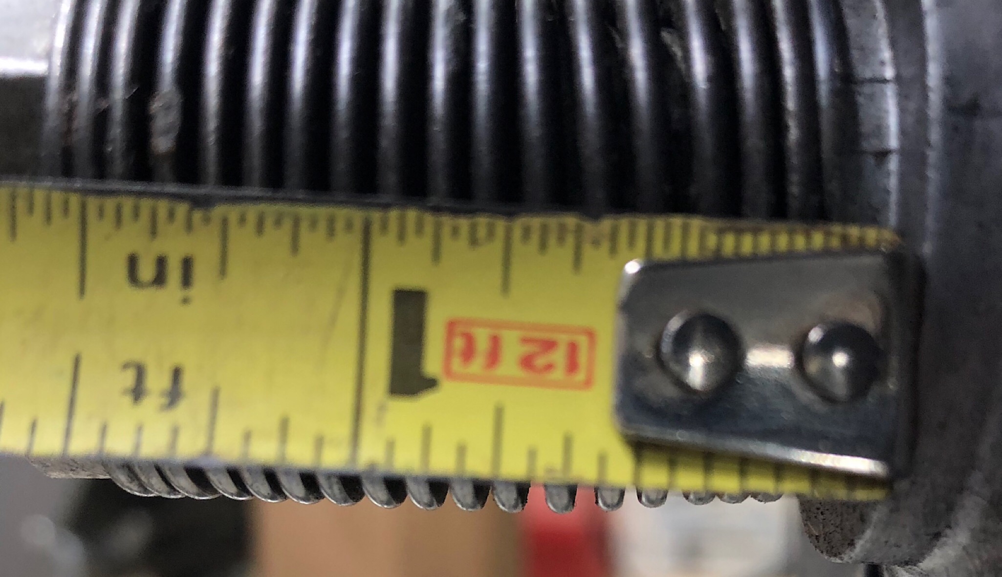

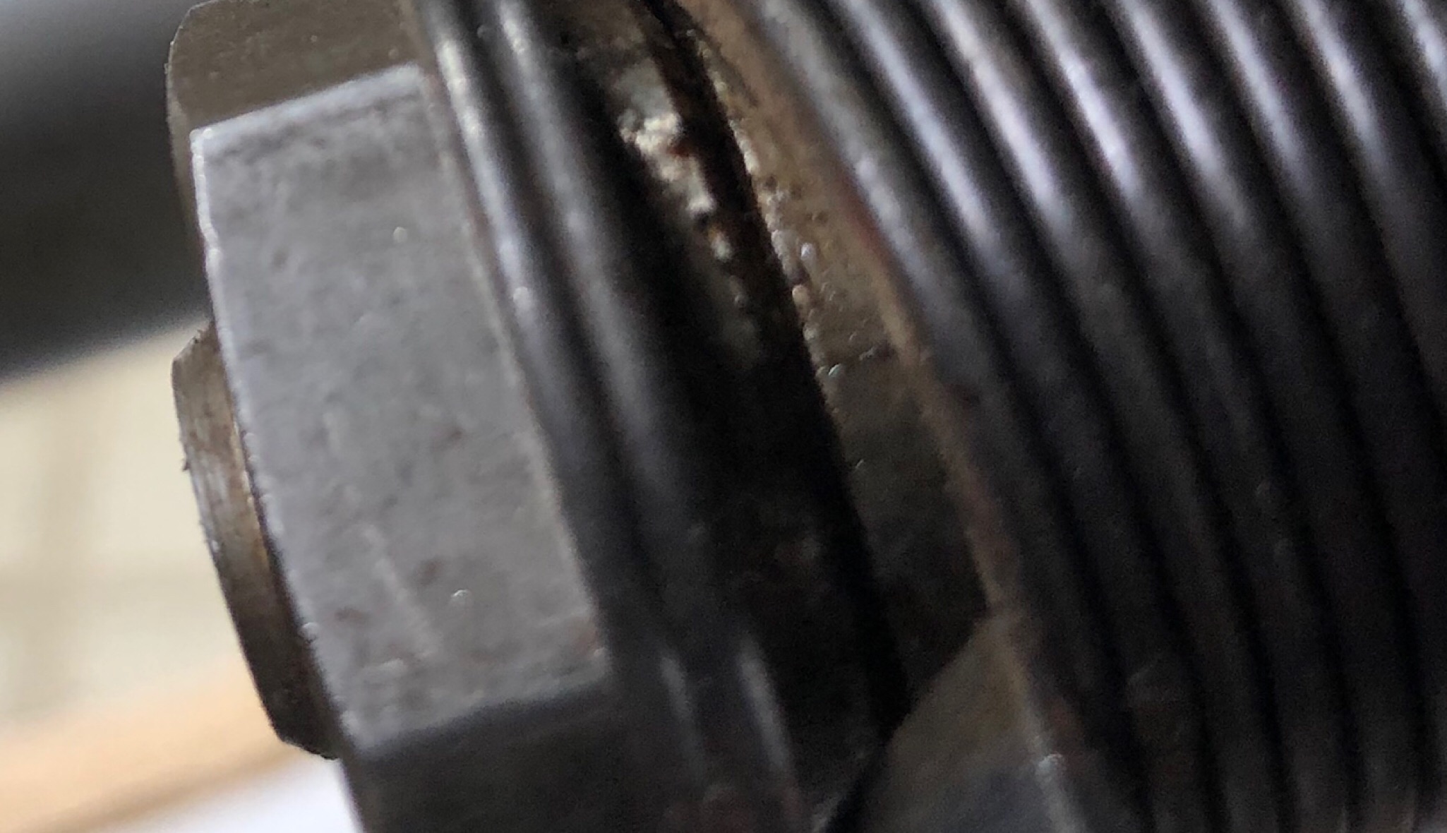

These pics show the machine’s state when it binds at “C”.
These are the upper sheaves.
These are the lower sheaves.
This is the spring.
This shows the spring separated reveling the stub on the sheave grounded on the nut.
This shows the speed controller as seen from the inspection hole.
This blurry pic shows the relationship between the quadrant and the worm shaft.
Re: Request Help with Speed Control Issues
Hoookey! Glad for the pix. Two meaningful clues. Floating sheave moving all the way to the nut is the cause of stoppage. However the belt position on the control sheave is not what it should be. The belt should be tracking much further out in the pulley.
I cannot see if the quadrant gear is near the end of it's normal slow range.
Regardless the control sheave is NOT as far toward the idler sheave as it should be at 'slow'.(idler pulley not closed enough)
Just for added info, take the same set of pix with it set to fast. I am suspicious of the high speed stop setting. Especially needed is the belt tracking on the motor pulley at fast.
P.S. I just reviewed some earlier posts. Notable was the loose retaining ring on the worm gear shaft. The issue it could cause is to make the high speed stop setting wrong and/or cause the worm gear to move in/out thus reducing the range of quadrant gear movement.

These pics show the machine’s state at “Fast”. A note, I did replace the retaining ring on the worm gear so it’s no longer sliding back and forth.
This is the spring.
This shows the spring separated reveling the stub on the sheave at some distance from the nut.
